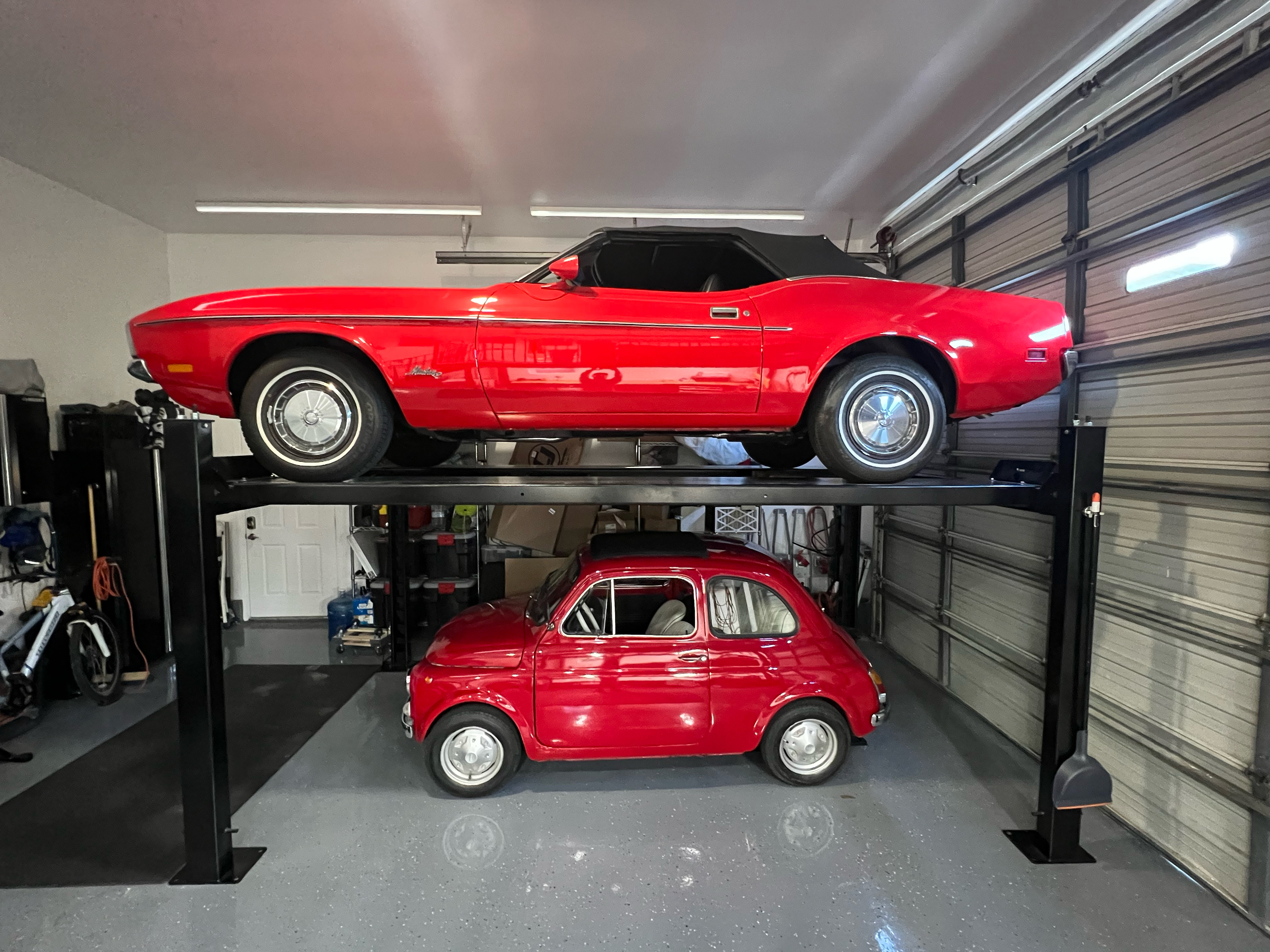

Pics of Francesca!
Small world! I actually just picked up a 1974 Fiat 500 from Reno a few months ago and brought it to Southern California. After a few months of enjoying the car in its original trim, I have started to tear into it.
There are not a lot of part options for these in the US that I have found, but I have had pretty good luck with Mr. Fiat out of Florida. They offer rebuilt engines that might be easier than finding a shop to rebuild yours.
Pics of Francesca! View attachment 414499View attachment 414500View attachment 414501

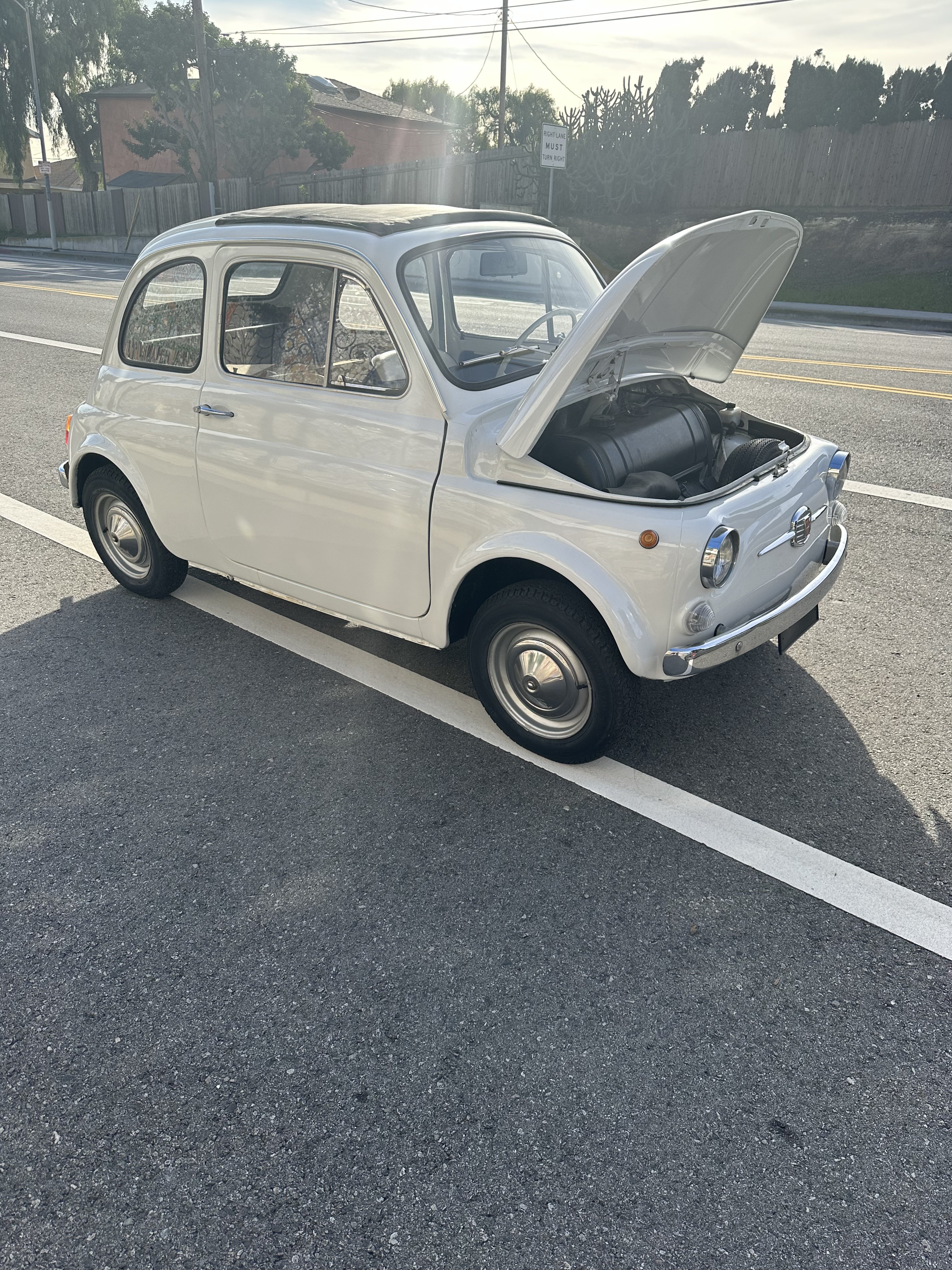

Car came today. The engine definitely needs some work. But she’s awesome.
