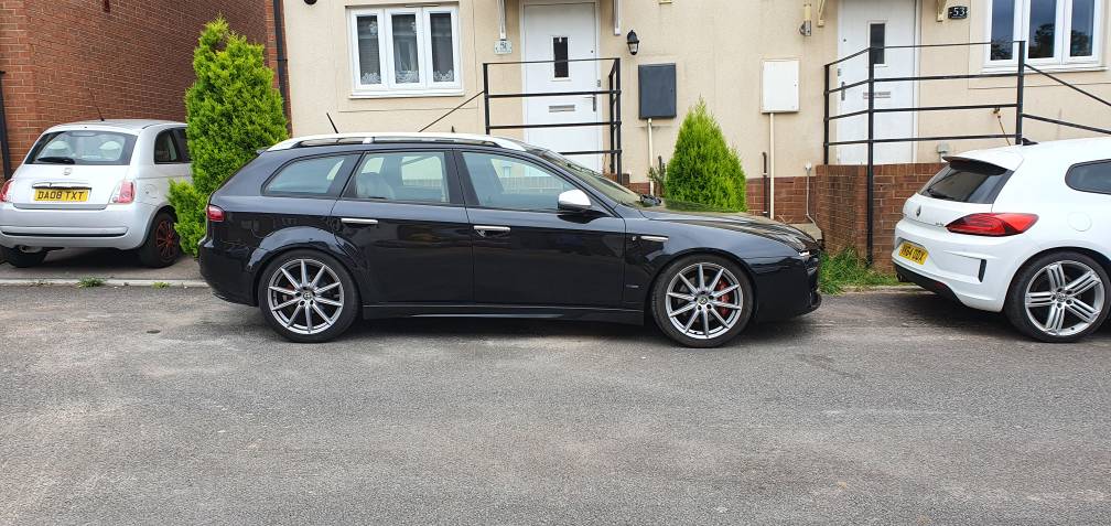

thats a really good colour combo, very classic looking like that, certainly better than the factory silver on the wheels!!

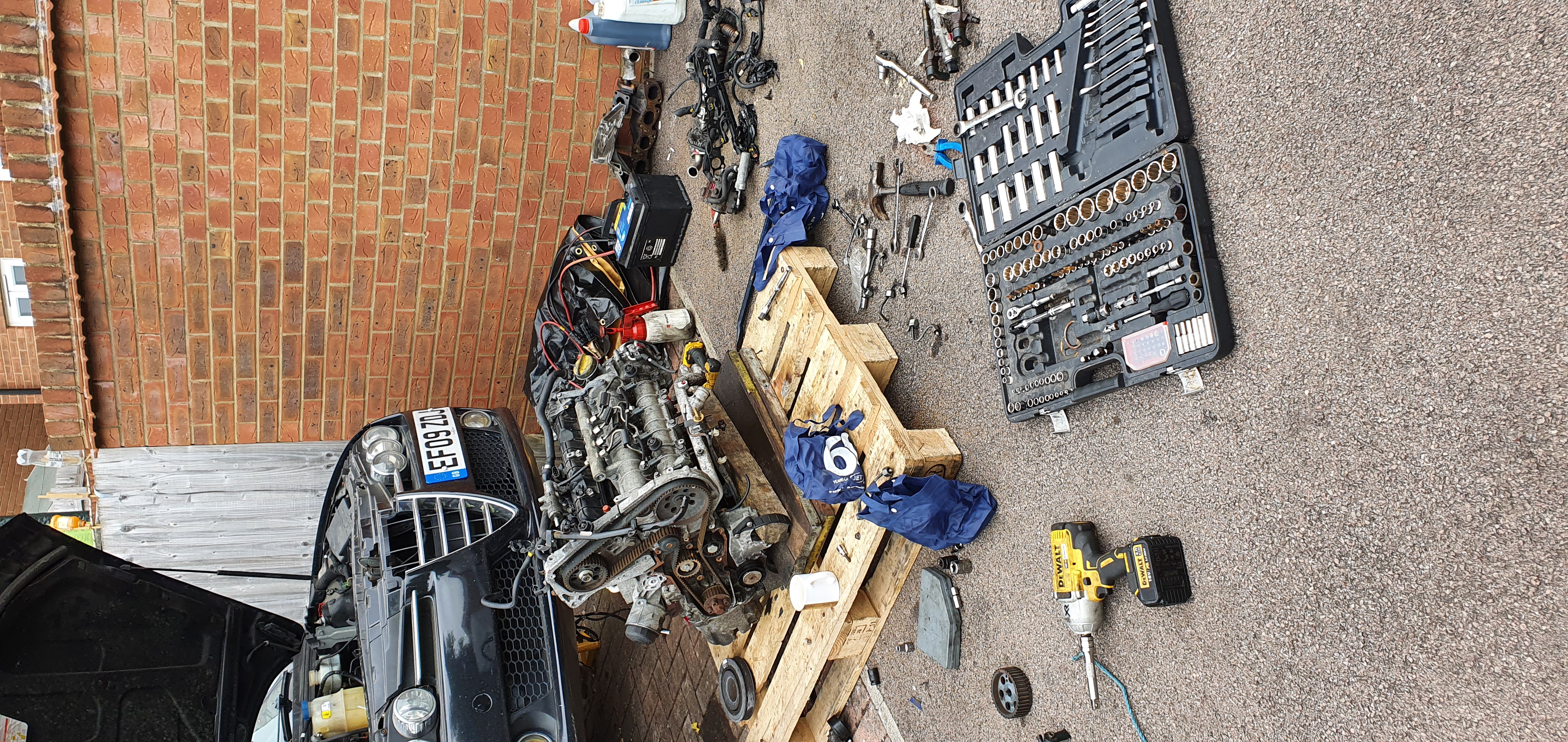

not been taking many pics but here is a few

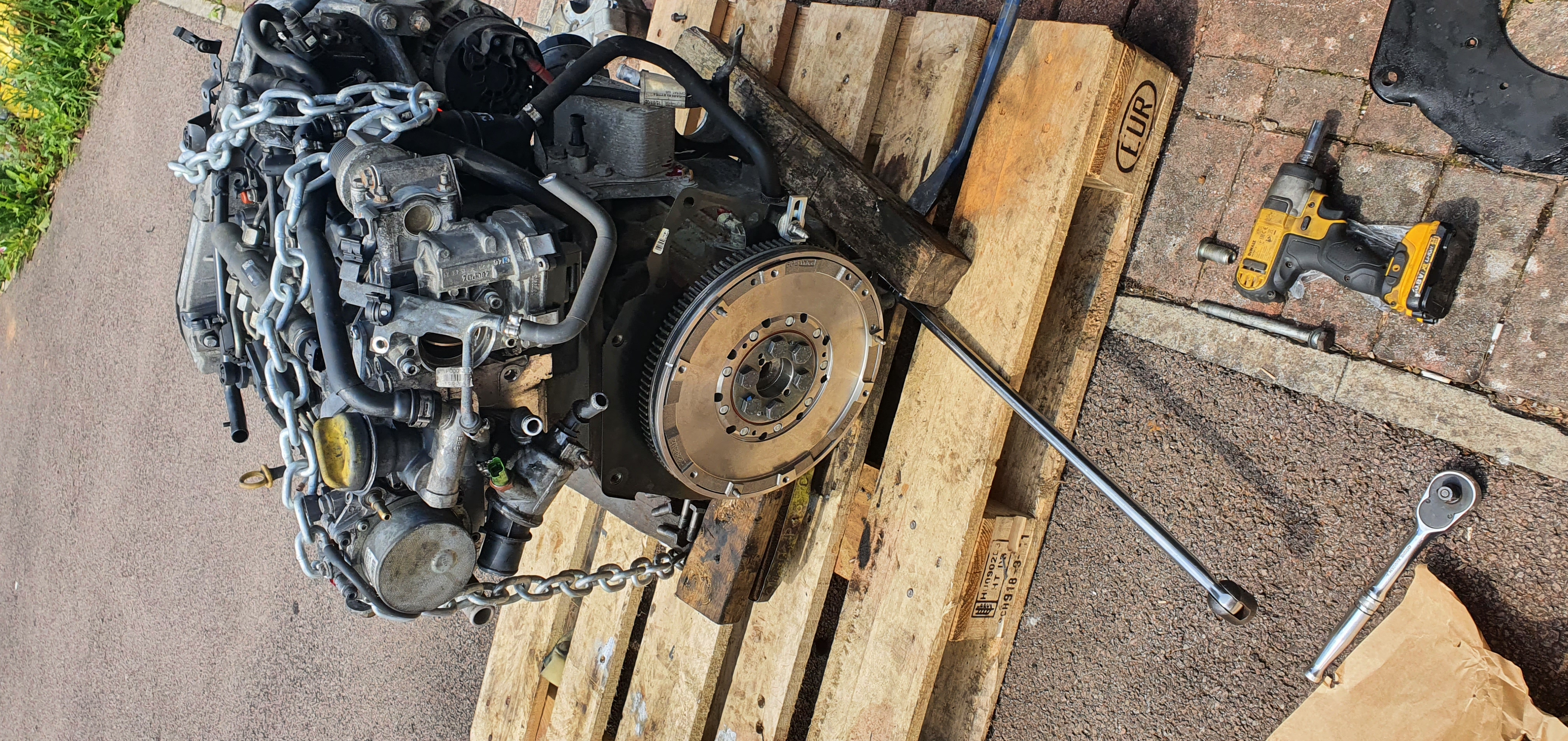

engine in front of car having new bits attached to it
new timing belt, pump etc fitted

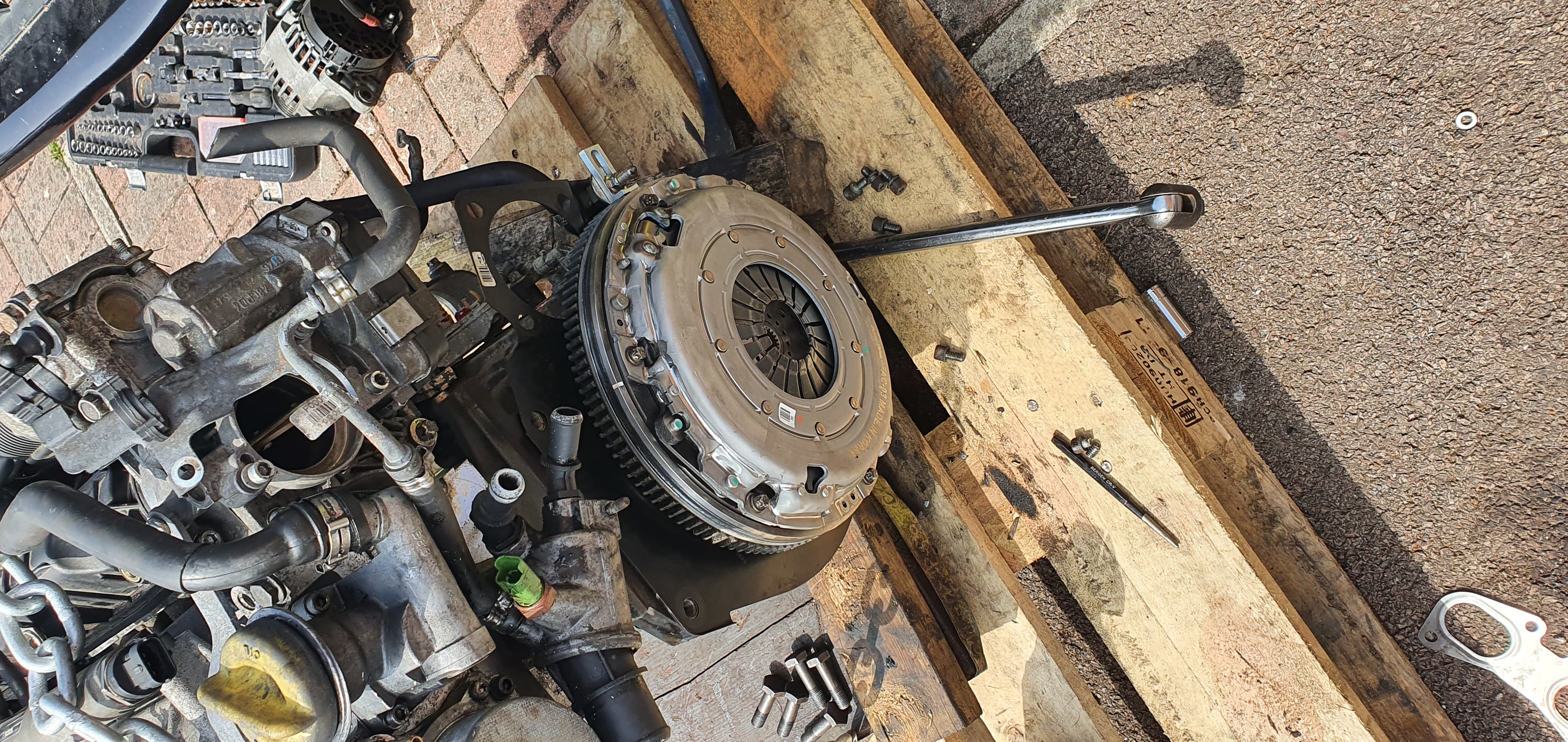

new dual mass flywheel fitted
and the clutch on
it was a tight squeeze getting it under the car
and hanging on its mounts

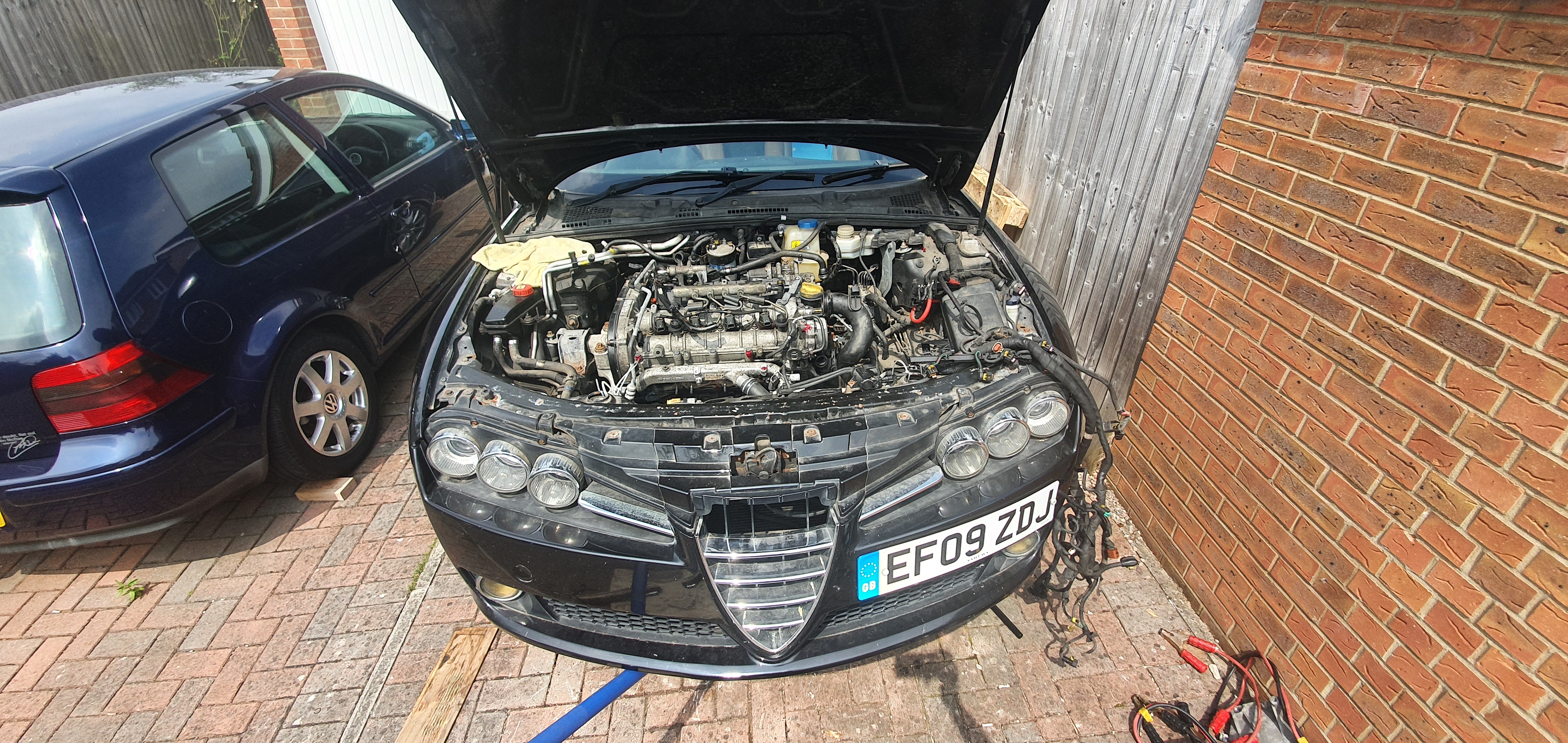

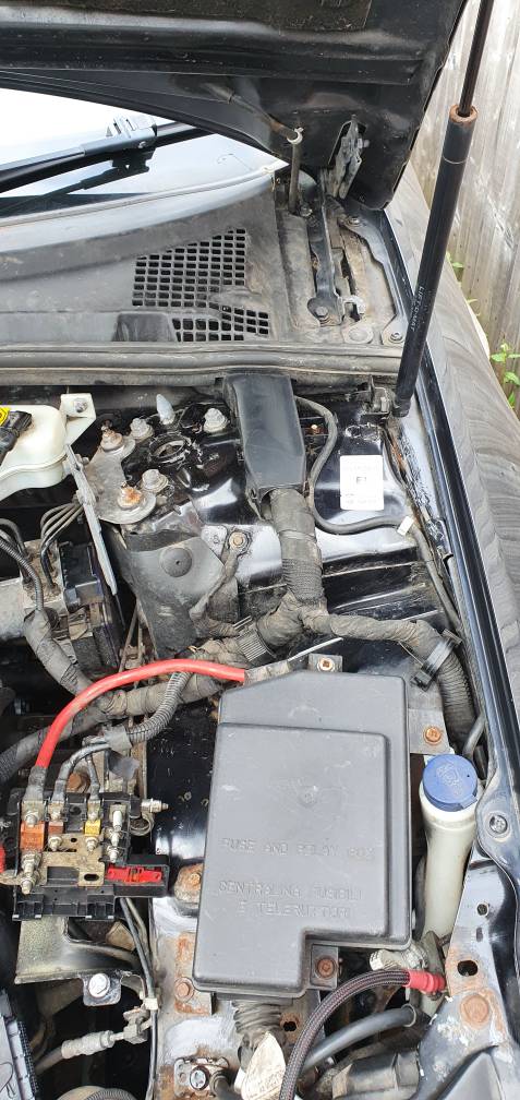

oh, I did give the bay a quick clean up as it was utterly disgusting, far from a detail or anything but it looks much nicer.
That's how minging it was
And now it's all more like that.

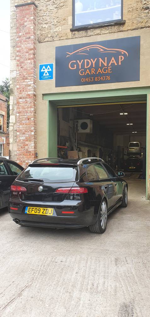

I've given it a little test drive around my estate and all seems to be well. So today I've spoken to my MOT man who said he could do it 2moro. So today has been spent making it look respectable, I know I don't have to clean cars for the MOT but I always do lol.
