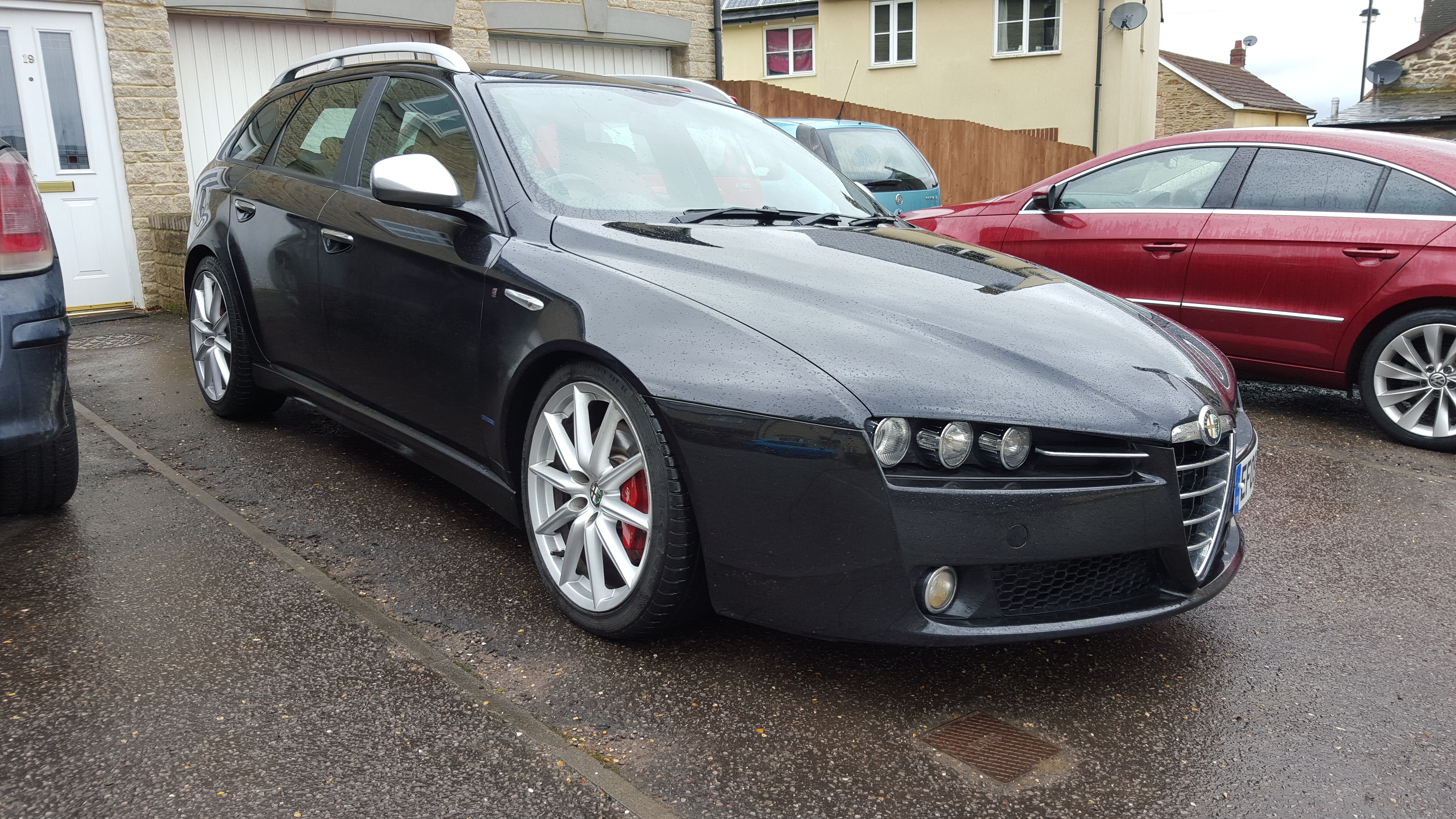

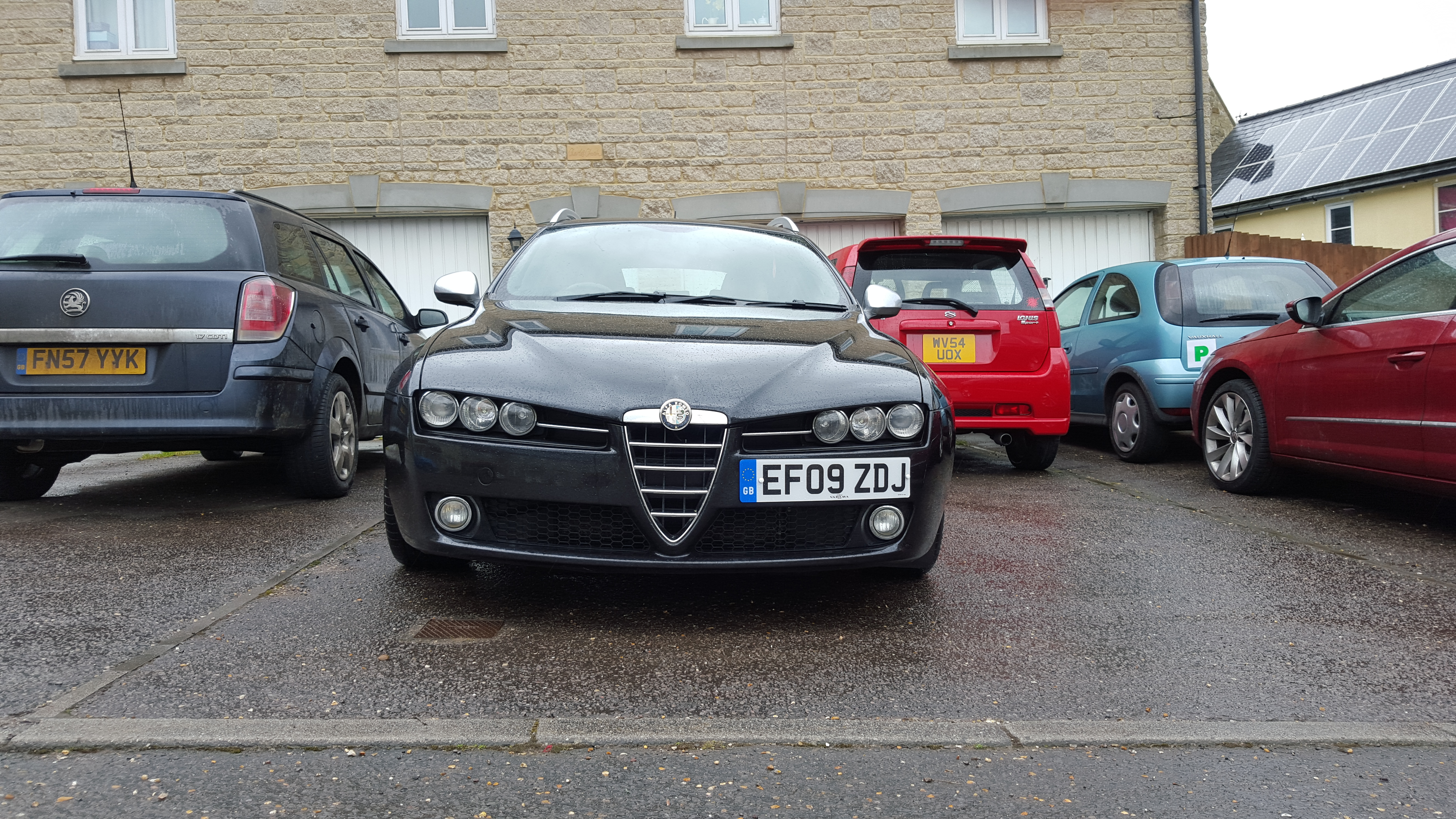

So picked this up this morning, quite happy today :)
Just before i drove it off the forecourt.
Next to my dads car (one of my old cars lol) who kindly took me to get it
I have decided to call it Urchin in memory of Richard Brown, not sure it suits the car but it feels right.

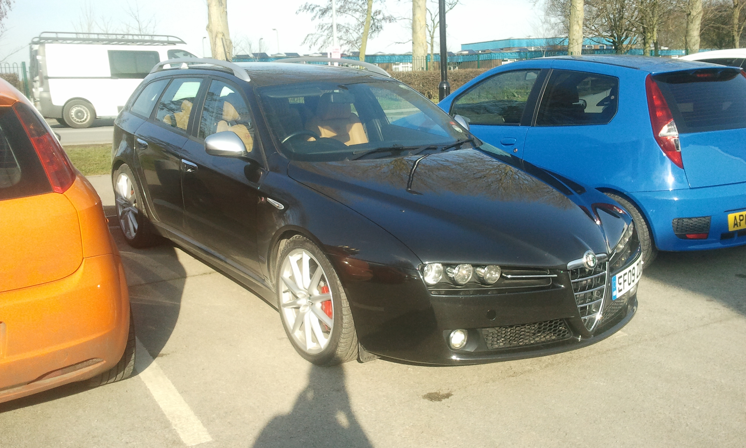

well its been a while.... This car is still around.

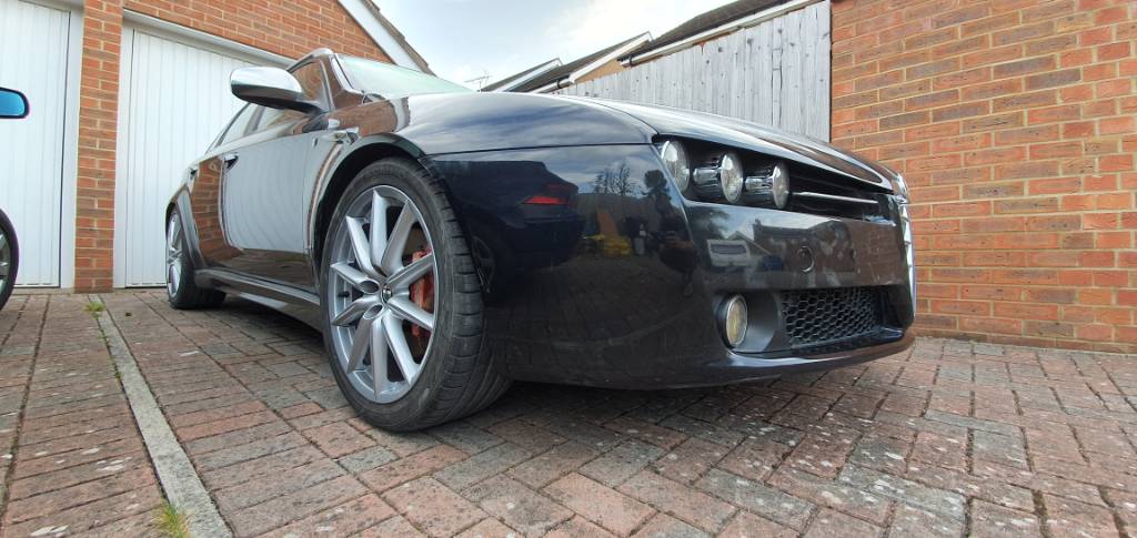

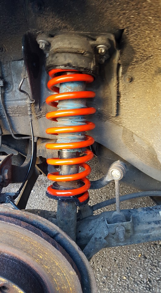

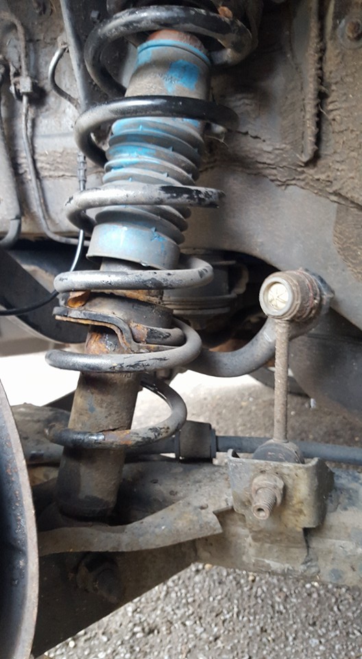

All the springs are on and this is how she now sits - they are cobra springs, used them on a few cars and always been impressed by quality and ride of them so went for them. They are ever so slightly lower than stock TI springs, which is more noticeable on the front than the rear. The ride is still very good, you can hardly feel any difference at all in ride comfort unless going really slowly, like manoeuvring speeds - say going over a speed bump in a car park, then it feel a tiny bit more 'jiggly' than stock but out on the road its basically the same.
New tyres and alignment 2moro, my wallet aches!

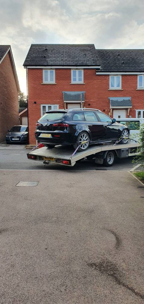

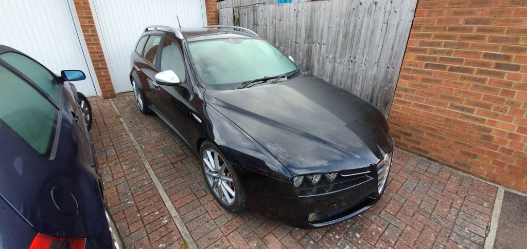

Well well... It's been 4 and half years since she left, but like a homing pigeon, she returns!
Not seen the car in eons but it appears my uncle took very good care of it generally speaking. Interior is all still nice, he's even had the roof bars and mirror caps painted, they were starting to look rough when she left in 2016.
But.. it's a non-runner. Don't know exactly what's up with it but it's arrived with no injectors fitted and apparently had low or no compression in one cylinder.
So right now the battery is off and on charge, only had 3.4v in it but is apparently quite new so fingers crossed it takes a charge and we'll go from there I suppose.

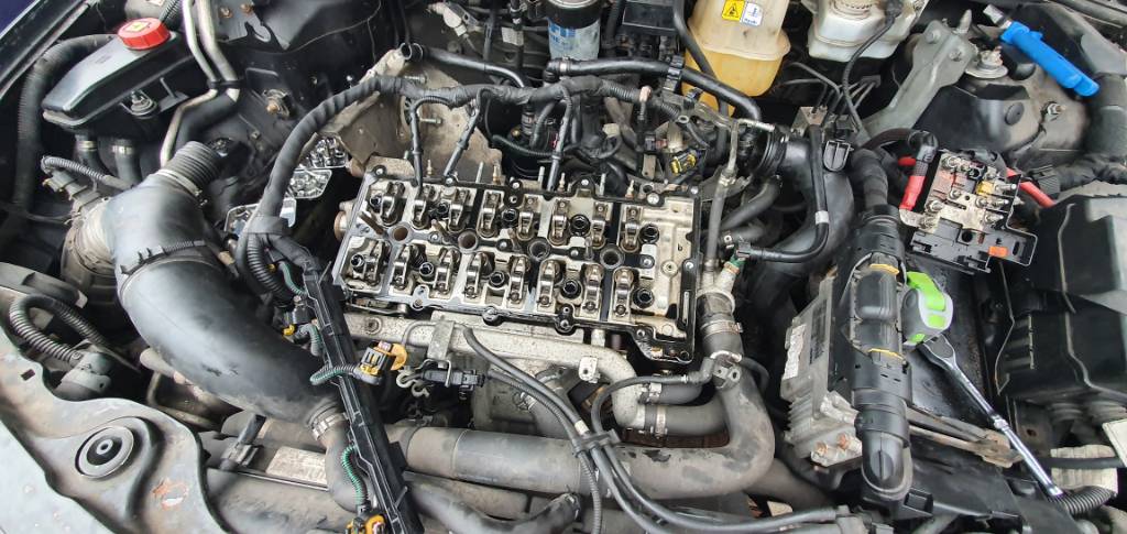

Well had a chat with my uncle as to what happened. Sounded very much like it could have eaten a swirl flap.
So I set about stripping stuff off in order to get the inlet manifold off and....
https://youtu.be/iOnx5CJoAp8
So it's definitely eaten some swirl flaps. So I kept going to see how bad the damage. So cambox off first, that looked okay and also no visible damage to any of the rockers etc
Next the head and well it's a mess in there. Cylinder 1 looks okay but full of some gritty stuff no sure why or how. cylinder 2 looks like it's eaten part of the flap or at least something has been in there. Cylinder 3 and 4 where flaps were completely missing are indeed mullered.
I'd say the bottom end is salvageable and the heads scrap but probably makes more sense to just buy a replacement bare engine at this point.

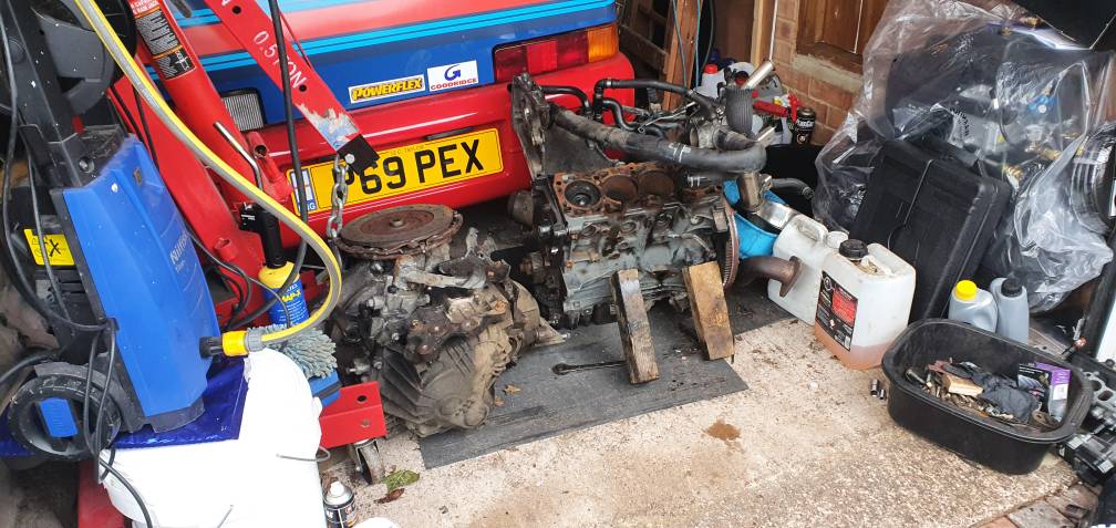

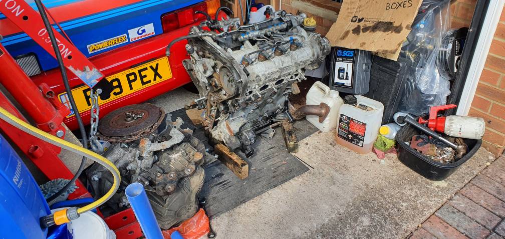

engines out, split from box and stuffed in garage.
replacement ordered along with a new clutch kit and DMF. the DMF looks to be fine but it has over 100k on it and I found one for a very good price.
There is also already a big box of service parts for said engine waiting already

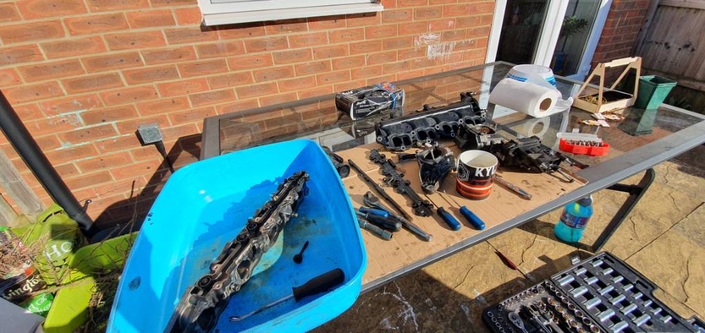

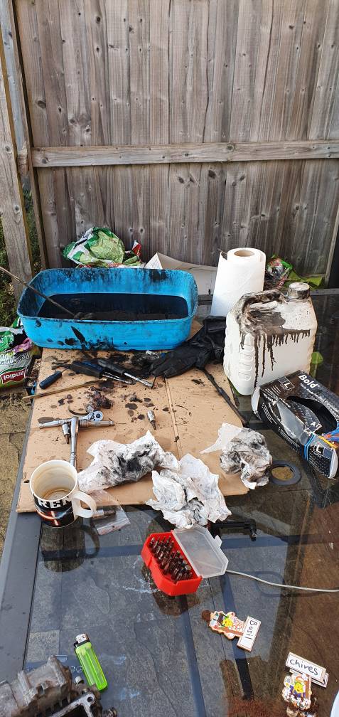

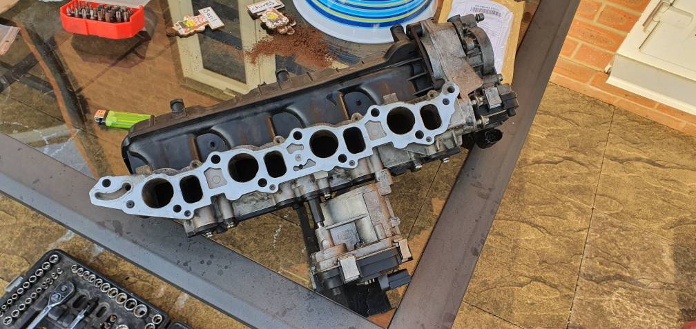

Oh and I also have stripped, cleaned and de-flapped the inlet manifold, that's a seriously messy job!

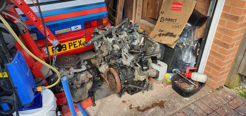

Re: Alfa 159 Sportwagon TI jtdm

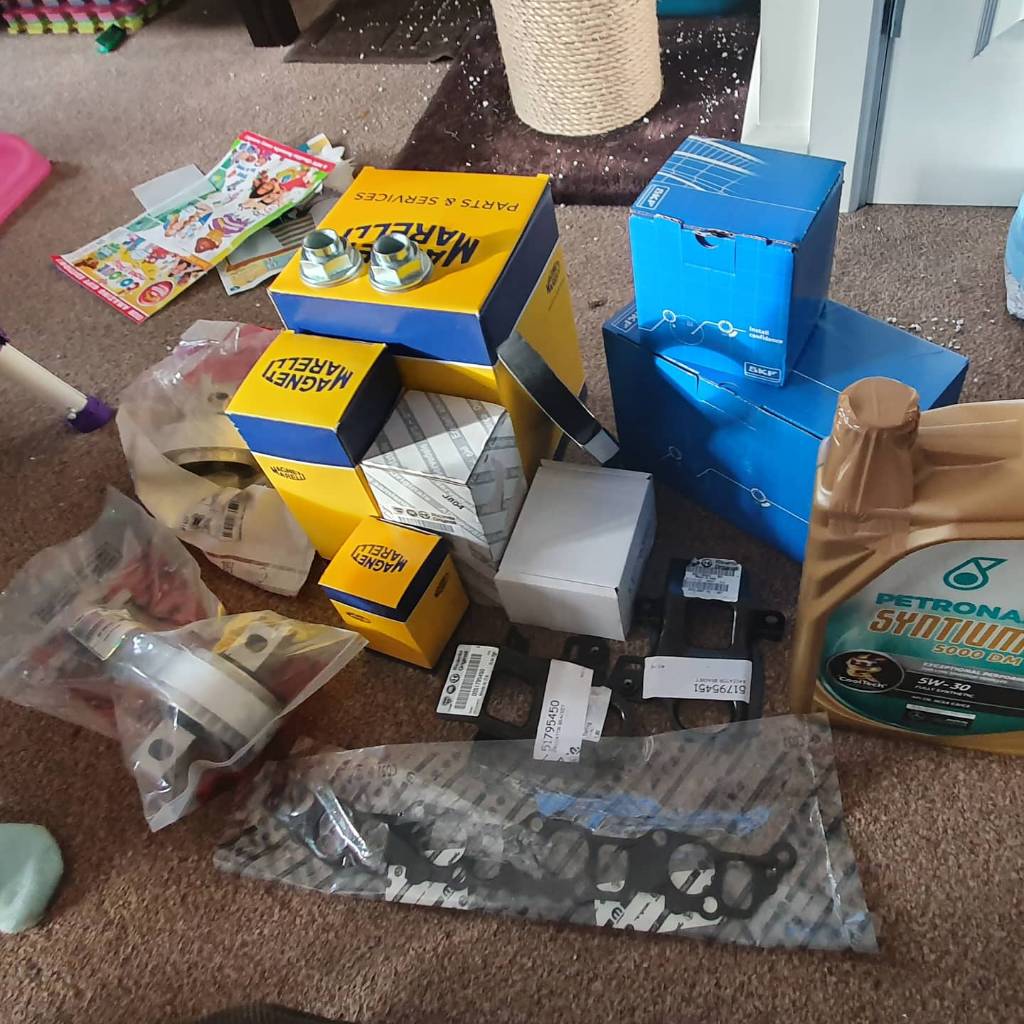

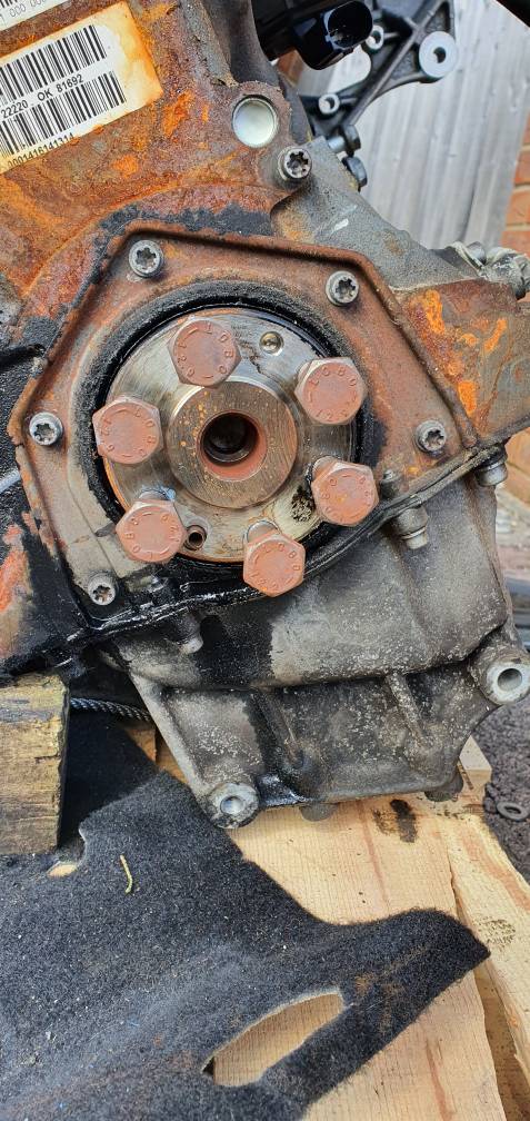

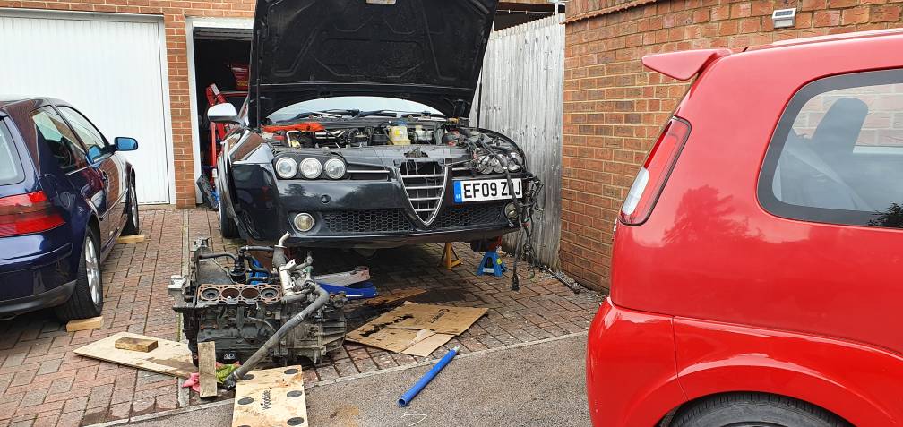

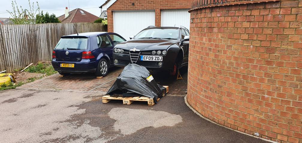

a big present arrived

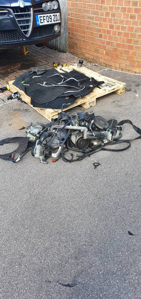

unfortunately I'm due to go away so this is gonna have to wait a week or two at least. But set about stripping some bits off because I wanted to move it into my garage and my neighbours car is also broken meaning this had to scoot between them 2 cars without a hoist or anything so lighter and smaller the better lol.
Gonna have to buy a few more pieces me thinks, at the bare minimum a cranks seal lol
But managed to get it in the garage without damaging any cars in the process, phew!
and stuffed the old one back in too, really struggling for space now!
and the pile of not needed so far.

brief update, no pics or anything as not much has happened.. But i have stripped it down to the point i can pull the inlet manifold off today and.... it has already had deflapped inlet which bodes well, someone loved it anyway :woot:
