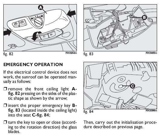

Thanks Davren, the sunroof is dead but won’t close 100%, the blind always worked but now it’s stuck open,so maybe air is coming in through there....when you press the switch for the ultrasonic is the light supposed to stay on?when I press it the light flashes a couple of times that’s it...the alarm stopped going off but still getting the theft has been attempted on startup?
There should be a large Allen key tool inside the switch panel to close the sunroof if the motor doesn't work.
The light should only flash a few times after pressing the exclusion button(s).
The switches don't permanently disable the ultrasonic and anti-tilt sensors, only until you switch the ignition on again. You would need to press the switch(es) again every time you switch the ignition off.
