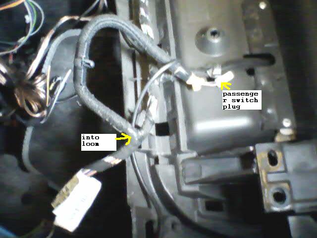

interestingly the loom cable for the passenger airbag on the 2b comes up rather than across the glovebox
i think the wires get stretched when glovebox full but the switch is a very cheap nasty piece of work

I also have an airbag light that's turning out to be a struggle to fix. My passenger seat disable switch lights up on the dash so I assume it works ok but the red airbag light is on all the time
on a mk2 this is a common and covered loads on here problem, you need the new loom from pasenger disable switch, the part is a fiver and fitting and reset is about an hour.

The passenger side cable is the next on the list.​
airbag looms are usually all one piece so not as simple as a quick plug in for one side
but not sure on a punto so i could be wrong
Sounds like solder and heat shrink sleeves might be the best option.
pulled the dash down on the 2b and yes airbag loom goes into standard car loom so not straight forward

On mine I stripped the connector and the inhibit switch down and cleaned the bits. I reckon the crap was in the connector. All worked fine after that (and a reset via my modified KKL lead, FiatECUScan and a laptop). Shame it took me a year to get round to it!
