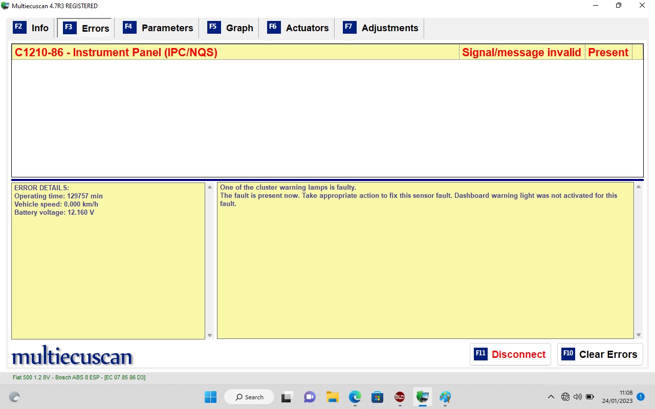

Also have from a screenshot:

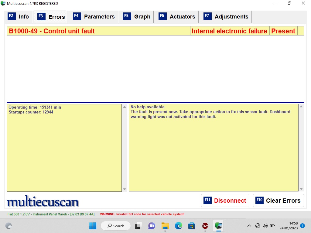

Another update when I clear this one down the light goes off, so I think this may be the problem:View attachment 417869
Thats says the opposite of what you are telling us.. :)
Use the MES in Actuators to trigger the individual Dash Warnings..
will help to spot if your vehicle is truly compatible
Do you get a RED and Yellow warning?
Hi thanks for the quick reply.
I think the instrument error was an old one when water got in car. This error has gone now.

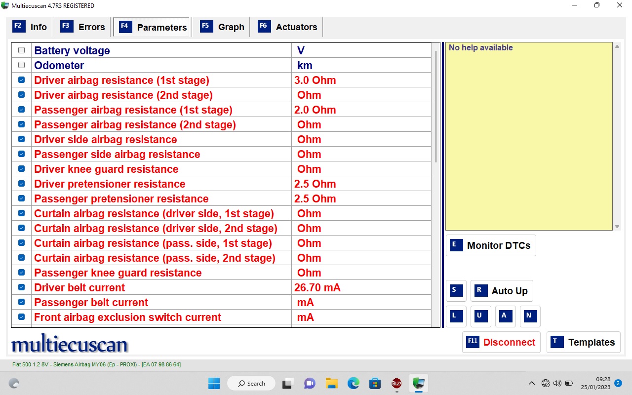

Only code I get now is the B1000-49 I tried the actuator settings and can see the ohms and when I plug the seatbelt in etc.
not sure on red and yellow warning. I get Yellow airbag dash light, then a beep saying airbag failure refer to users manual.
Checked this morning light off again (after overnight without being moved)
Heres's a pic of the actuators:
and a Scan from scratch this error was still there (but no light so weird).
