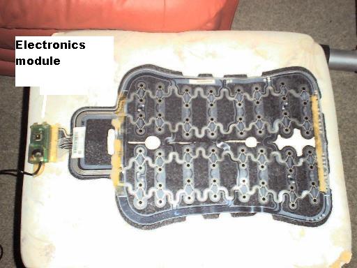

rite well i took the passenger seat apart and had a look for the OCS, i took the cover off the seat so i could see the yellow foam cushion and the white underside of the cover but no OCS unless it is contined within the cover for the seat?
so assuming that my OCS has somehow vanished, would that be the reason for the increasingly annoying beep beep beep "airbag failure"??
Re: airbag failure
Look in the Stilo Guides and you'll find useful photos and a description of how to replace the OCS,
Here's one to be going on with
Sounds like someone was trying to turn the airbag failure warning off without having a clue what they were doing. Hope they haven't touched much else
