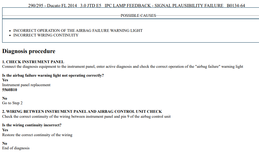

Using eLearn, DTC I have the following checks
Using MES I can operate the airbag light on the dashboard, so moved on to check number 2.

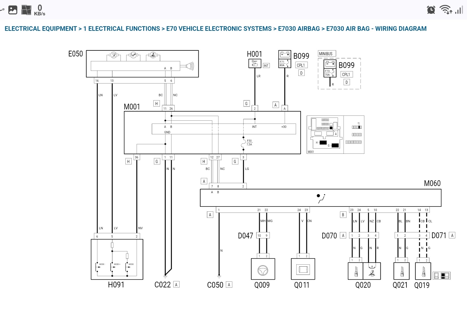

Below is the wiring diagram

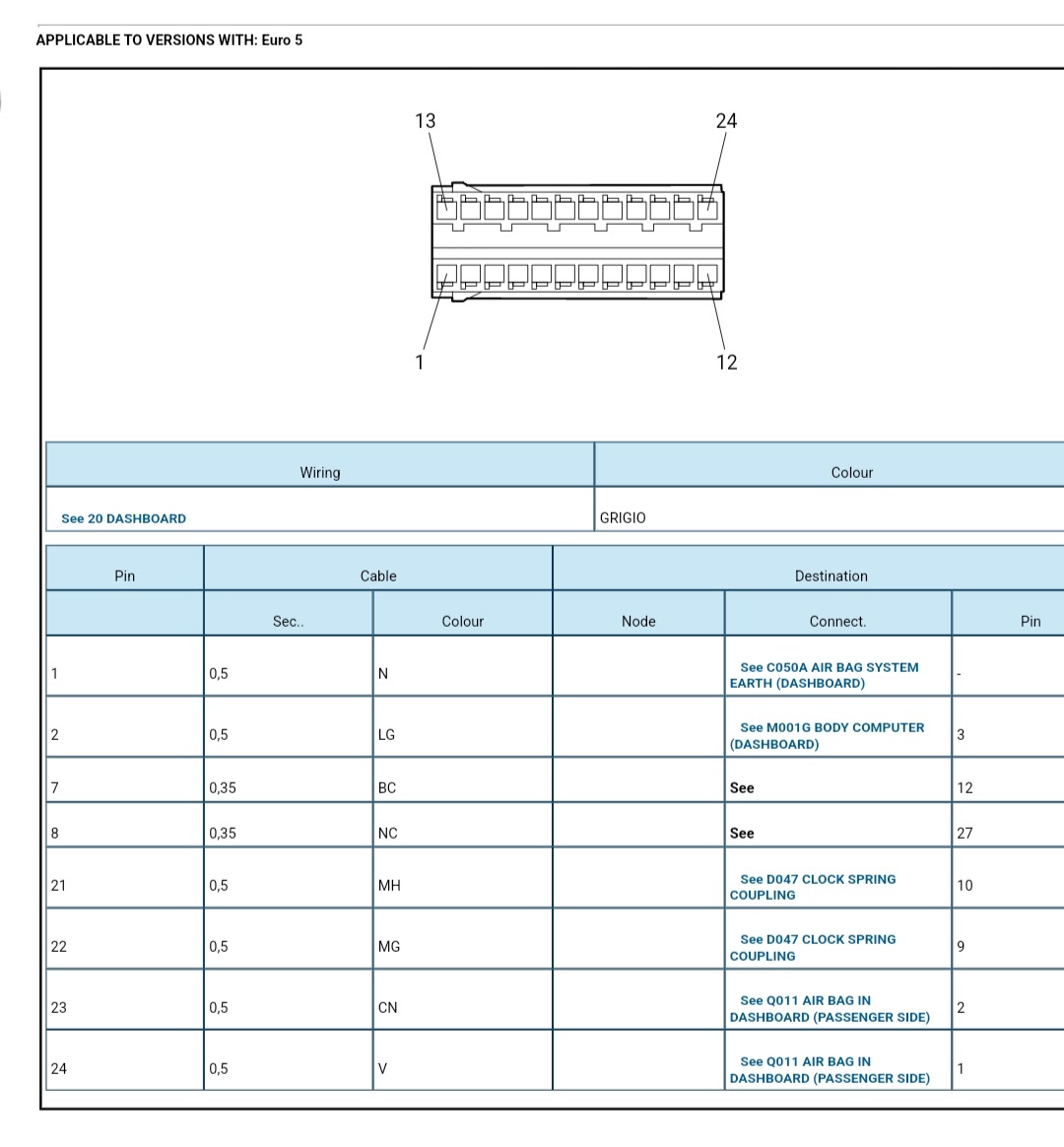

I thought that the best place to start was the CAN lines (pins 7 and 8 of Connector A)
The wire colours for these CAN wires does not tally with the diagram above. Mine are white and blue. All others on Connector A do.
There is also a wire from pin 9 but this is not shown in the wiring diagram
Have I got the correct diagram?

So the airbag wiring appears to be as shown in your attachment. The wire colours match what I saw today and the wire at pin 9 of Connector A exists.

Below is the wiring diagram (for my 2015 3.0 x250 with an x290 body computer) showing the wires which I've checked for continuity. I'm slowly getting used to the camper and how things come apart!
So of the wiring that I've checked all is OK.
The B0134-64 error checking procedure is below. So is it most likely that I need the instrument panel (cluster) repairing?
