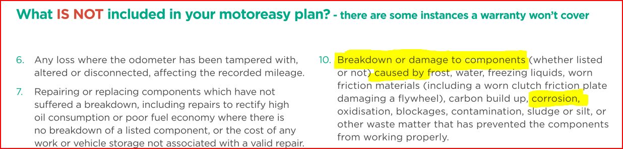

Just don't assume that because you have a warranty on the A/C, they'll automatically cover the cost of replacing a corroded condenser. You'd need to read the small print, but most warranties won't cover you for anything classed as fair wear and tear, or corrosion damage, although some do. Folks usually only find this out when they try to claim for something; it's not going to be written in letters ten feet high on the warranty provider's sales brochure.
Even getting hold of the small print is challenging; it took me ten minutes of internet searching to find an example.
This is an extract from one, taken at random, from an all inclusive warranty where the headline page says wear and tear items are covered (the highlighting is mine).
Note that warranty also specifically excludes anything which has not already suffered a breakdown, so you can't claim for things which are about to fail - you have to wait until they have broken.
