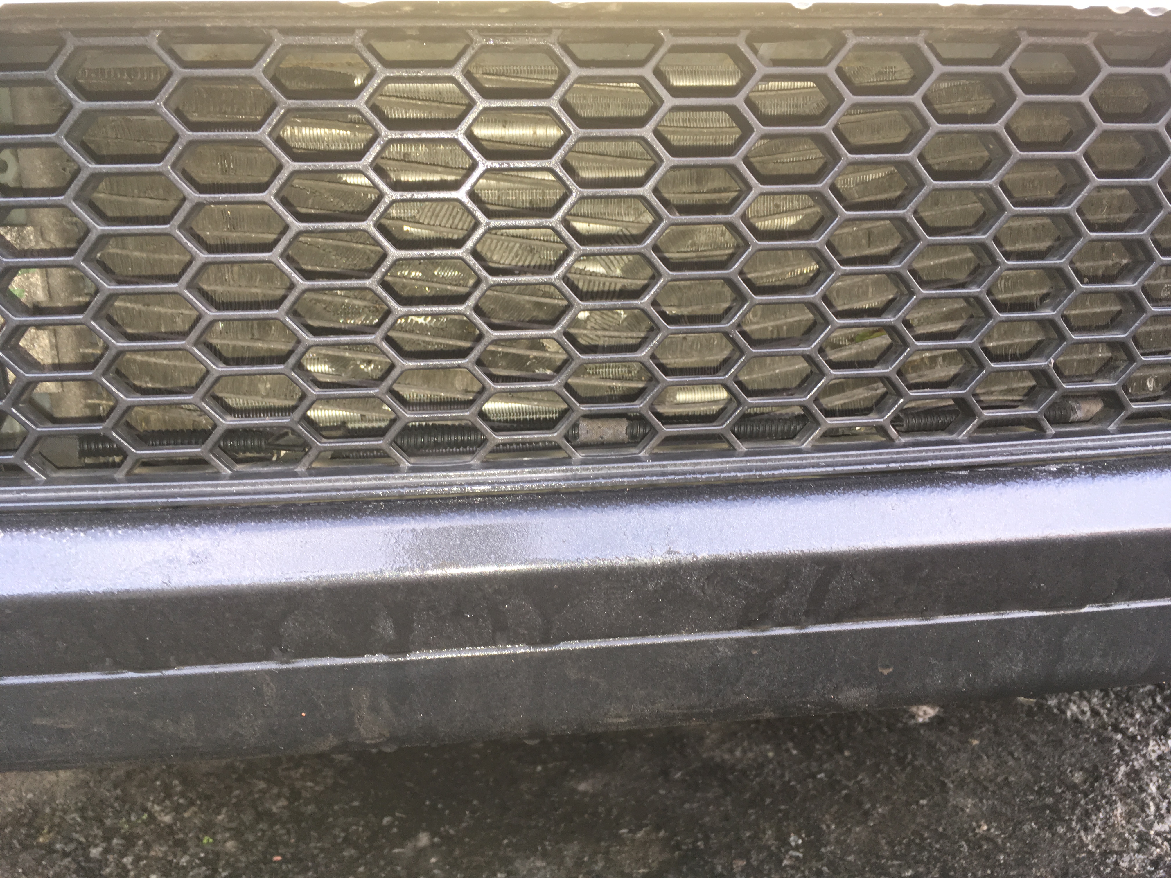

Does anybody know how much it costs these days (2017) to have the air con condenser replaced? I first noticed mine looking dodgy in July, thought the garage (not a Fiat garage) had maybe damaged it when putting in my new radiator but when I asked a Fiat garage if this was likely, they said probably not , these things happen.
Basically the bars across mine are all bowed downwards and a lot of the fins are missing completely or hanging off.
Didn't think too much about it as air con still works, but the other garage I had my car at for MOT this week mentioned it and that it's probably not got much longer left. Also, is there a possibility this was caused by the garage when fitting radiator, the bowed down parts, or not? It's every bar bowes at the same part.
Would like air con fully functional for summer but don't fancy paying extreme costs x
This is caused by corrosion from driving on wet salty roads in our typical UK winters. If you look at other 500's (and Pandas) of similar age, you'll likely find they are the same. There's not much you can do to prevent this happening.
It's unlikely to have been caused directly by the fitting of the radiator, but doing so may have loosened any fins already weakened by corrosion. This isn't a criticism of the mechanic doing the job, just an inevitable consequence of working close to a component with rotting fins.
The loss of fins will reduce the cooling capacity of the condenser a little, but probably not enough to stop the A/C operating satisfactorily. Eventually, the corrosion will perforate one of the main refrigerant pipes in the condensor, and then it will either have to be replaced, or you could instead just run it as a car without A/C.
Until then, it's probably best left alone. It might even last the life of the car in its current condition; the fins are much weaker than the main pipework.
Even if you replace it, its replacement will likely go the same way in a relatively short time. Another example of Fiat parts quality.
Anyone suffering a perforated radiator due to external corrosion (as opposed to internal corrosion caused by running without the correctly inhibited coolant) will likely find their A/C condenser is in a similar state. They're made of the same materials, and located in much the same place, so equally vulnerable to the effects of salt spray.
Thank you. I'm in Dumfries and Galloway so there should be a few places. My warranty (used car with Warrantywise) says air con is included, but I don't know of what parts, if it has to wait until it fails completely before they'll cover it, or because it's looking knackered would they cover. My warranty expires next month so keen to either do it before then, or hold off and renew my warranty anyway if they'll cover it at a later day. Just for info.. this is my condenser through the grill... I hope the first gRage didn't do this.

I don't know if it's the photo making the condenser look really bad, but it looks bad? Whether it is affecting the performance of the A/C system, well you won't know unless you take the vehicle for an A/C service, but something is telling me here that it isn't in the best of health. A leak test will definitively tell you.
If it were my car, I'd get it done, but then I use my A/C every day. In fact, I had it serviced just two weeks ago, 20 months from the last service. What I discovered on this service, was that my A/C system had lost no refrigerant at all, which surprised me a little. Anyway, based on that last service, I'm not going to bother getting it done now for at least 3 years.

Wow what does the top of it look like? a big dent downwards? ADRAD comes in at £65 for a new one but may find cheaper, I doubt the warranty would cover what looks like physical damage. Example check spec for your car
