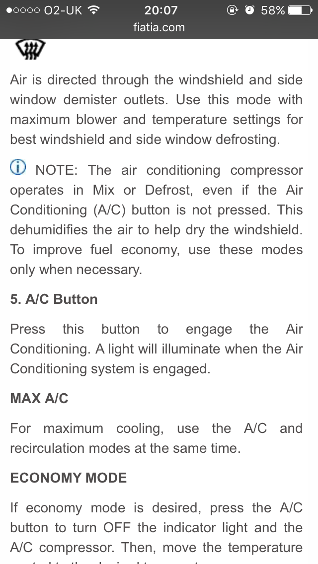

On models with manual climate control, if A/C is selected off, the compressor won't run, irrespective of the position of the other controls.
That said, all you need to do is to use the car as normal. If the condenser gives up the ghost, the refrigerant will quickly be lost and then the compressor won't run regardless of what you've selected. The low pressure sensor will activate and prevent it from operating.

Thank you. That's fab. The only reason I wondered was because I read this last night..
