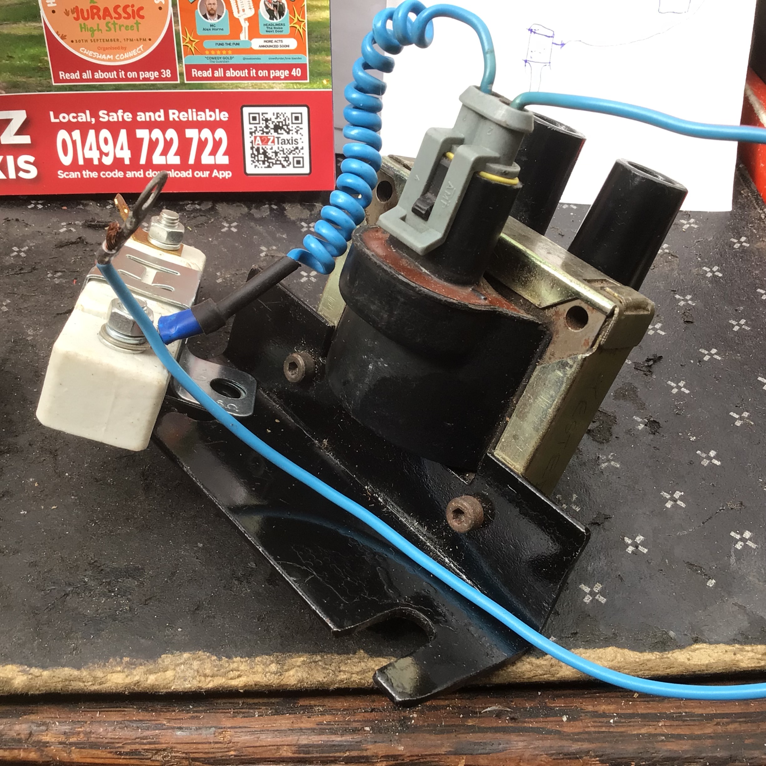

I've set the timing with a strobe gun to 18 degrees at about 3k rpm, using the adjustment on the crank sensor, and been able to drive it around, which is positive.
The timing when checking with a strobe at full advance should be 28 degrees, this is 10 degrees base timing + 18 degrees of centrifugal advance from the distributer. Presuming that's not a typo, then 10 degrees extra advance will certainly make it peppier!
Intermittent power problems are harder to trace. To be it's more likely fuel/spark related than something inside the engine. I'd give the wiring all a good wiggle, look for anything that could be loose or shorting. Plug leads or dodgy earths is a classic for issues like this. You've been through the car recently, so it's less likely, but check to make sure there's no loose flakes of rust or anything in the carb that could intermittently block a jet.
