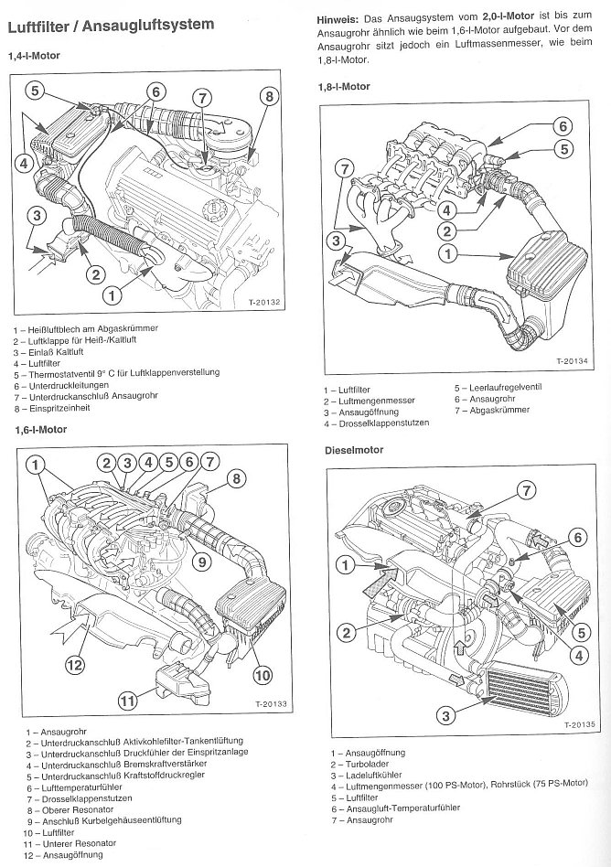

Ok, thought about doing this on my 1.6 Brava.
All that actually needs to be done is removing the "elbow" and leaving everything else in place where it was, right?
fixitagaintomorrow said:
Could be a resonator box - some intake systems have these to dial out certain noises and frequencies - you know, the type we are trying to make louder by doing this mod :D
It's possible as there are two resonators on the long box fixed to the slam plate. I still go for a drain though as it looks like it is on the bottom of a 'U' bend.
Our pipe slopes down into the elbow and has the drain in the bottom of the air box.
I think you're right...
This diagram shows it (on the 1.6 and 2.0 engines there should be 2 resonatorboxes - upper and lower).
