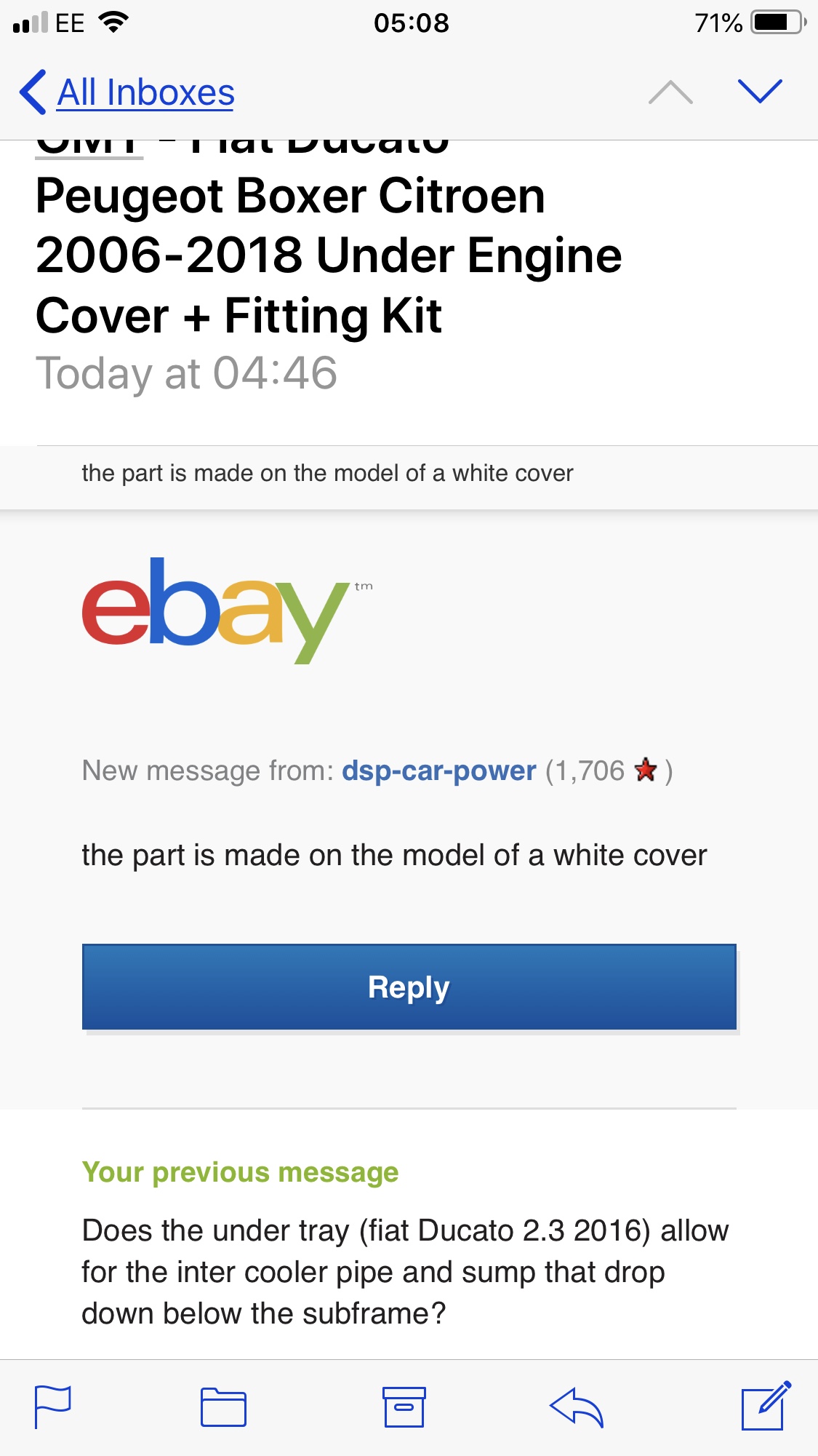

Has anyone fitted one of these engine under trays off eBay?
I’ve never looked under a boxer/relay but on the 2yr old Ducato (which needs a new sump due to rusting through
I fancy fitting one to protect the new sump
But the sump and inter cooler pipe hang lower than the subframes etc
Asked the supplier and received a great answer
Just wondering if any issues relating to it’s fitting IMG_4871.JPGIMG_4872.JPG

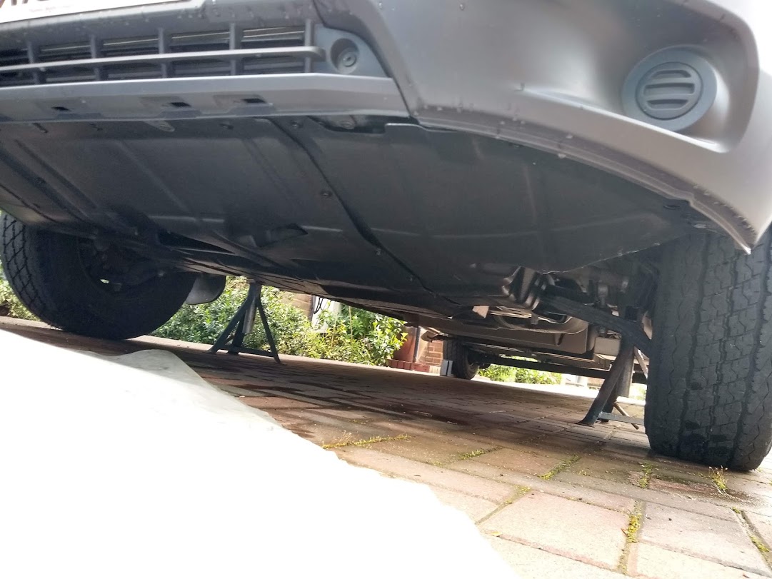

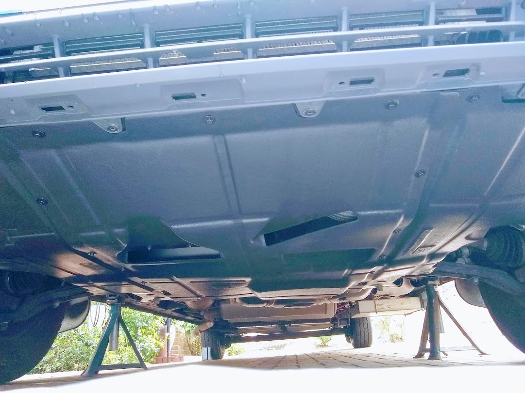

Just thought I'd mention that after finding quite a lot of surface rust on the sump of my not yet 3 year old van, I rubbed it down and repainted it, and have now fitted one of the undertray kits from Poland as shown in rolopolo 's link above.
I have to say for the price (£72 including delivery and fixings) I'm pleased with it and actually pleasantly surprised by the quality. Yes, it's thinner than the OEM cover, but it is a durable and strong plastic material and the quality of the moulding is actually pretty good. The fixing holes line up with the fixing points on the van and along the edge of the existing OEM right hand undertray panel. All the correct fixings for my X290 van were included and it is actually pretty rigid when fitted - a lot more so than the flexibility of the individual panels would suggest.
The only alteration I made was to fix a short length of aluminium bar above one of the air vents in the centre panel to keep it straight, as the moulding was slightly bowed, possibly because the panel had been folded within the box it was delivered in.
Overall though, I'm happy with it and it has exceeded my expectations.
Sorry the photos aren't best quality - it decided to chuck it down as I was finishing off!
