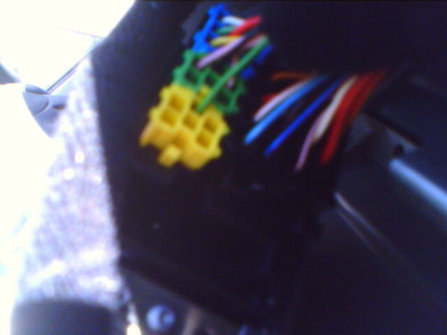

Darn. Seems the radio in the Panda is hooked up with almost every other part in the Panda: all connections on the radio were taken. The guys said that I'd loose the steering wheel controls and the console display (Don't care about that one actually). So, it was a no-go.
Anyway, the thing was pretty big, too: about 5 by 3 inches.

I did: check the attached picture. The BT/USB thing was using both the green and blue plugs, which, as you can see, are occupied in my Panda :(

Very useful picture and I believe proves my point, Blaupunkt use the blue mini ISO connector for cd changers etc on their aftermarket kit, the OEM Fiat versions uses the yellow mini ISO which as you have shown is unused apart from that one wire.
This is very good news for me as it is the other connections to the yellow one that I'm hoping I can attach an aux input to and was wondering where I could source a plug, appears you get one free with every car :) .
Actually, if you'd looked at the link to the Italian site you asked me for you should already know all this!

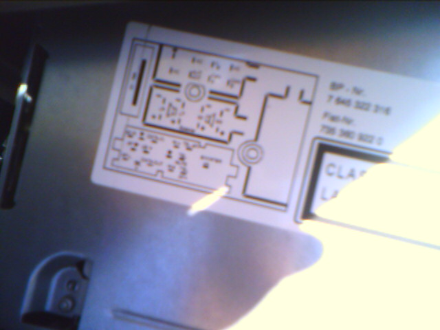

Uhm, not of much use, this picture, but apparently the yellow plug doesn't have any other connections?
Interesting, the wiring diagrams I've seen definitely have connections. Can you get a picture that's legible?
Not possible now, since the radio is back where it was and I don't have those U-shaped keys to get it out. But rest assured, if you have those keys, you can easily take the radio out. The cables are long enough so there's no need to disconnect the power and no need to enter some security code.
