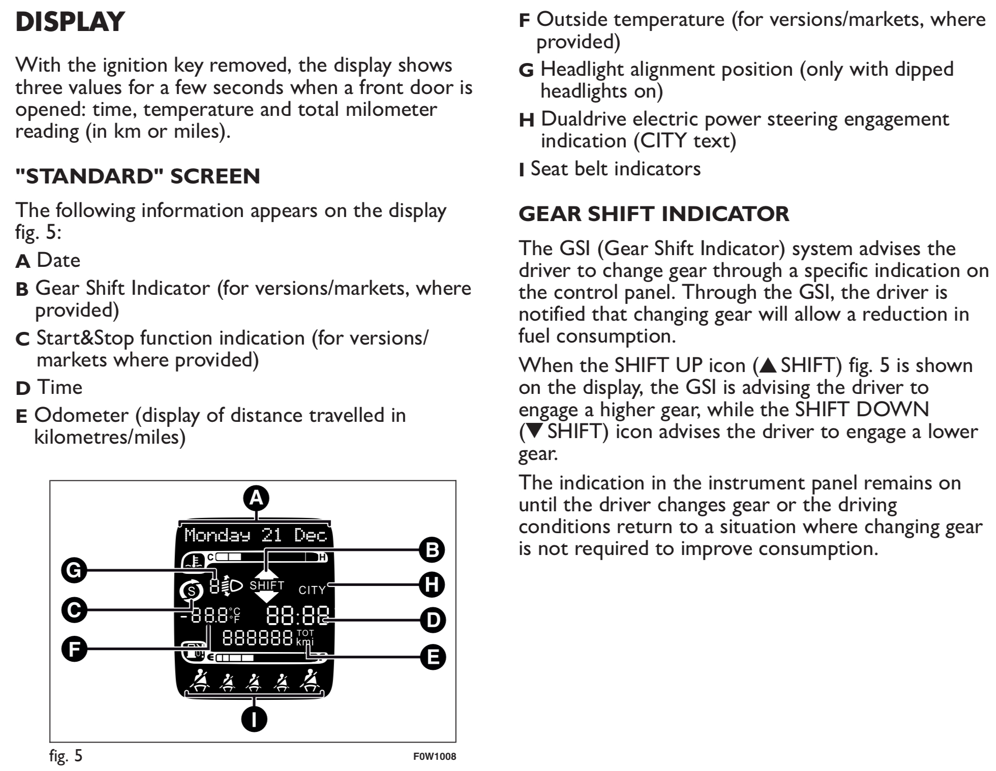

Thanks for the reply. Yes, I believe it’s the external display shown dashed. I’ve seen quite a few images online. The engine is the Twin Air petrol. Can anyone who has a Panda confirm that my dashed display should show the external temperature on the central orange digital display?
Thanks. Yes, just had a look. It is the display for the outside temperature.
So, as I thought, the temperature sensor is installed only with automatic A/C.
