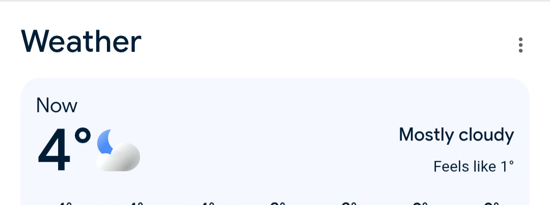

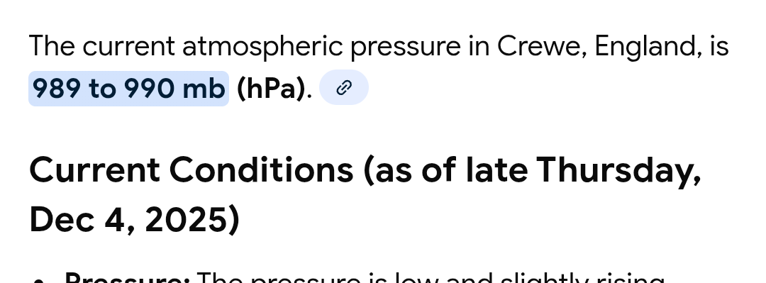

Switch the engine on and graph inlet pressure and temperature and leave it for about a minute
It should read roughly what Google says
For me
Should be a fairly straight line, small fluctuations are fine but no large spikes
Depending on the scale as you start the car and let it idle it will either drop from 1000 to 350 or 100 to 35
