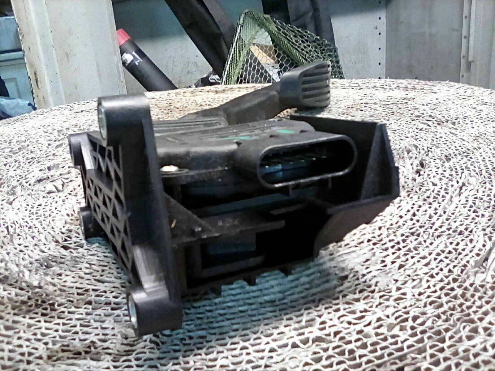

Hi, I've been looking at my son's car prior to the MOT as it has had the engine light on for a few weeks. Error code using
multiecuscan software is P0226 - Accelerator Pedal Potentiometer. Code can't be cleared. I have checked the electrical plug on the accelerator pedal and that is firmly in...

heres the connector I re-seated, mine was corroded as is the one in the generic photo
