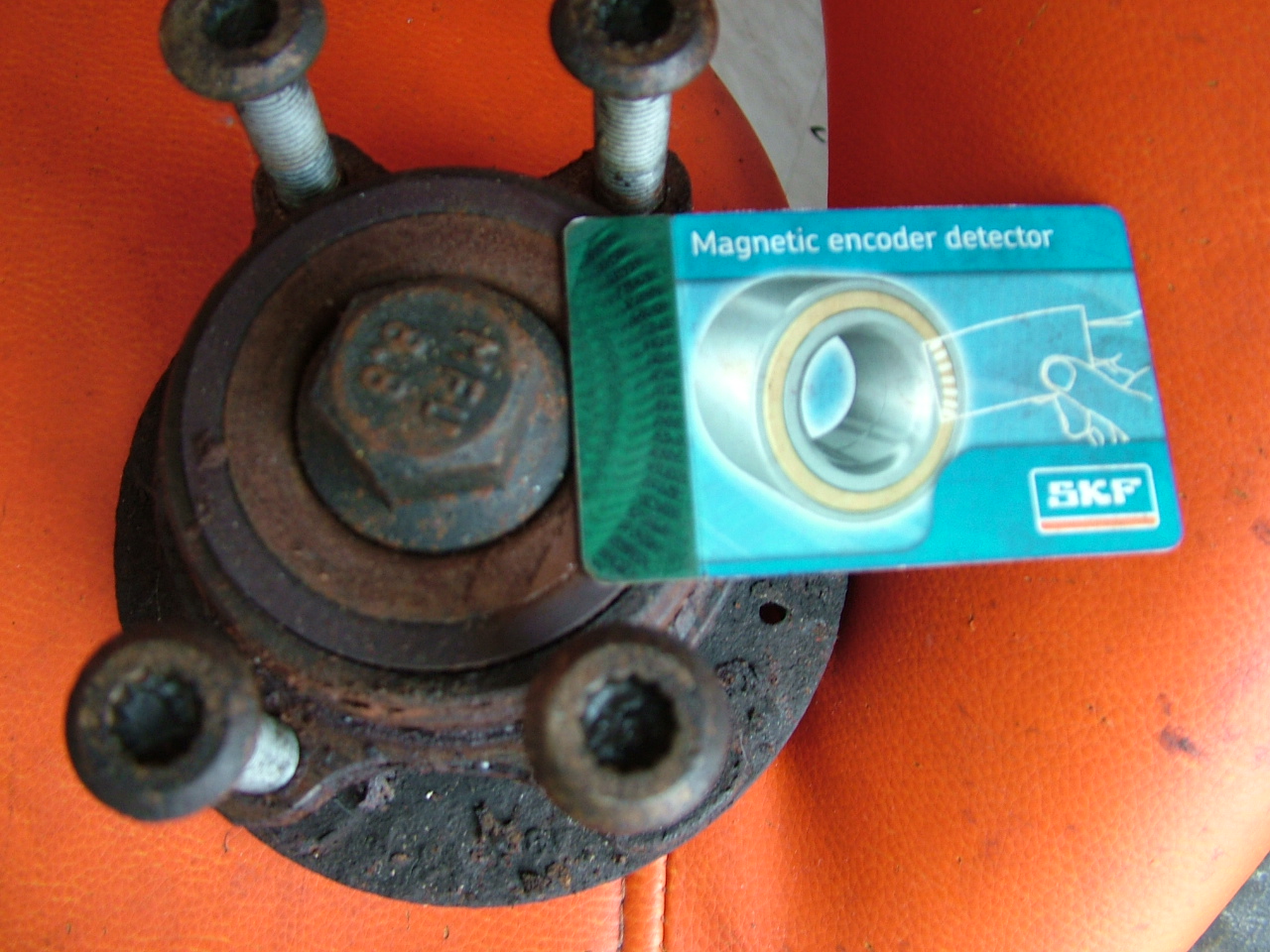

If it is in the bearing then a new hub bearing is required, so obviously test it first to be sure.
Any break in the readings will mean it is scrap.
I am lucky enough to have an ABS detector from the SKF bearing people.:)
