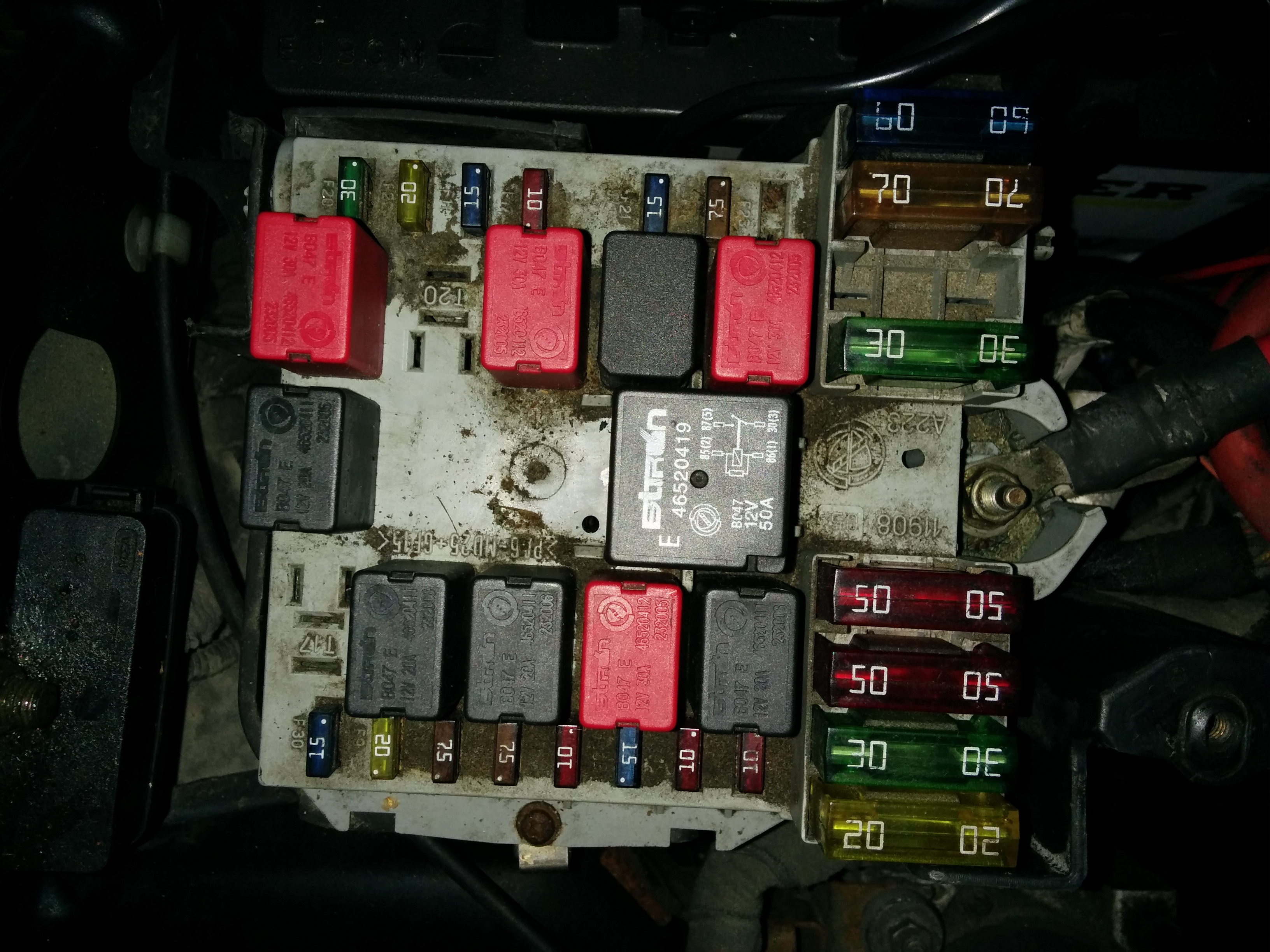

A short up-date - main relay fault found (via fault code)! - cleaned all fuse's and replaced all relays (see picture, in original condition pre clean and replacement)
(So as per other posts - it was good to do a general clean I think)
This has seemed to eliminate "all" (fingers crossed) fault codes apart from my old friend - ..............:bang:
Faults found.
C1107
Error code: C1107
No instrument panel communication
... but the car still works OK ... at the moment.... .. :)
