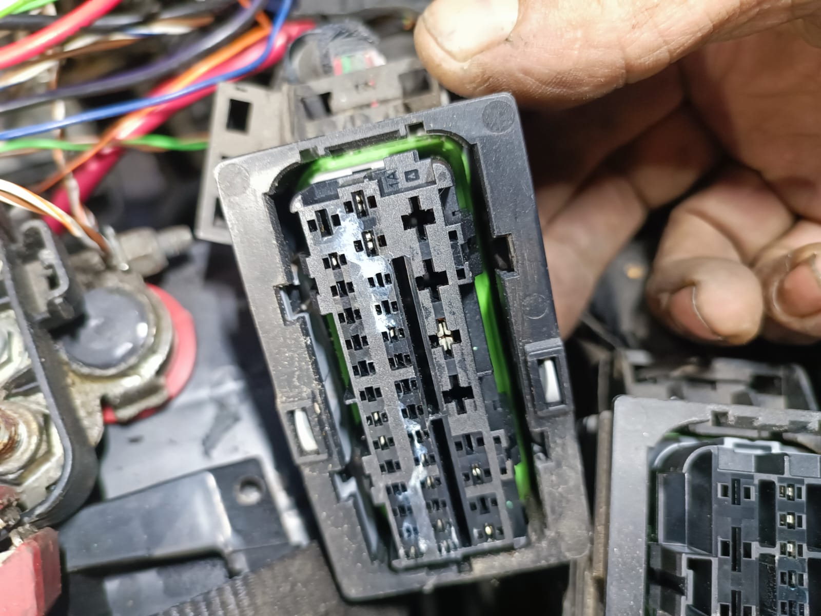

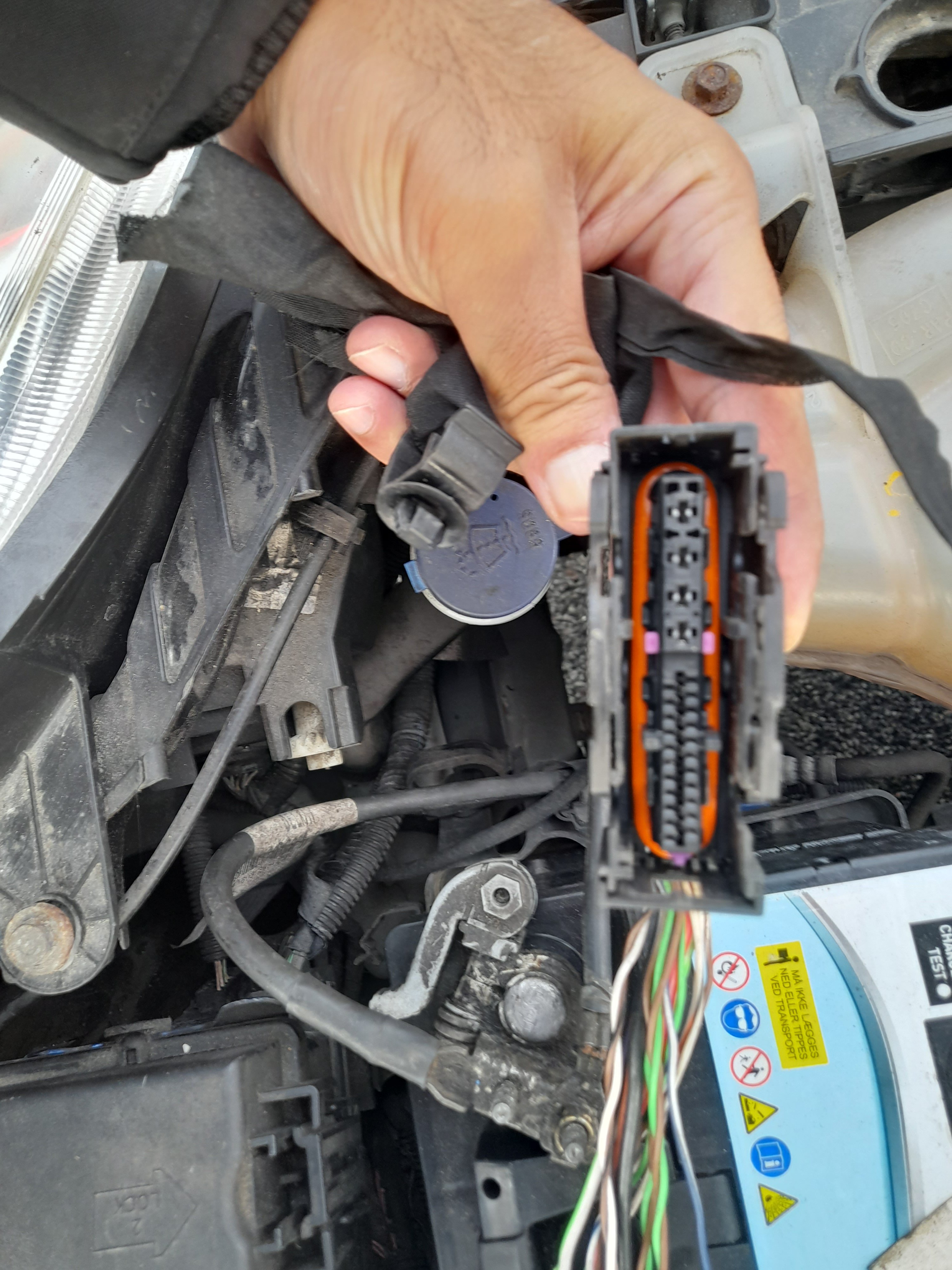

Looking fine... ???

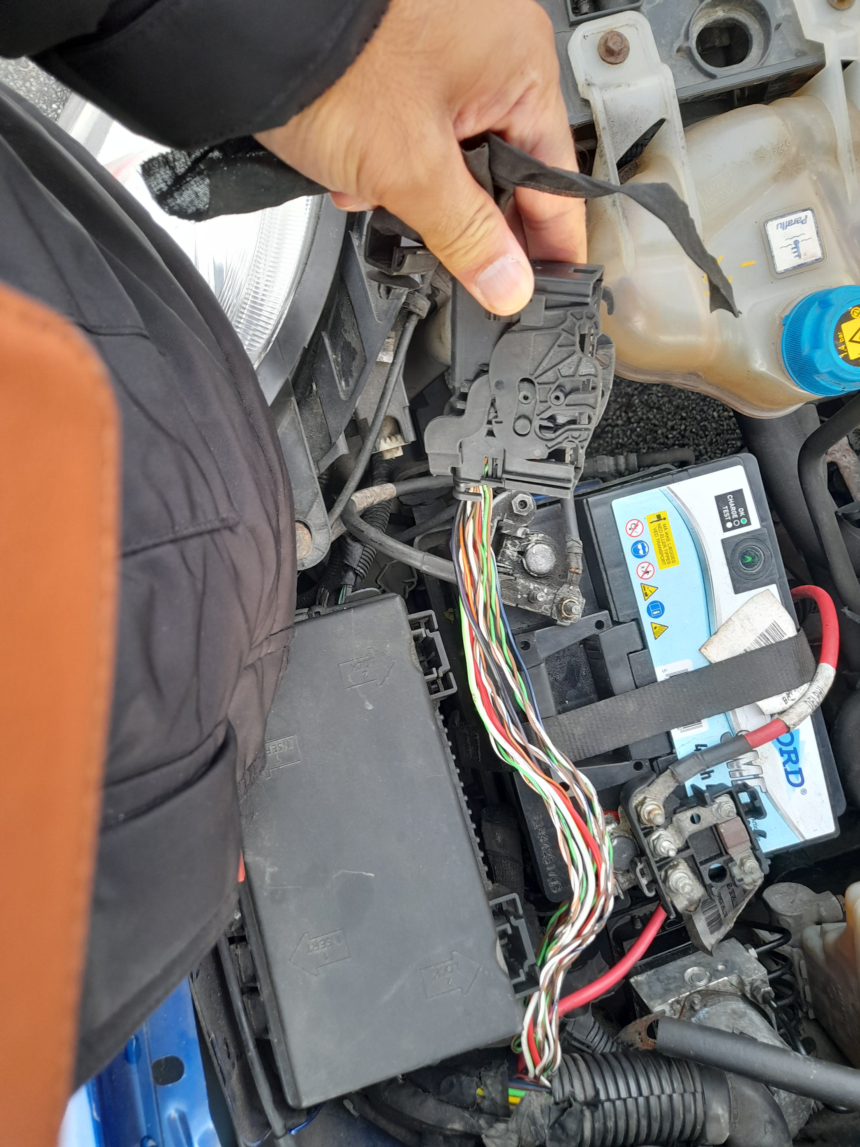

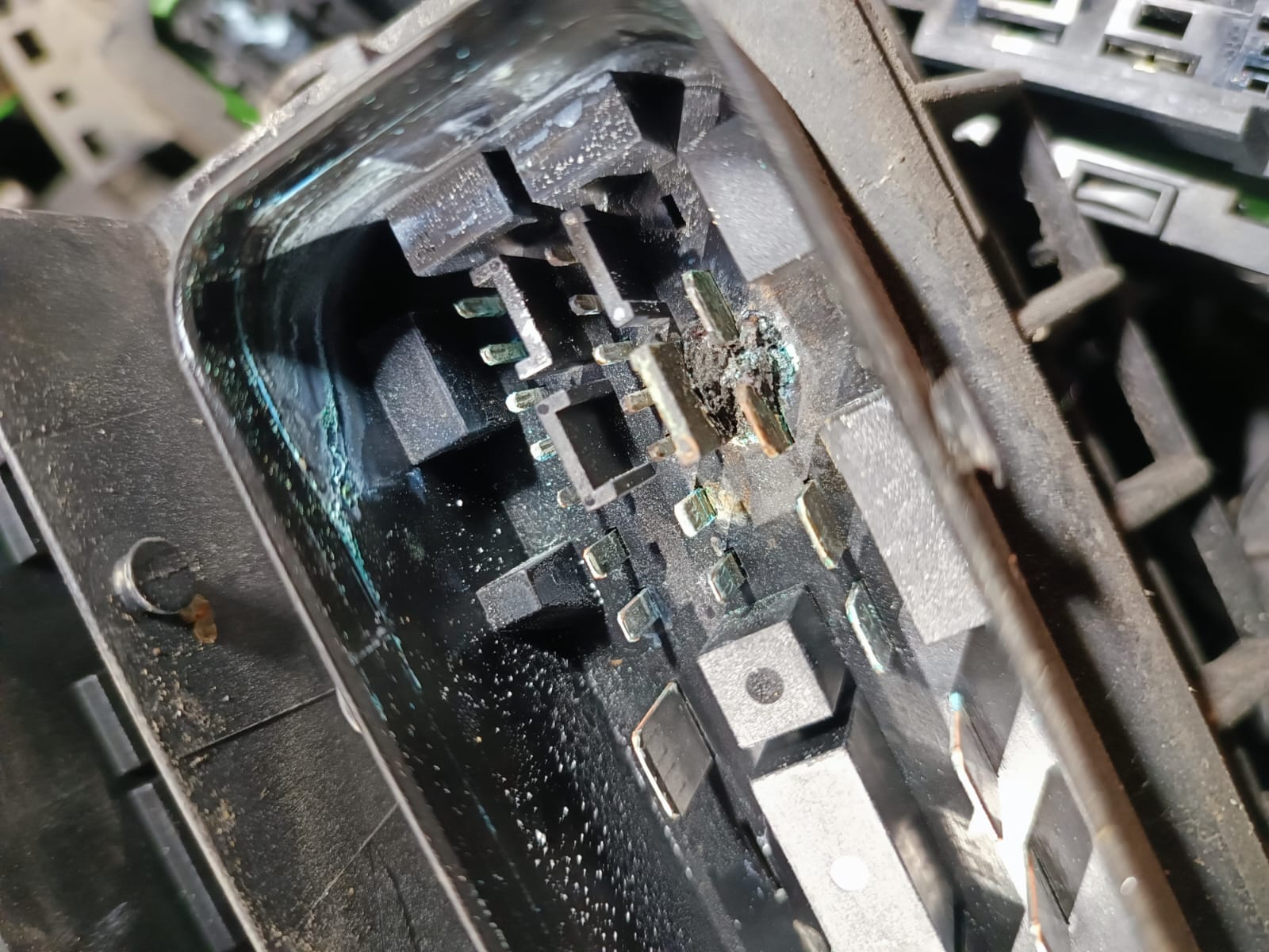

Connections in Fusebox burn off
