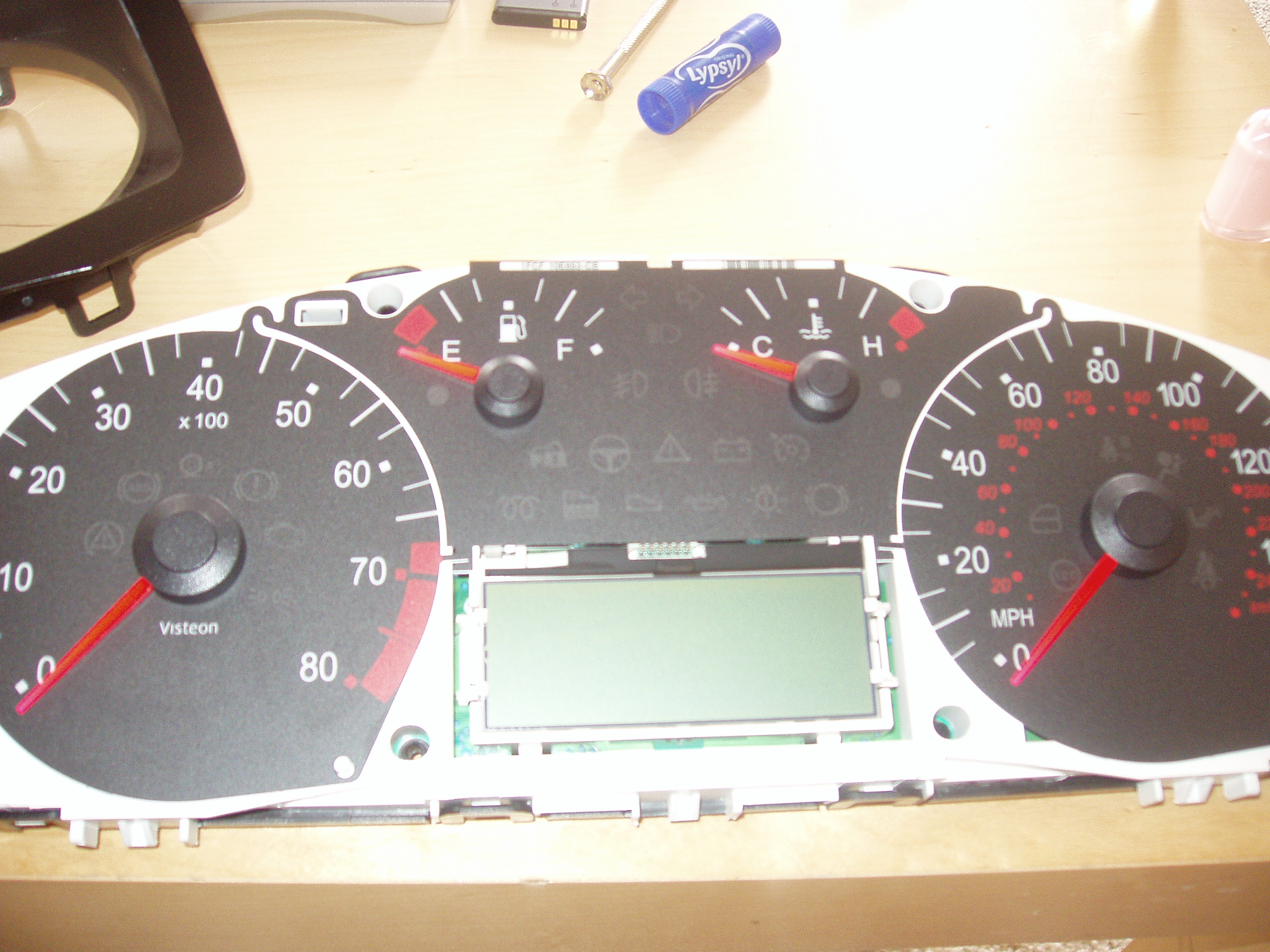

Re: Abarth Dashboard Colour Screen?!?
iv figured out how to get into the dials if thats any help just got into them now its not hard
heres a pic
make a short how to, and create it as a new thread, cos i've seen this question posted a fair few times, and I'd be interested in knowing in advance of me getting new dials.
Thanks
