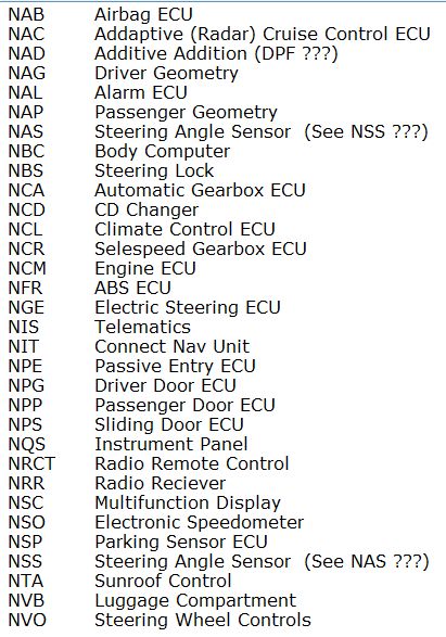

Also, exactly what is a NODE? Whats its deffinition so to speak?
NODEs are the different ECUs connected to the CAN system.
