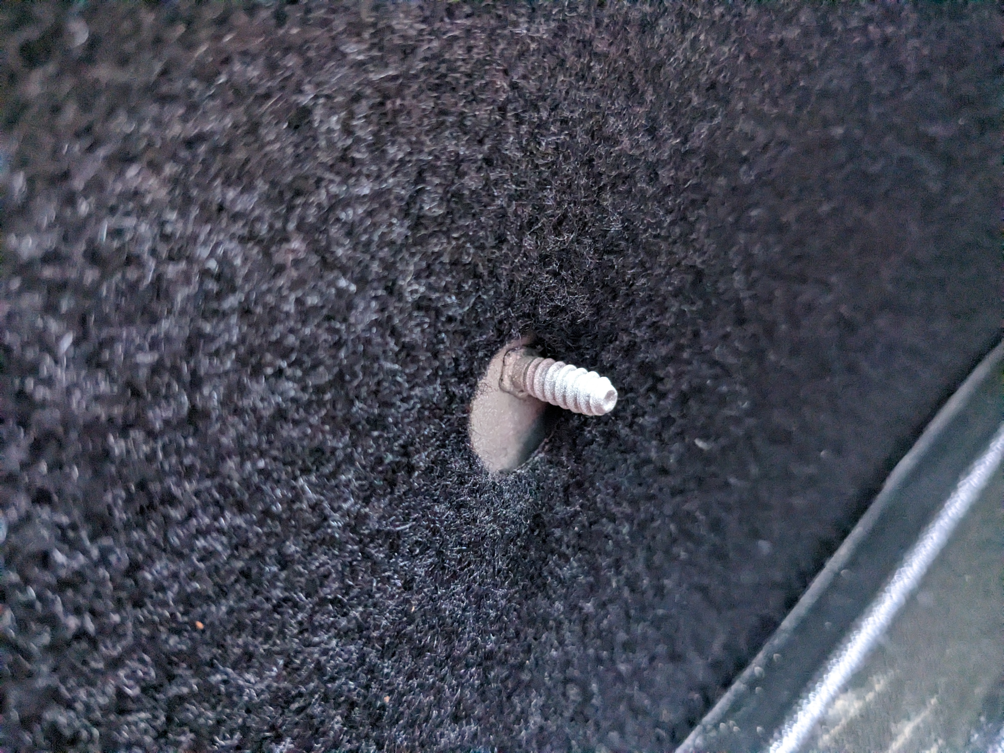

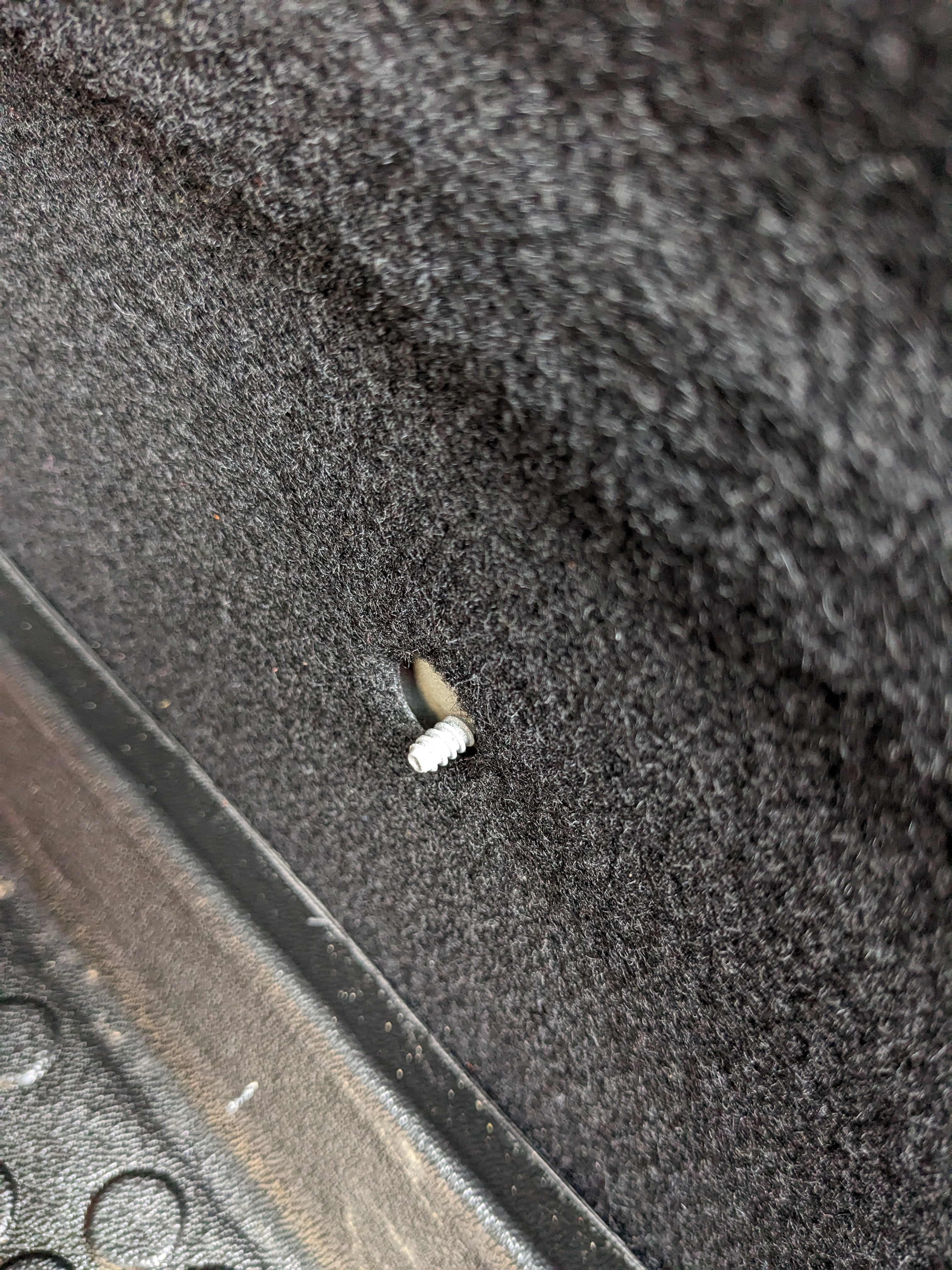

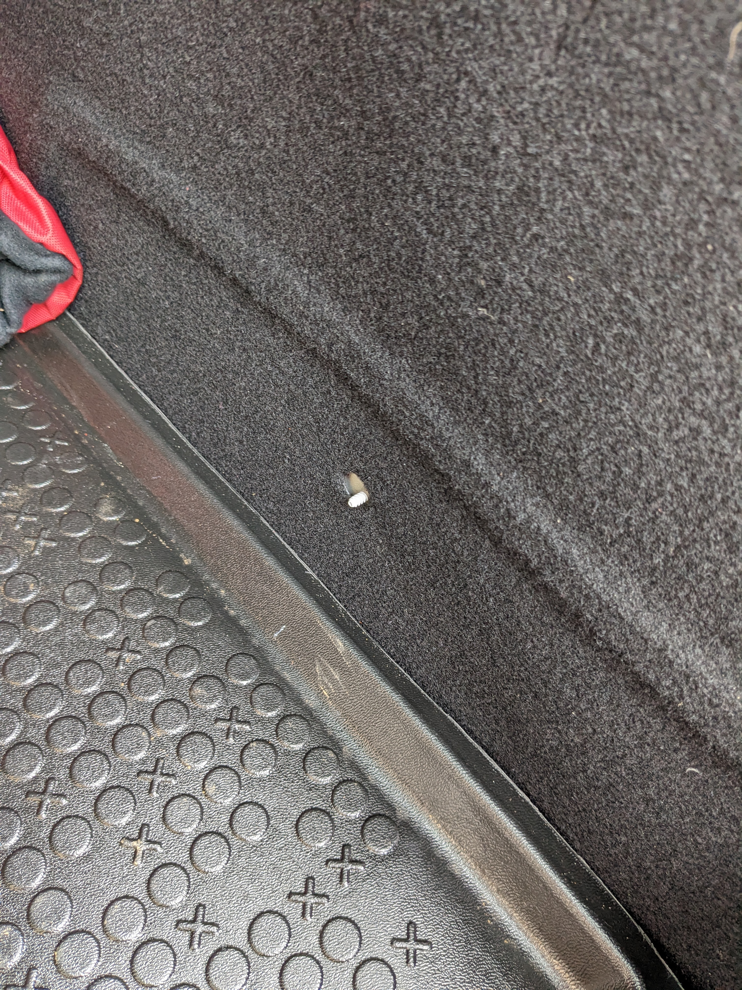

Does anyone know why there is a protruding screw in the boot of my 500x?!
What purpose does it serve, and should it have a cap on it?
Has a habit of ripping open shopping bags.

Interesting - I had the same issue and purchased in the UK one of the caps / buttons - 670003320 / however it’s way too short a thread - only goes about half way down the screw and just sticks out - imagine it must be flush to hold the carpet in place and as it only goes about half way down it sticks out and will get knocked off / break in no time. Odd.
My 500x has it and there is supposed to be a plastic plug on it.
Its supposed to hold the carpet trim in place. They fall off easily. EITHER, sek a new plug, or cut off the peg to prwvent it damaging things in tge boot. Its a Fiat speciality.
