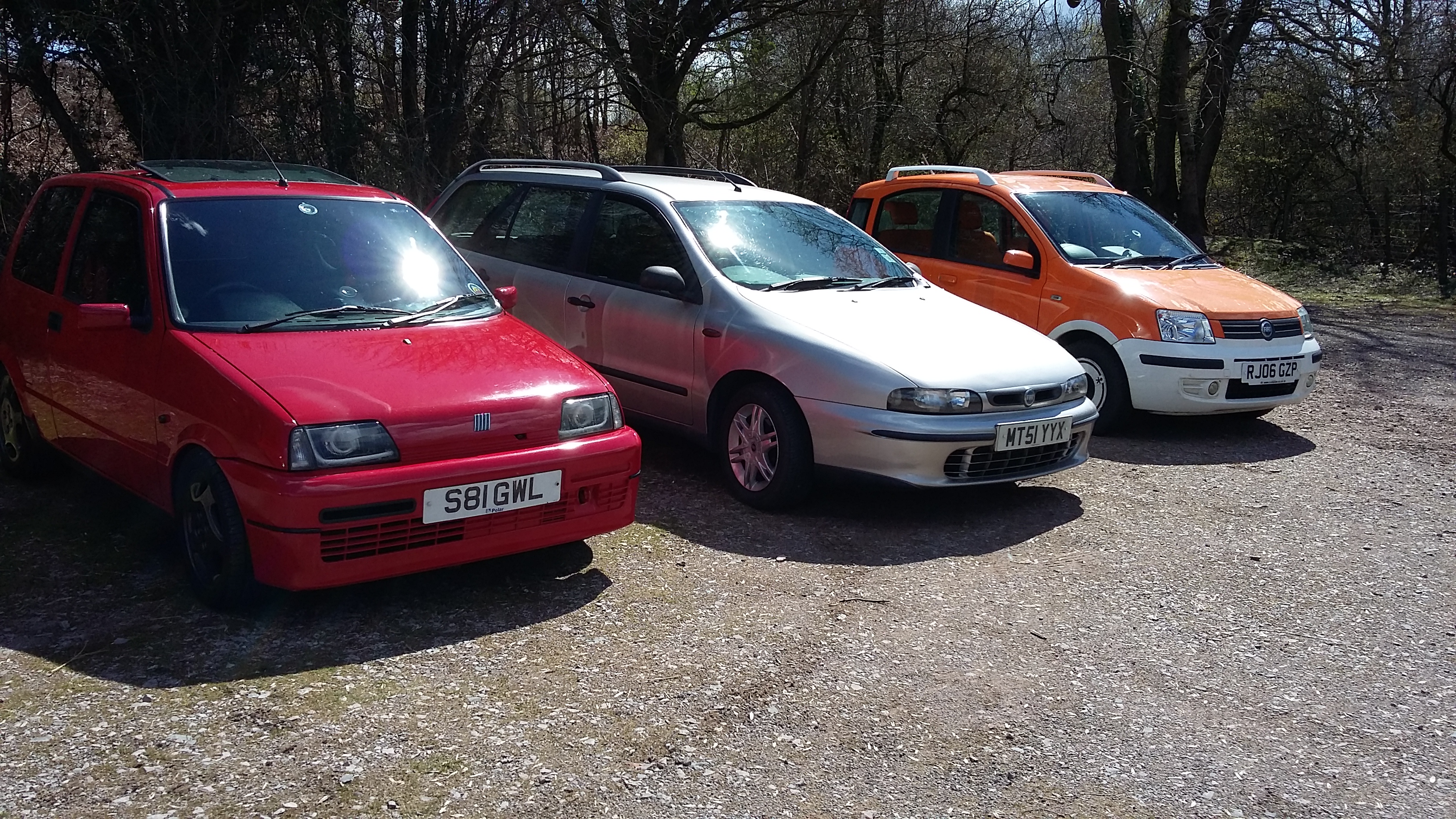

UPDATE - glad to say the marea did the @160 mile round trip to a Midlands Italia meet today..no issues..(y)
