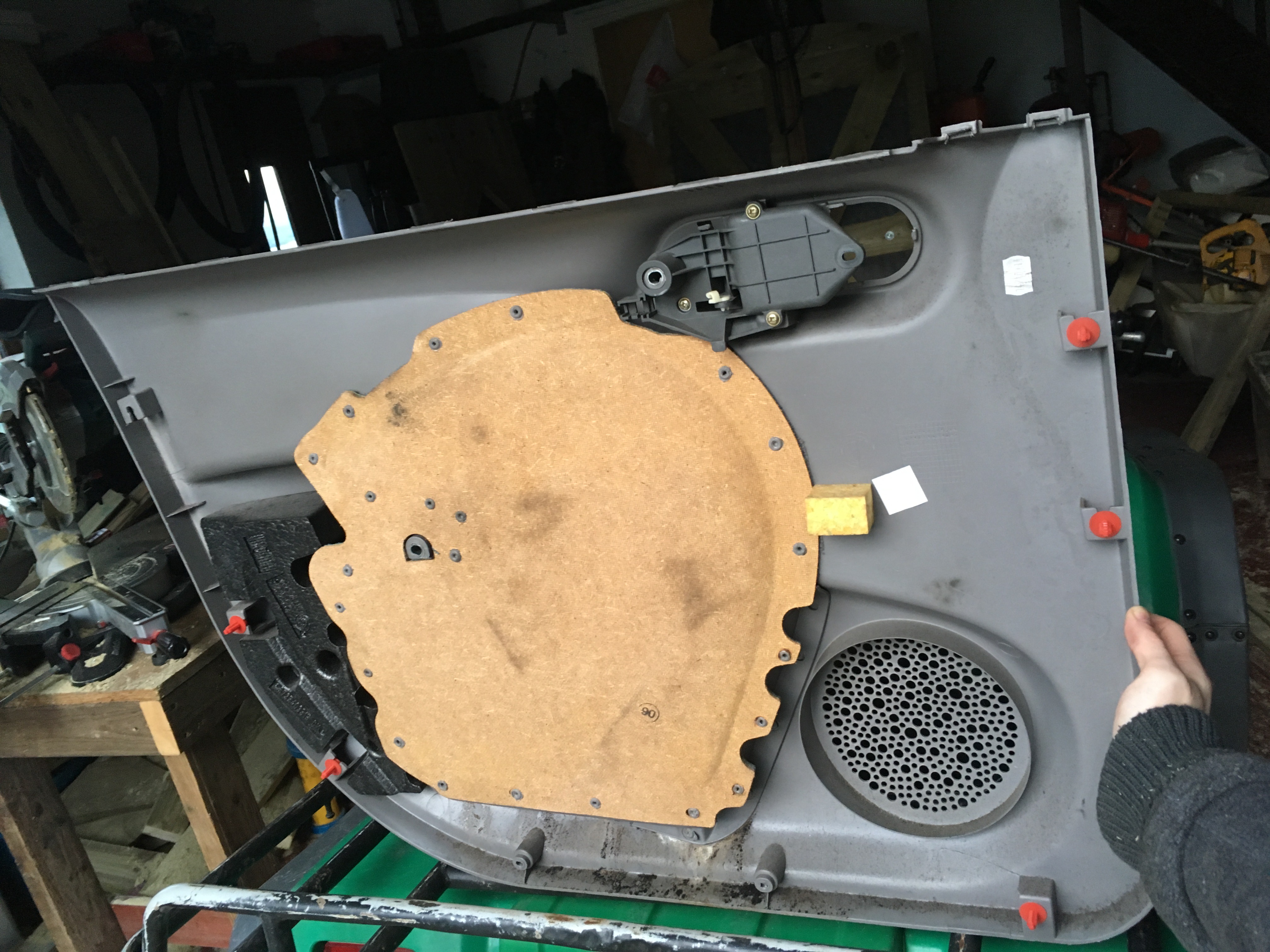

UPDATE!!
HURRAY HURRAH! Finally got the window clip fitted today. Ordered from Tomo parts via ebay and the first one came through broken. BUT after a quick email they sent another through no quibble.
Followed the instructions some kind person posted here on the forum and hey presto the window works again!
Thanks to all who commented or offered advice. It was much appreciated.
