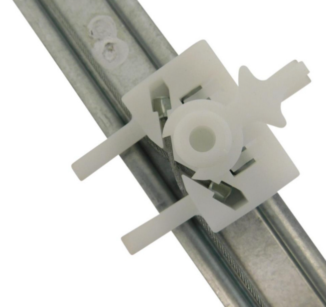

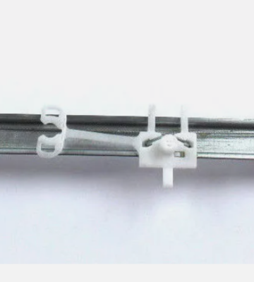

Which one
They both break
They are both getting hard to come by

The 2nd one, I think? Here are the pics of the piece that broke off. From memory there was already a gap between this bit and the bit still attached to the window. I didn't have my phone on me at the time, nor enough free hands to use it!

Second hand ones usually break when removing them, although I have harvested a few.
If you try the eBay route, watch out... so far I have been wrongly supplied with Doblo clips, wrong-handed clips and some completely unrecognisable clips.

71741287
Maybe ?
@irc can you confirm this is the correct part
Part number looks right for driver's window not for passenger according to my notes.
Picture does looks like the correct part for a Panda - the incorrect ones i have been sent in the past do not sit flat on the slider because the groove is in the wrong place.
From EPER I have these part numbers:
71741287 PAD RH Front
71744327 PAD LH Front
(However, @koalar could be correct - I got sent the wrong side when I ordered using the part number...)
