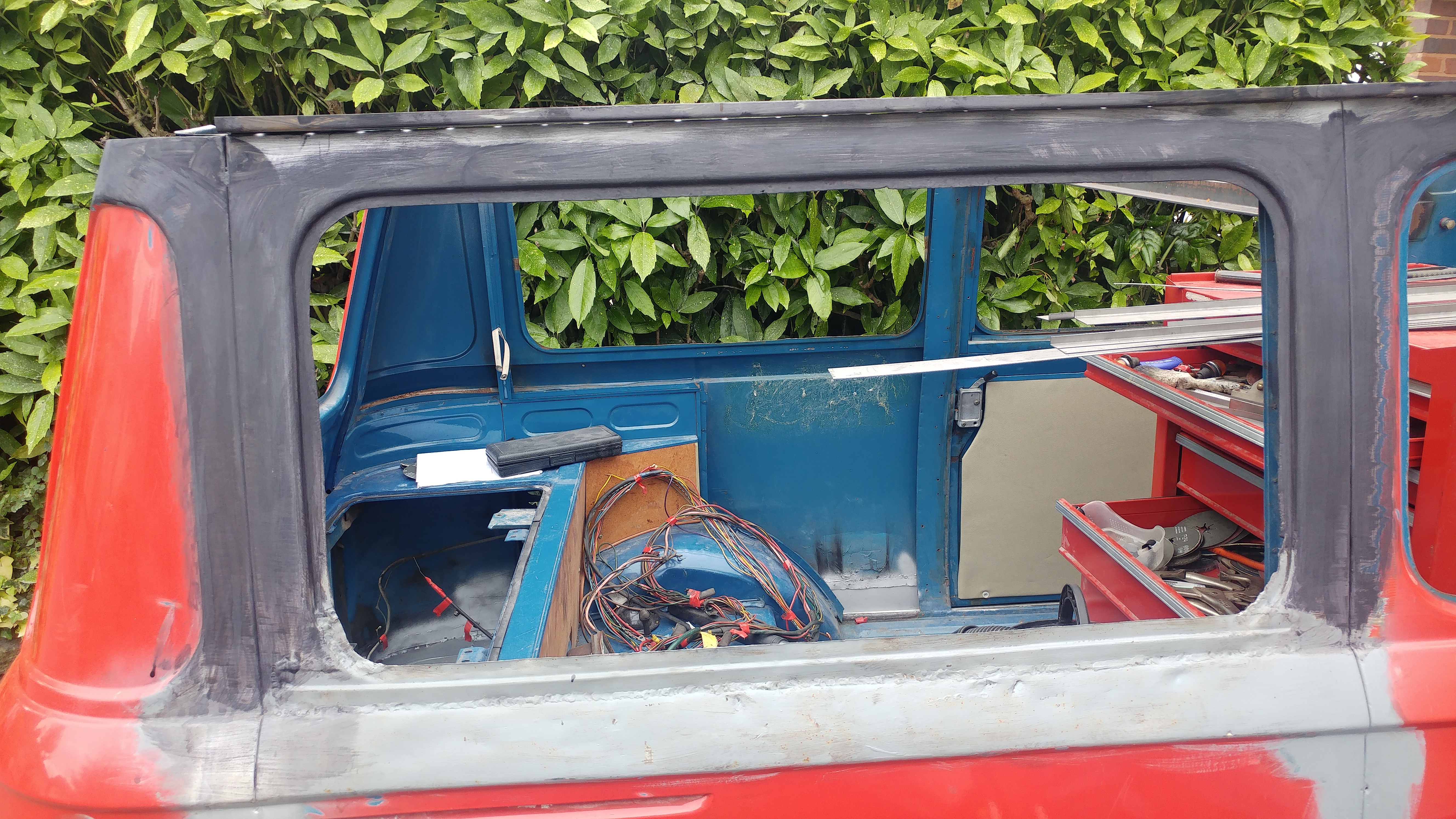

Peter, here are the pics of the window we need to repair. We're working on the roof at the moment so won't get round to this for a while. I've been taking a look on ebay.it but will be around £200 (with postage) to get a panel I can cut the repair sections from.
At the moment we're thinking the whole bottom section of the window will need to come out, and the profile underneath and a new section made. If you have anything left of the panels you've been cutting up let me know and we can arrange some recompense so all happy!

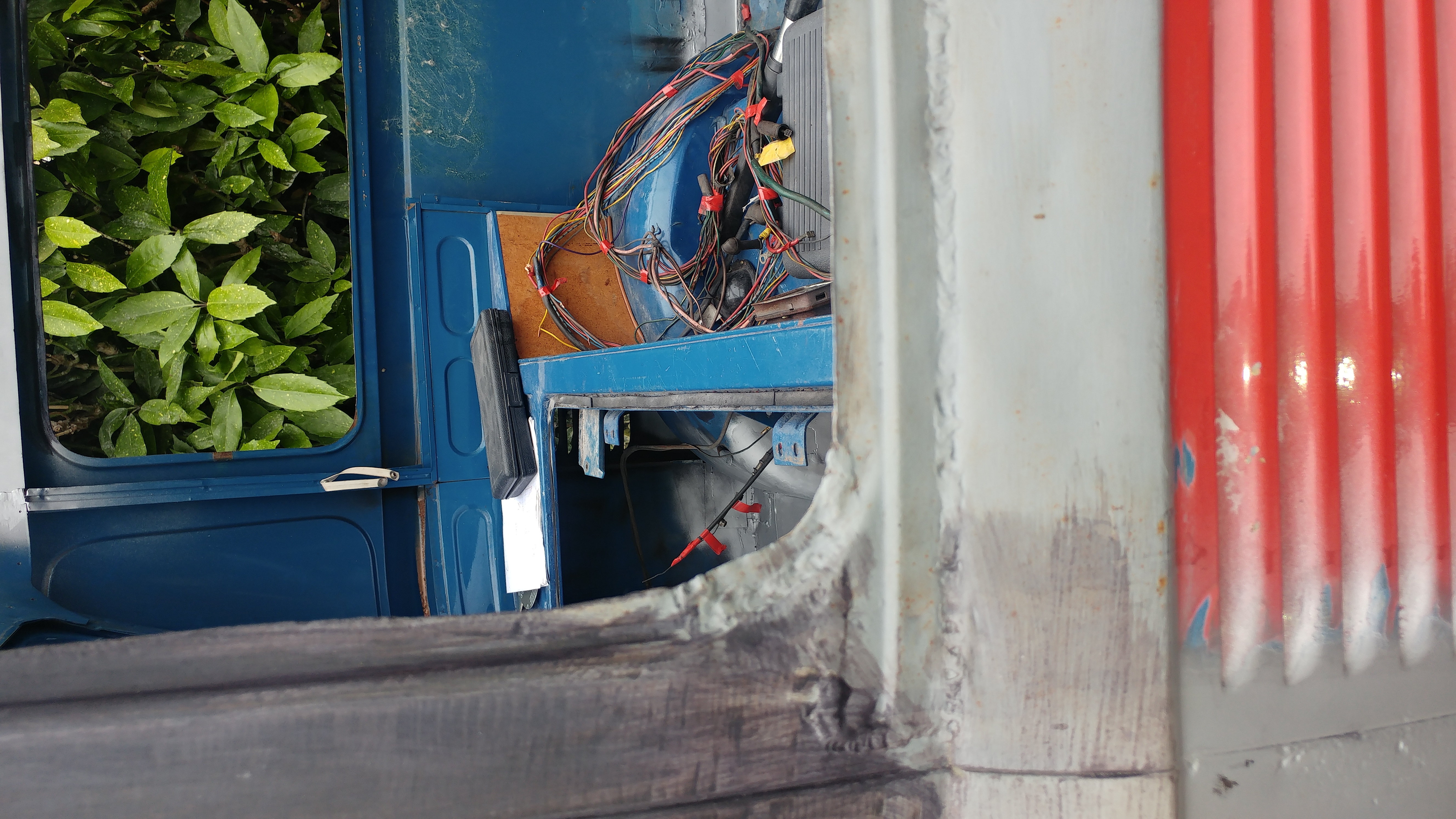

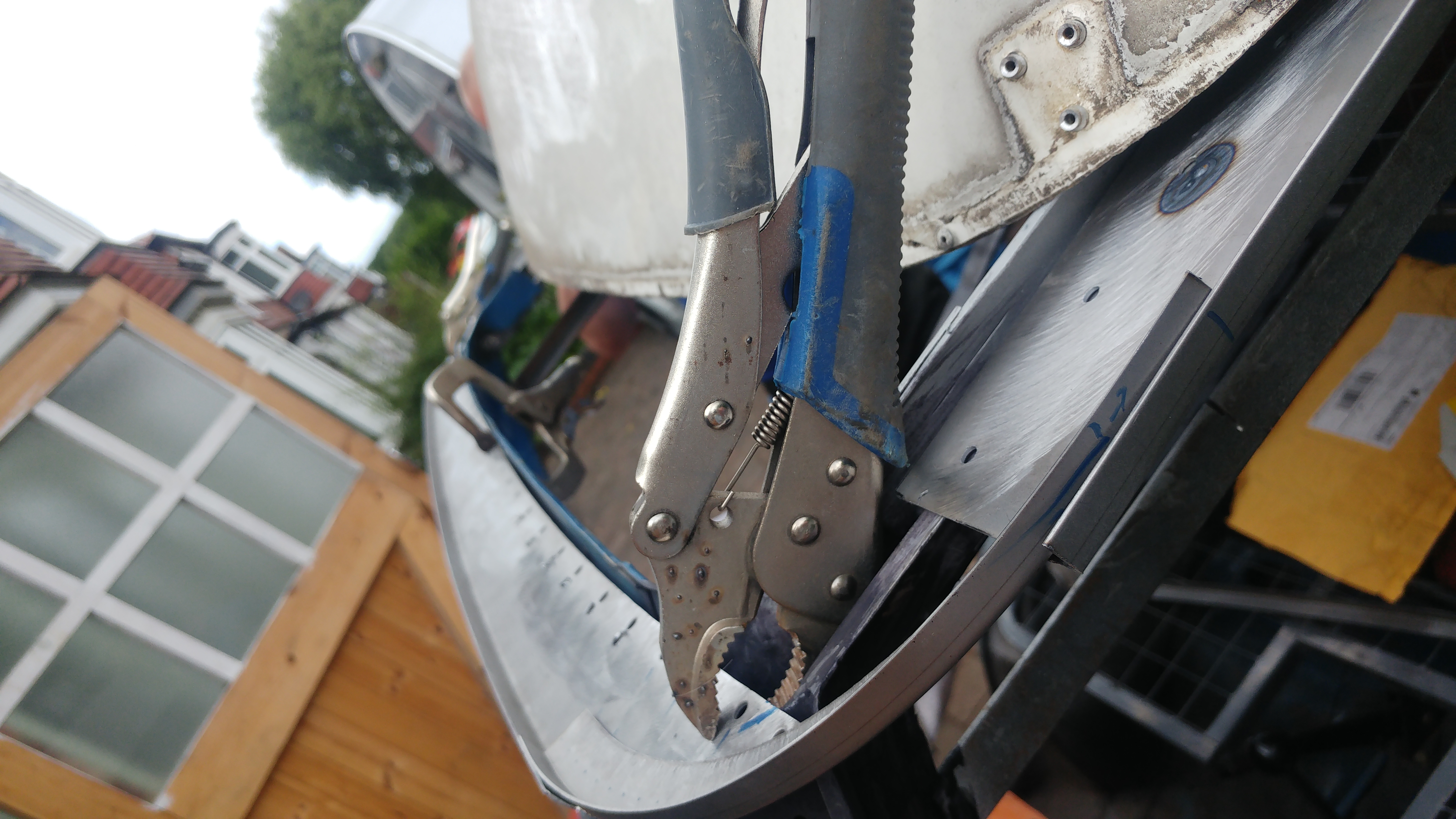

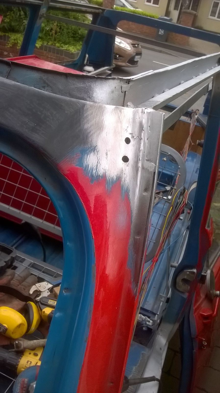

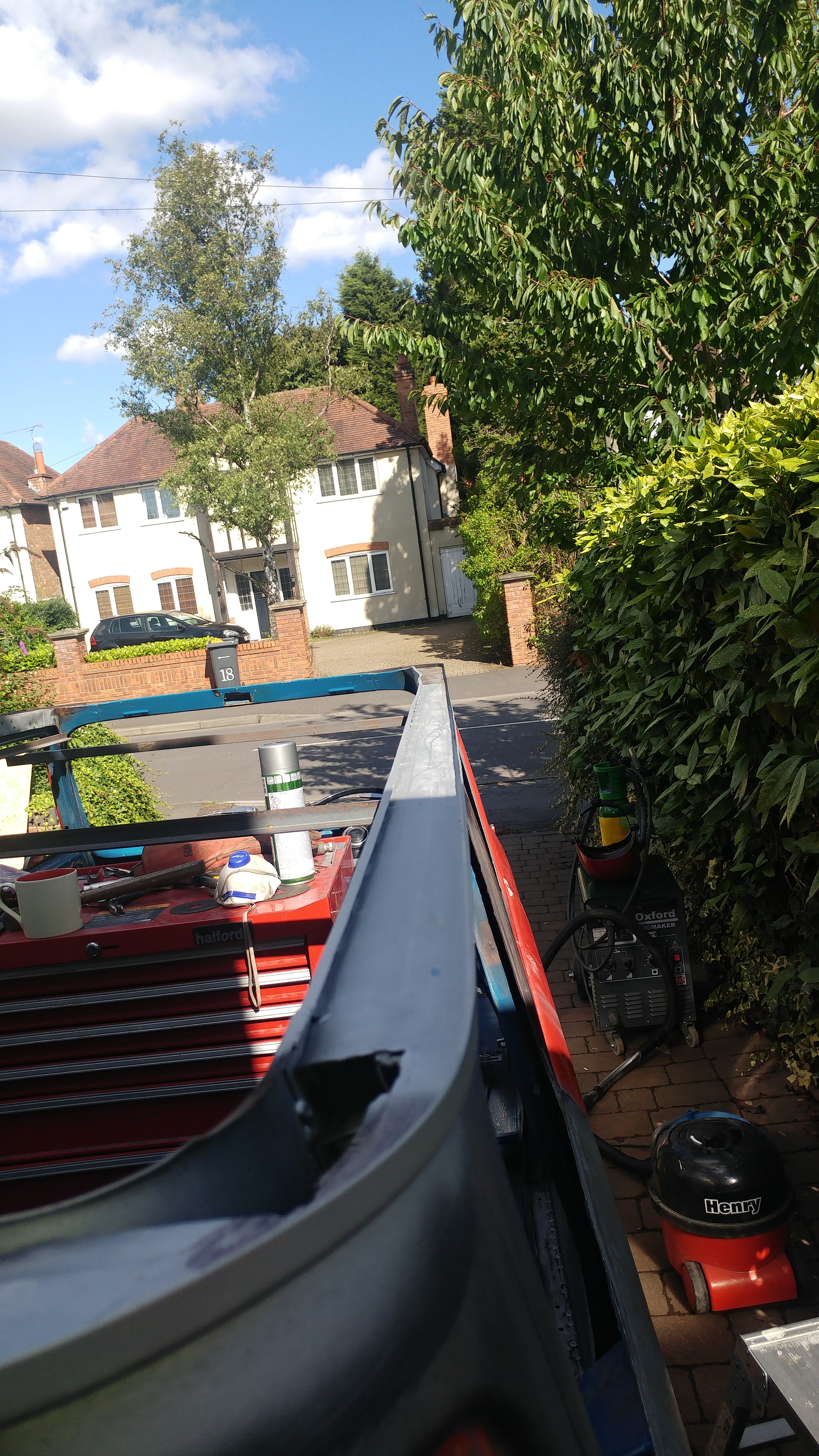

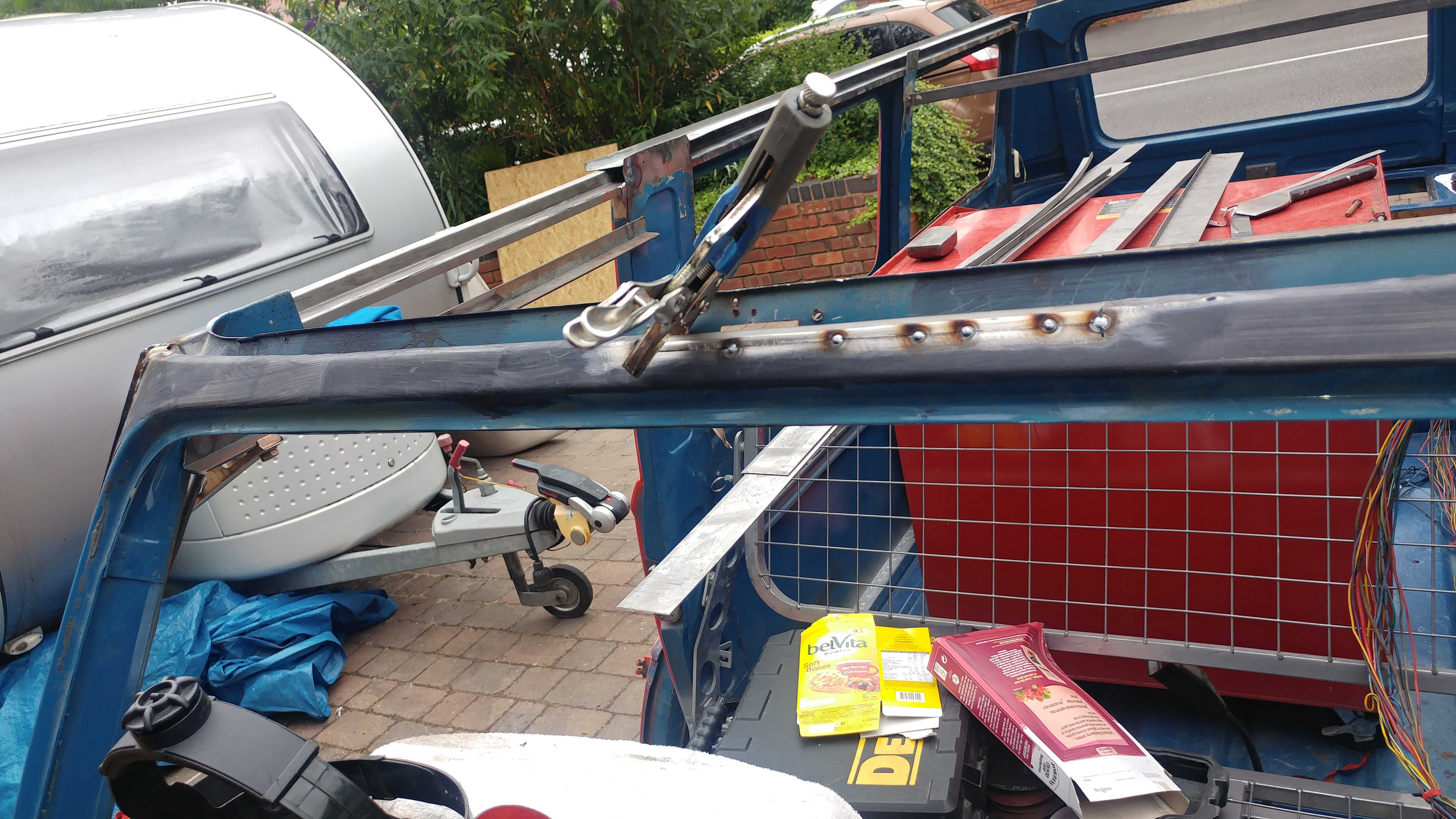

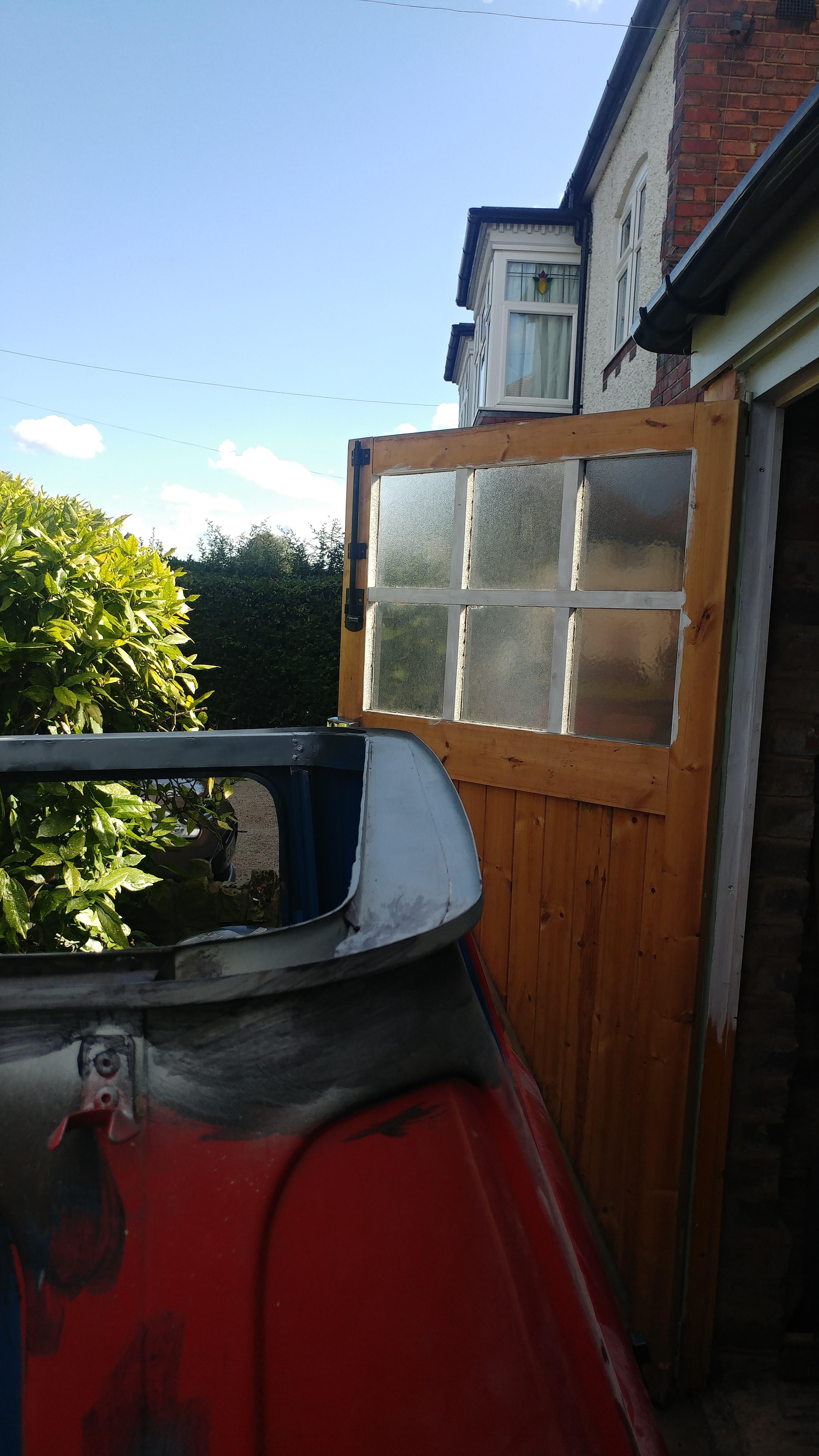

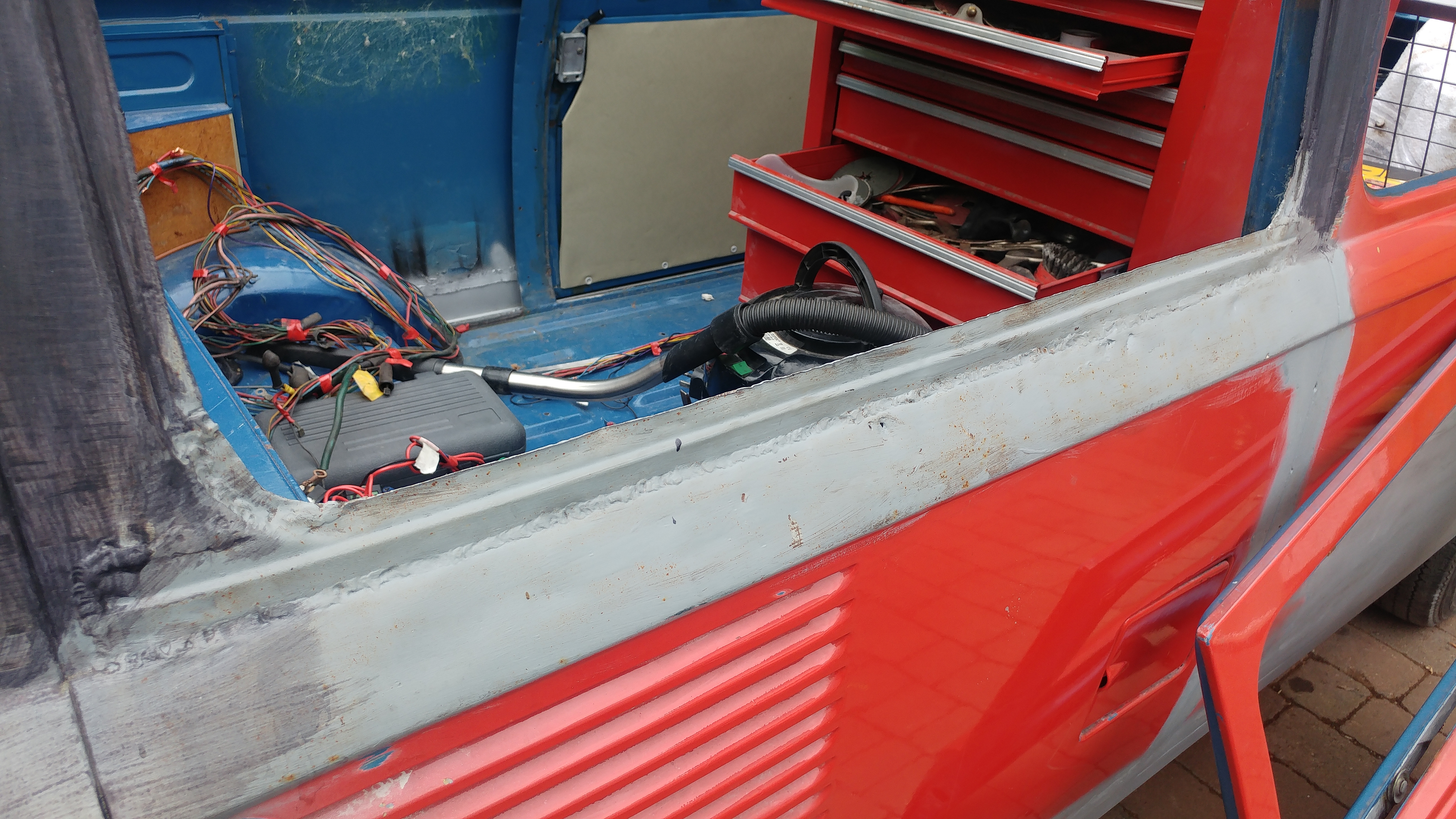

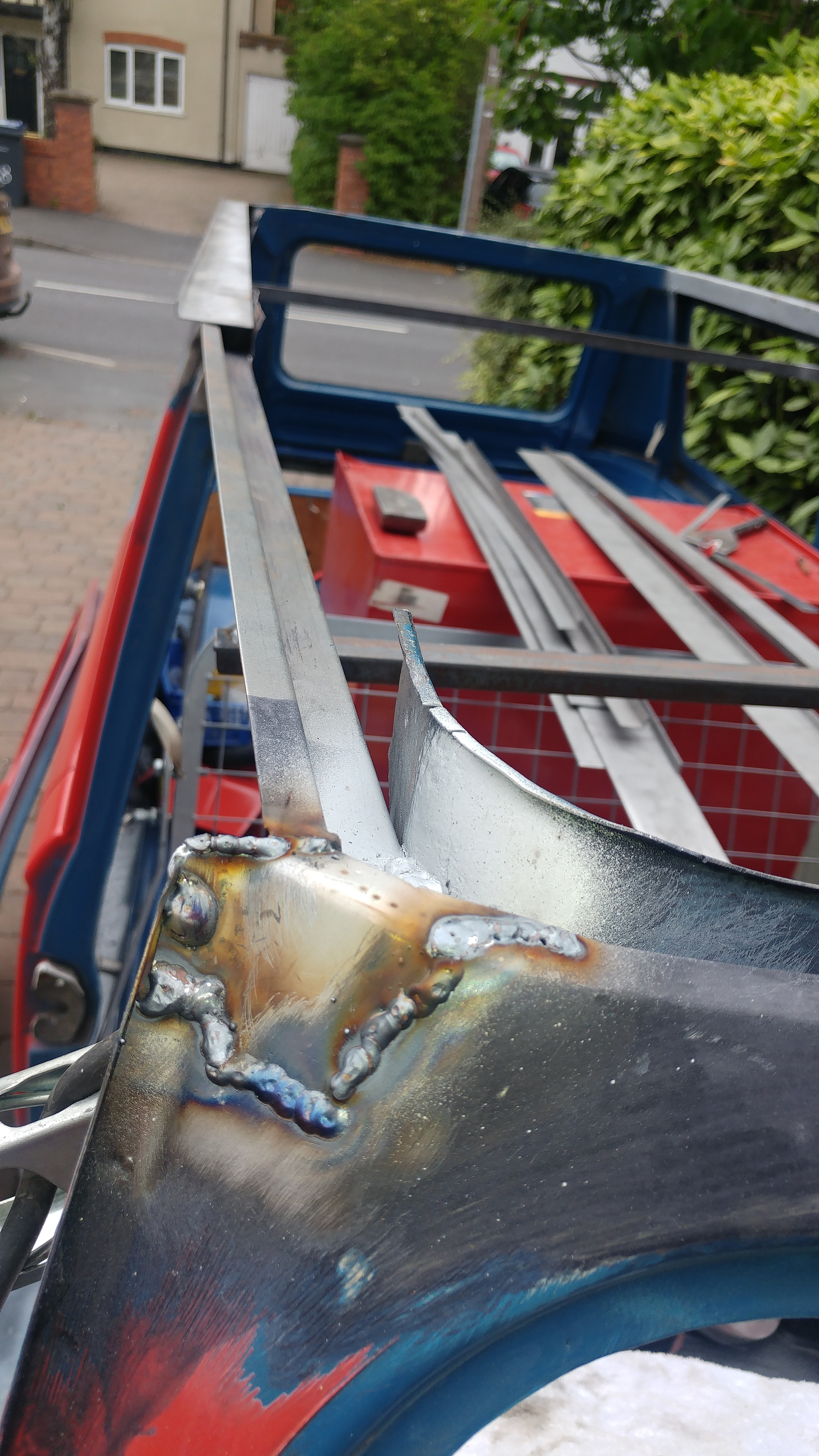

Been working on the new guttering this week. Progress slower than expected with rain and messing around to get the panels to fit. Also had to fit a few repair panels to the top of the A posts and the middle of the roof line above the front window, but things now starting to take shape.
We've exposed all the metalwork running along the roof lines now so know there is no rust left in there. :)
Really happy with the lines of the corner sections and the slight bend on the front panel. Shrinker/stretcher definitely worth the investment.
A week off next week so will have to wait to finish fitting the guttering.

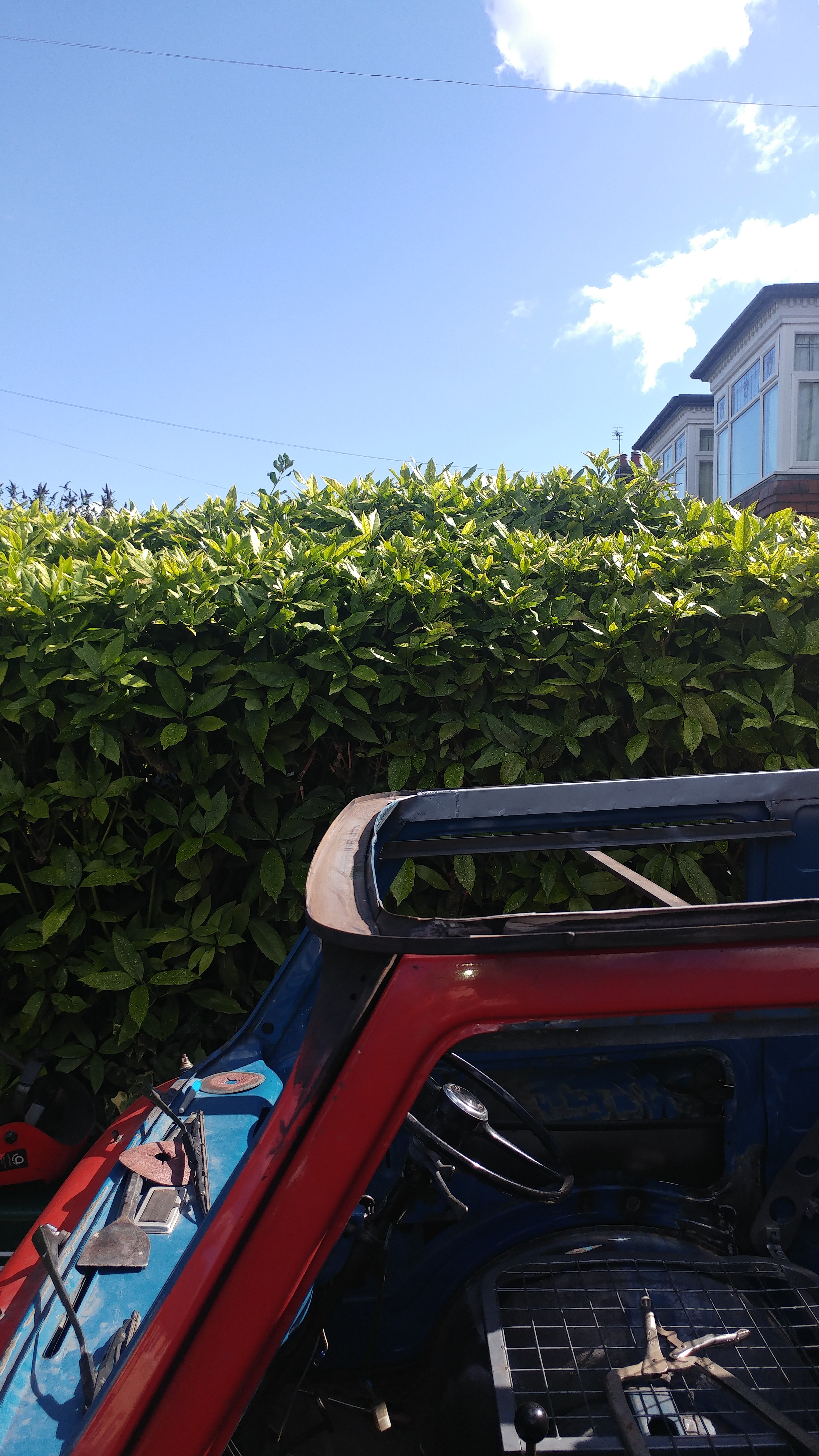

The guttering does look good. I dont have it across the front of the screen as it heads straight down the door-front.

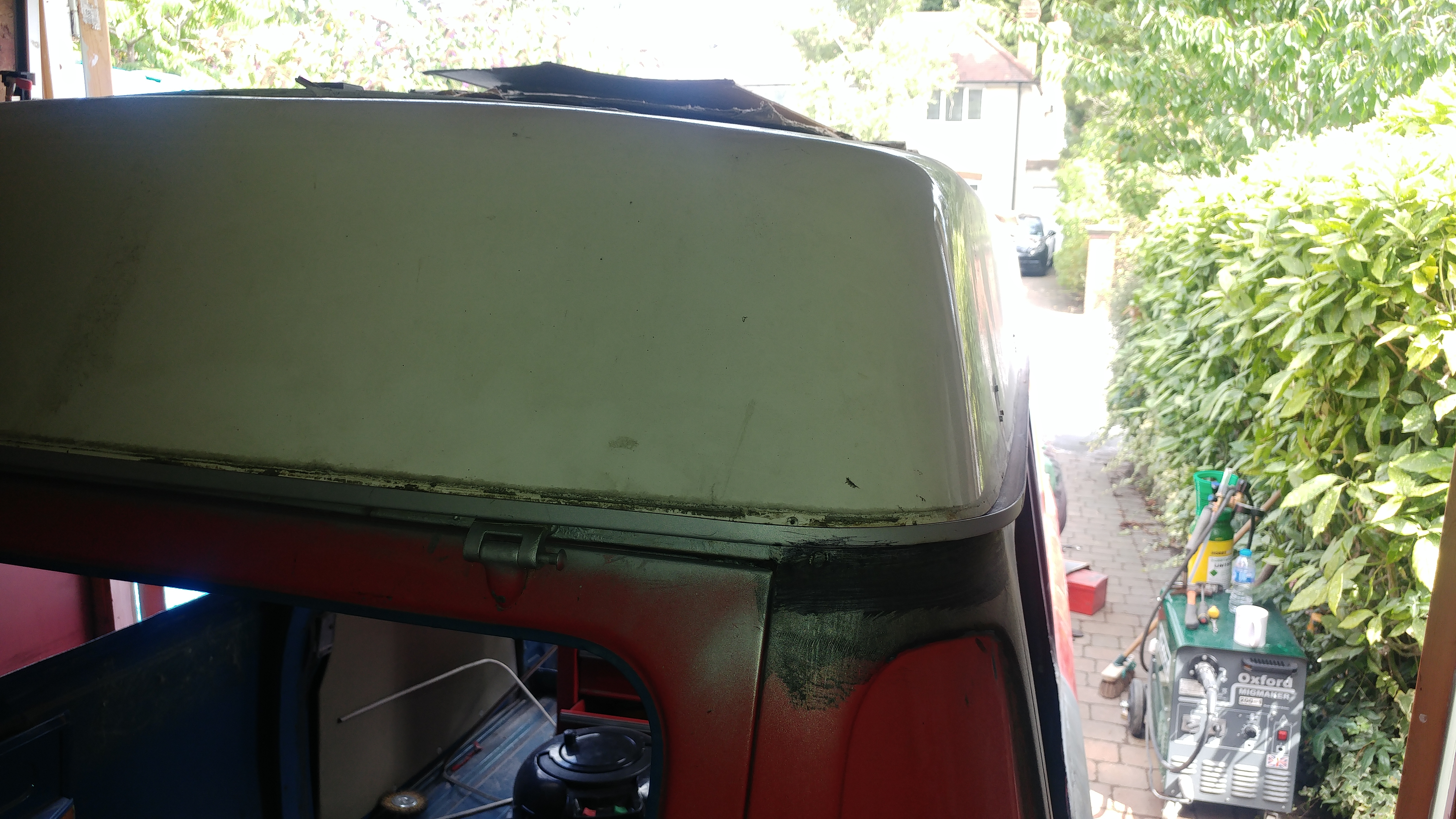

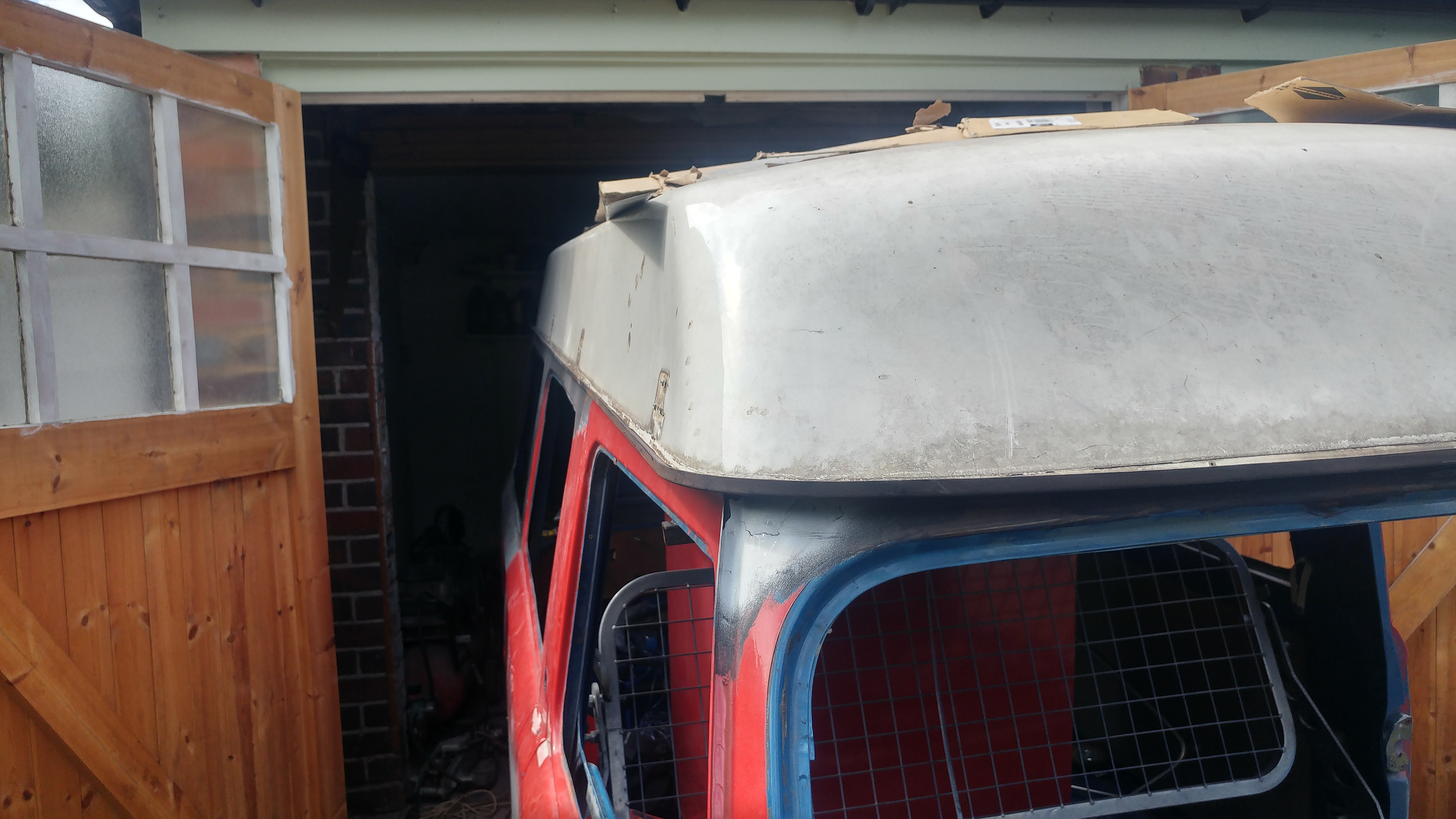

On the fibeglass roof, what do the hinge-rivets get a purchase on? Is there a steel plate behind?

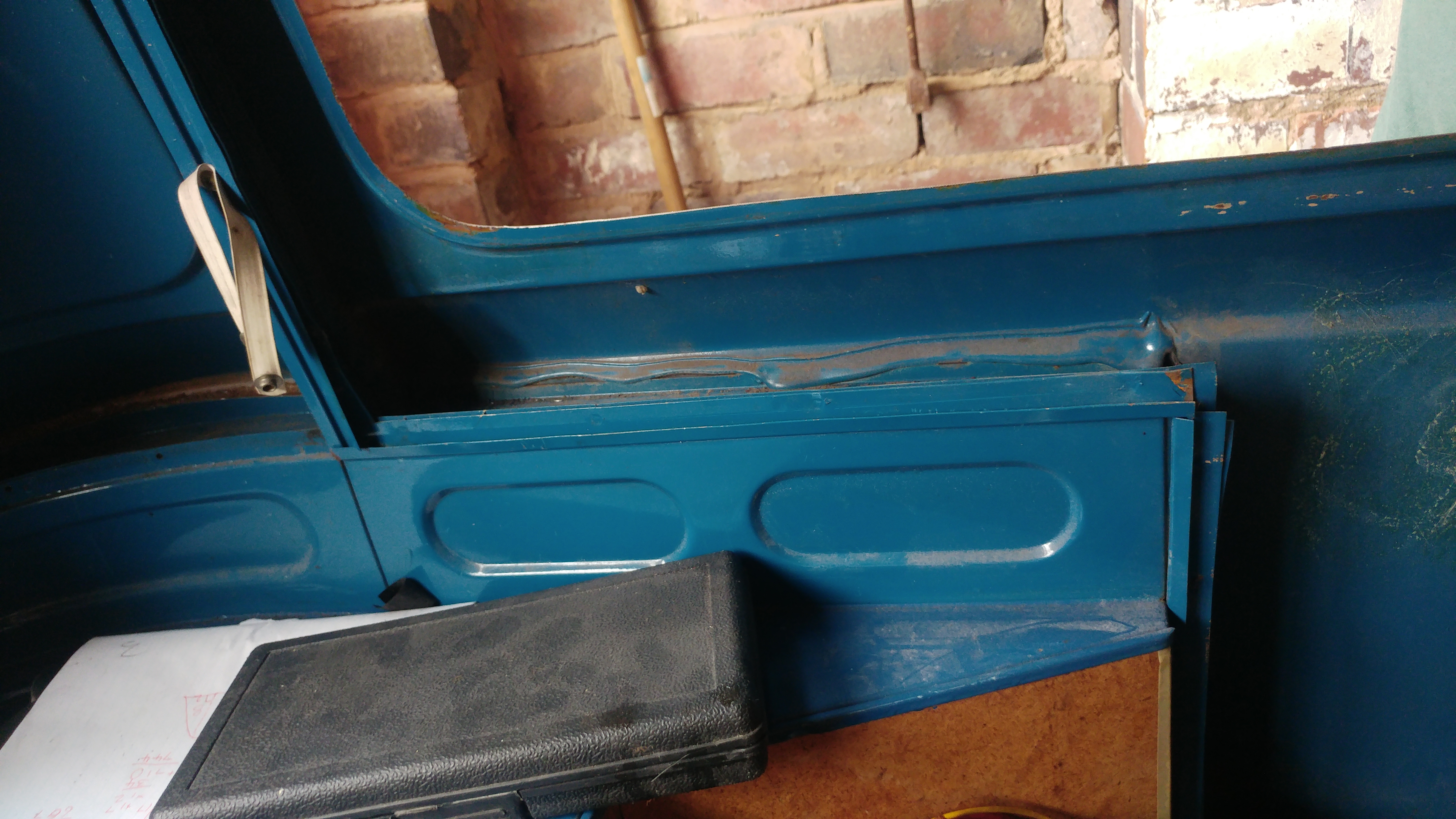

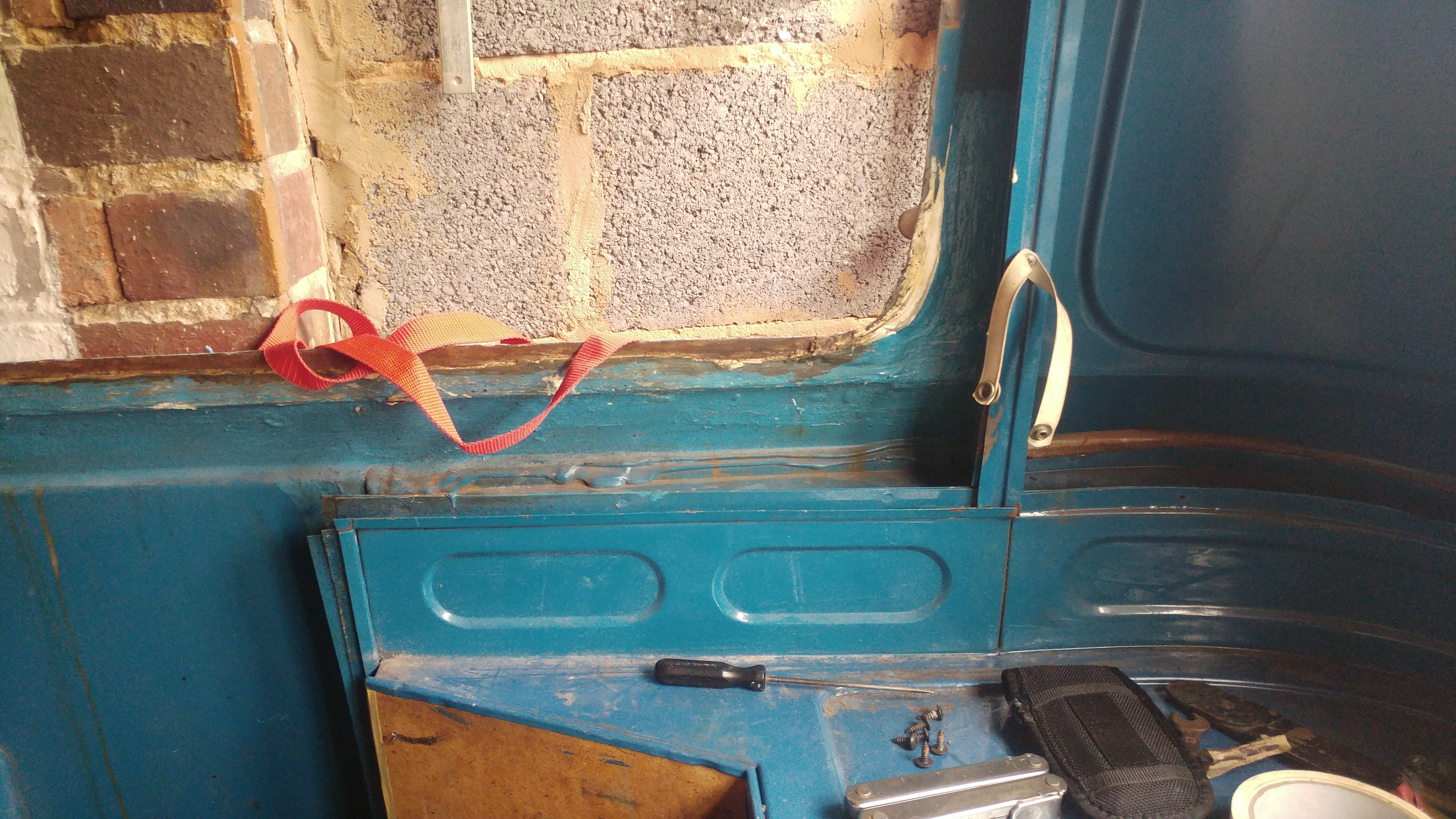

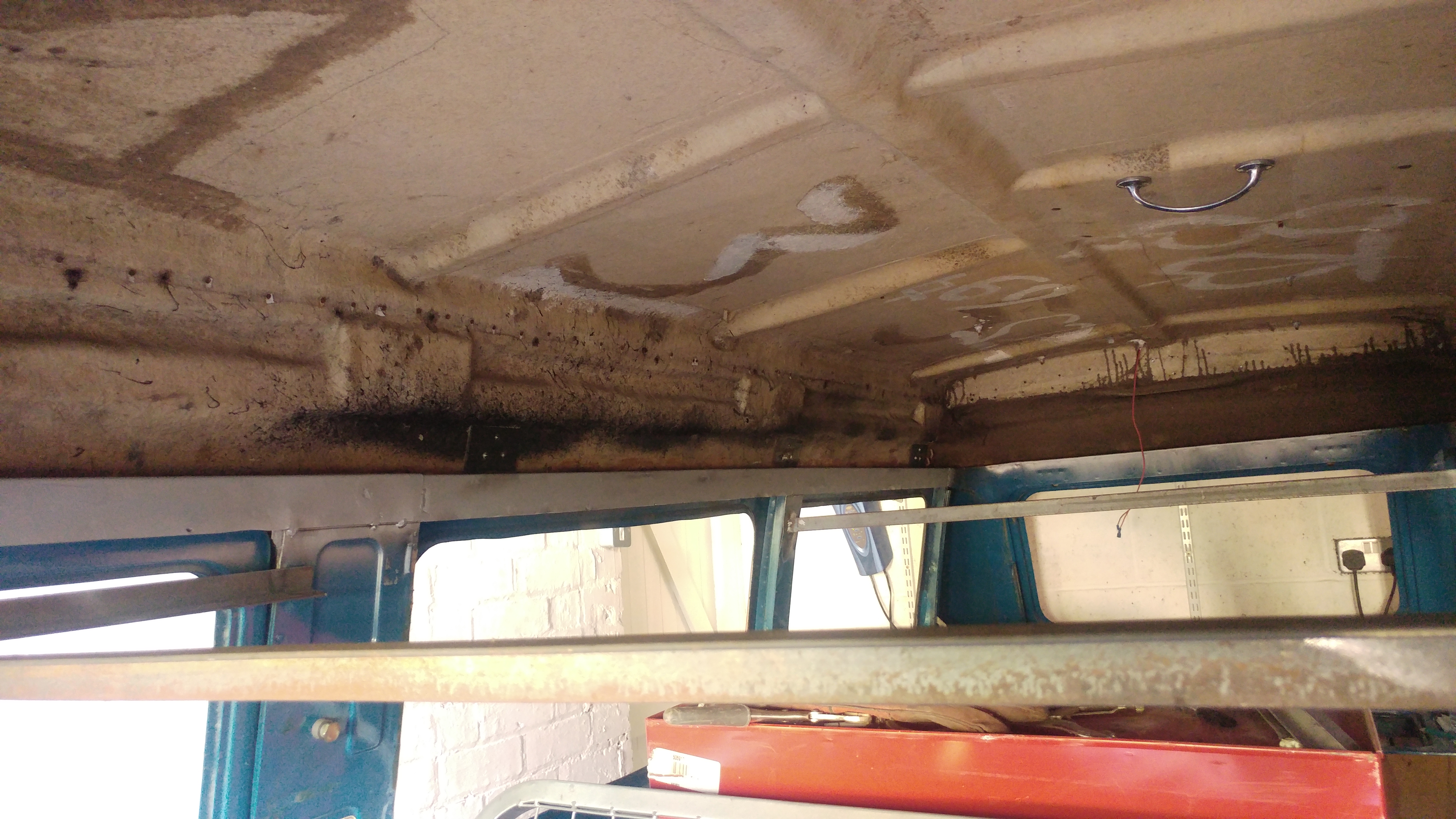

On your van, the internal, square-topped constructions that act as a kind of cowling above where the louvre-vents go appear to be parallel with the window aperture. That worries me because on mine they seem to be at a slight squint to that datum. If you understand what I mean it would be helpful if you could confirm or deny please.(y)
The hinges were pop riveted on to the roof, the hinge on one side of the fiberglass and a steel plate on the inside. Not sure what else is inside the fiberglass to strengthen it but judging by the weight there is something fairly solid. I'll have a closer look next time it's out.
We're thinking of changing the roof to lift straight up rather than to hinge as it should give us a little more space but we'll wait to decide until the inner roof has been built.
I'm not sure what you mean by "the internal, square-topped constructions that act as a kind of cowling above where the louvre-vents".
Peter
Do you mean these?
It's hard to see by eye as there is a thick run of sealant along the joins and the drivers side panel is a bit of a mess.
On the passenger side, measuring from the top of the box to the bottom of the lip on the window there is a difference of 4-5mm (lower at the back than the front).

Thanks for that info Andy. Hard to explain the bit I'm on about, but on the inside at the rear at the sides of the raised part of the floor there are those very complicated bits of metalwork that make the whole construction into the shape of a very uncomfortable armchair. So it's the "chair arms" I'm thinking about....at the back of this picture with the two oval pressings. They look like the tops should be parallel with the window frame but they are set a an odd angle to it on mine and I dont know if this is normal.
If you want me to take any measurements for you to check let me know.
Thanks Andy..take a break from answering my questions.:D:D
That's solved a little worry I've had for quite a while.:thumb
