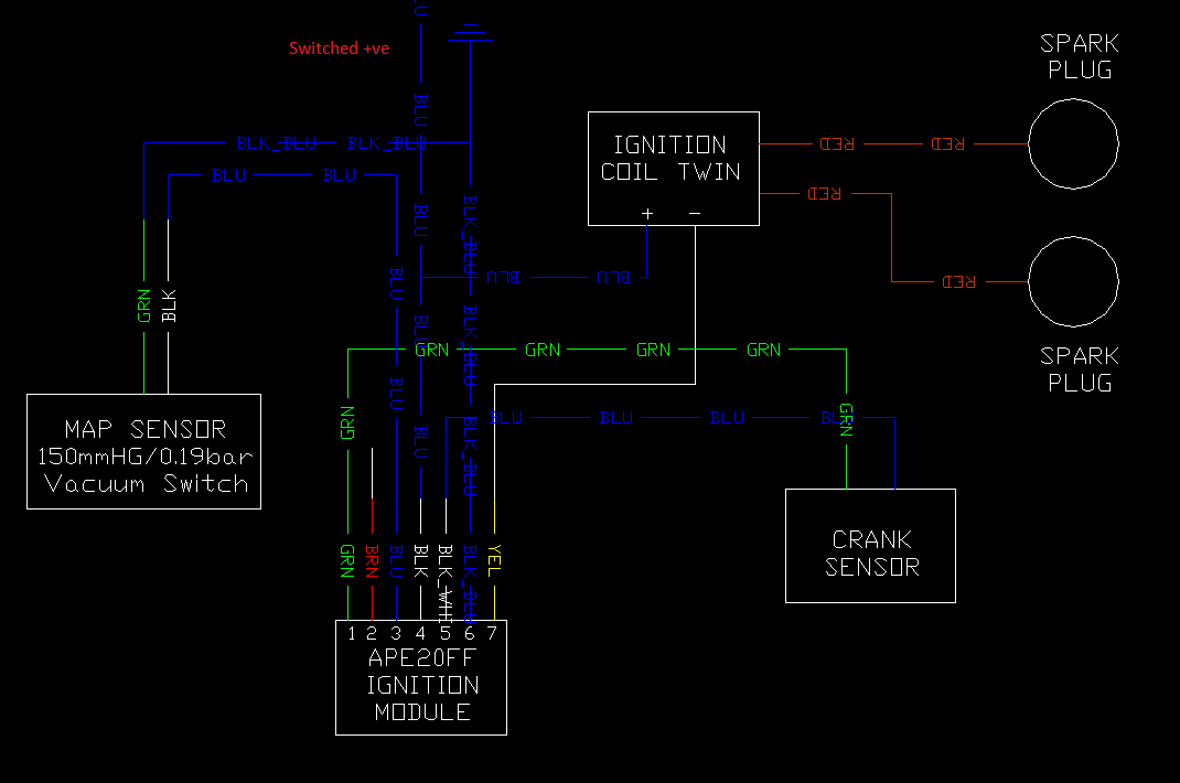

I put together a sketch for my distributorless electronic ignition - it's for an uprated APE20 twin spark ignition module but shows how the wiring inter-relates with the various components. The wiring colours are non-std as I'm doing my own loom but the switched +ve wire shown is the same as the coil 'B' wire on a normal distributor set up so minimal re-wiring is required. The original Regulator and Generator wiring isn't affected.
I must add that the car is still in bits and I've not run the engine yet so no guarantees that the wiring works - although I get the twin sparks from the plugs when trialling it which is promising.
That's really useful thanks for that. On the diagram you show a wire on pin 2 that seems to go nowhere. The diagram I have shows it with nothing but on the plug I have it has a wire on it, but I have traced it through the loom to see where it goes?
Did you have a cut off box with your set up? I believe it is not required.
Tony
IIRC pin 2 is for diagnostics.
No cut-off module in my setup yet although I still need to follow up on what it is and whether it's really necessary (n)
