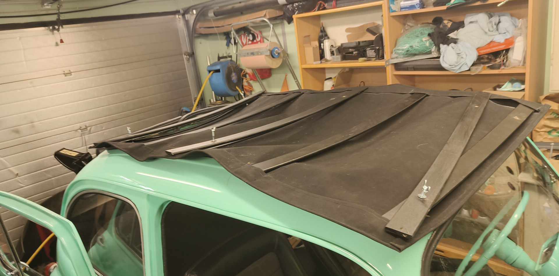

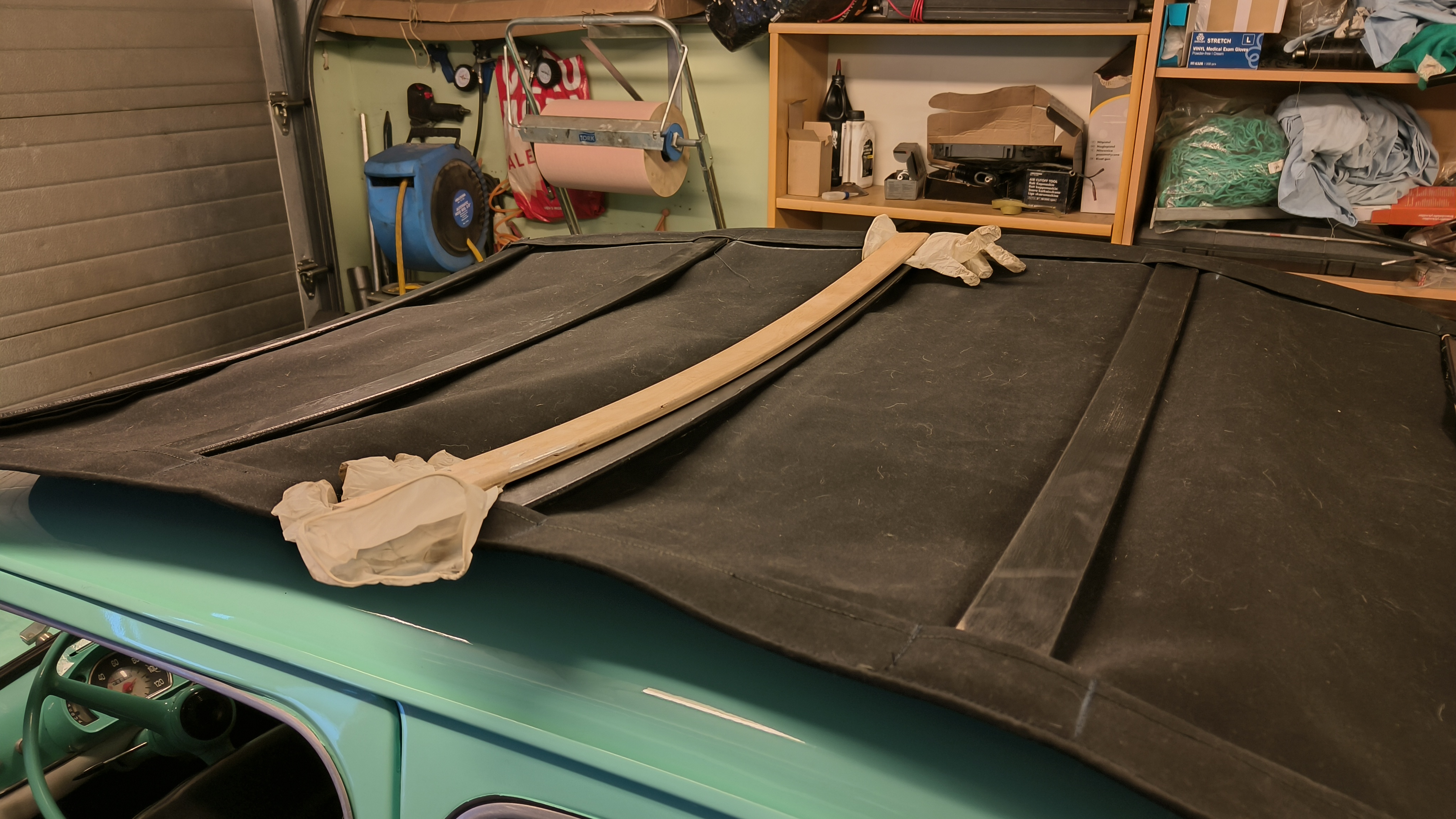

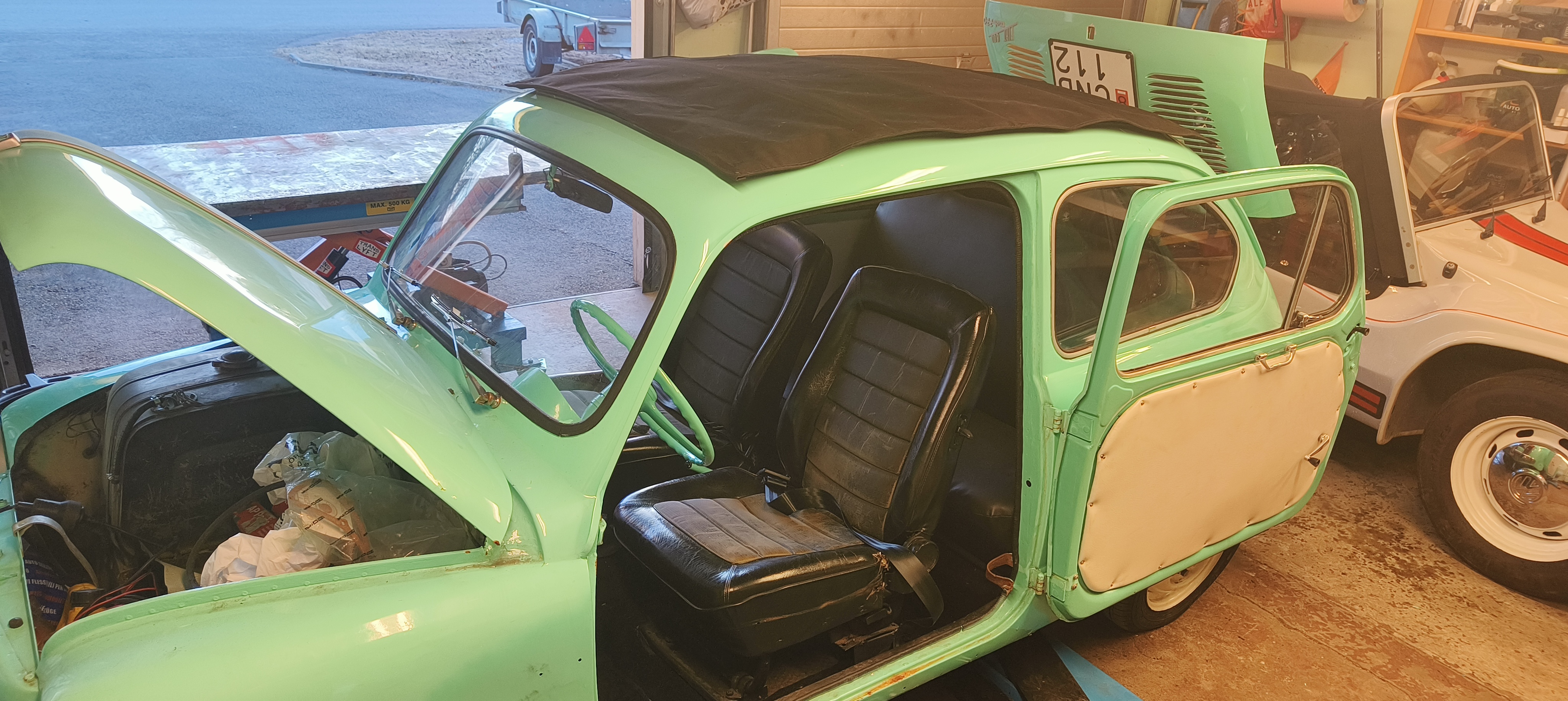

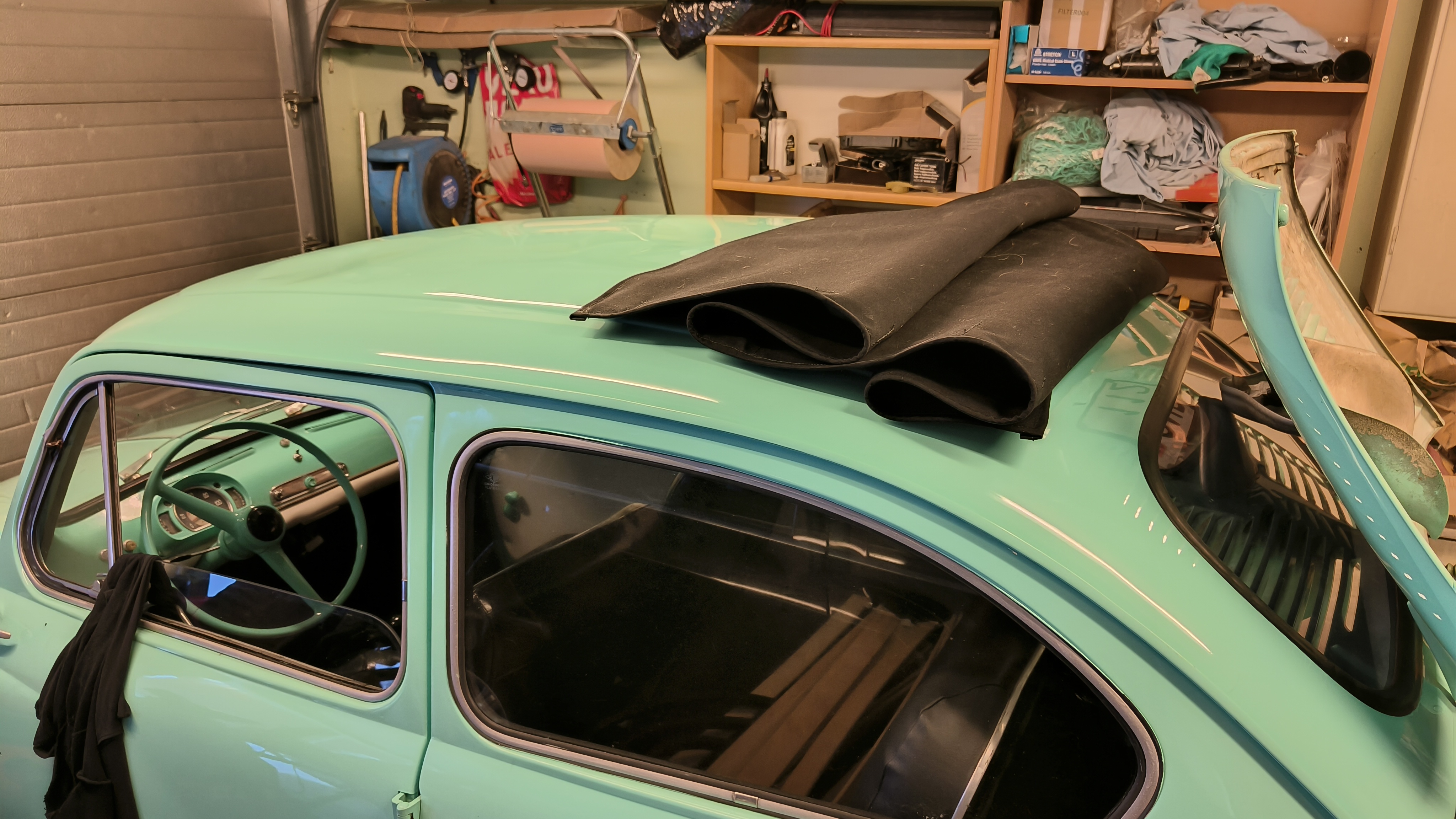

Sandwich the roof like the gloves in the picture

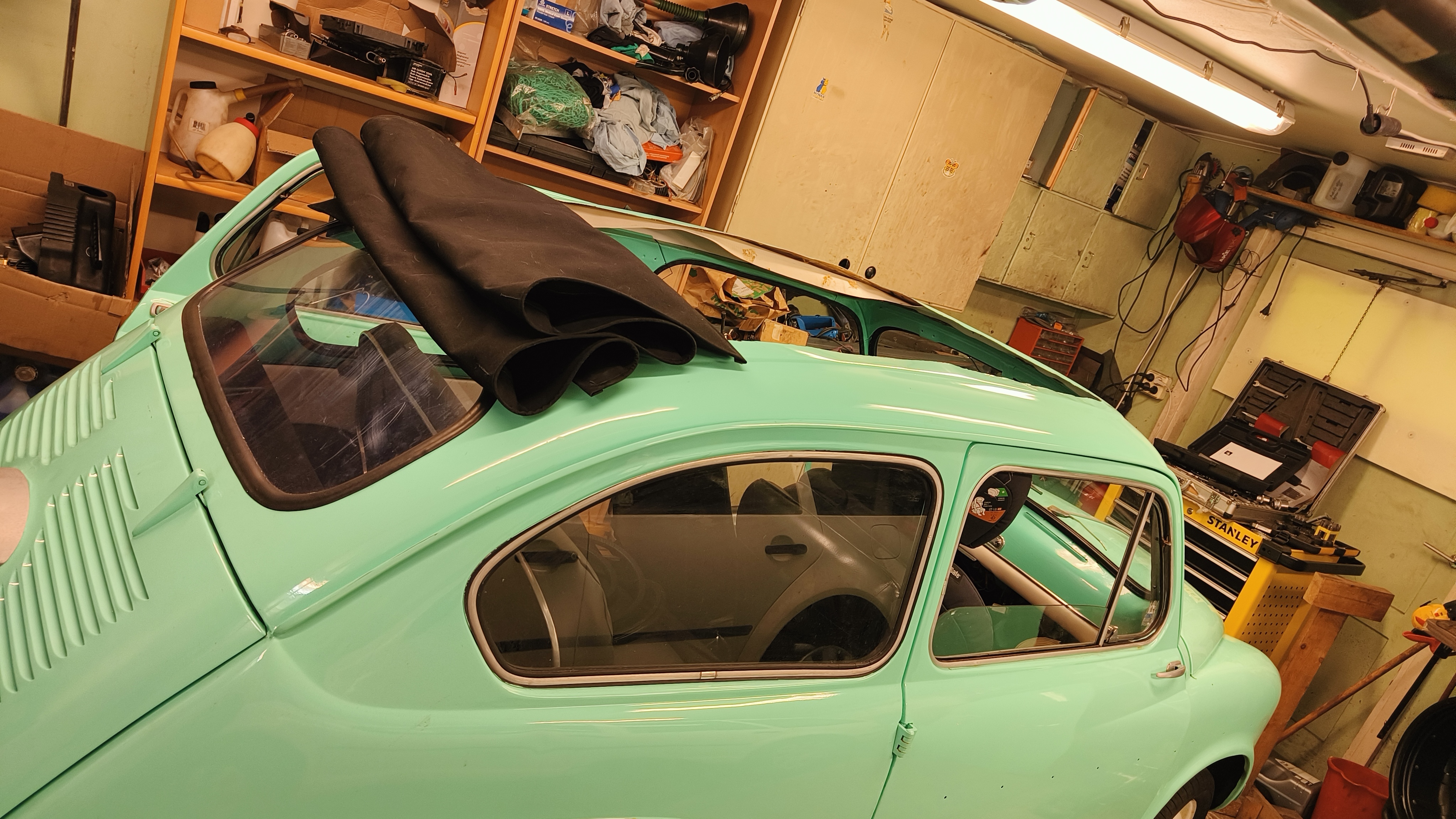

Looking good, keep the photos coming. Not had a chance to use mine yet as weather been bad and I'm fitting a kitchen at my daughters. I've also fitted a new carpet in the car so need to finish that.
much easier to explain with the pictures
I'll try it out before shortening the slats or opening up the hole wider

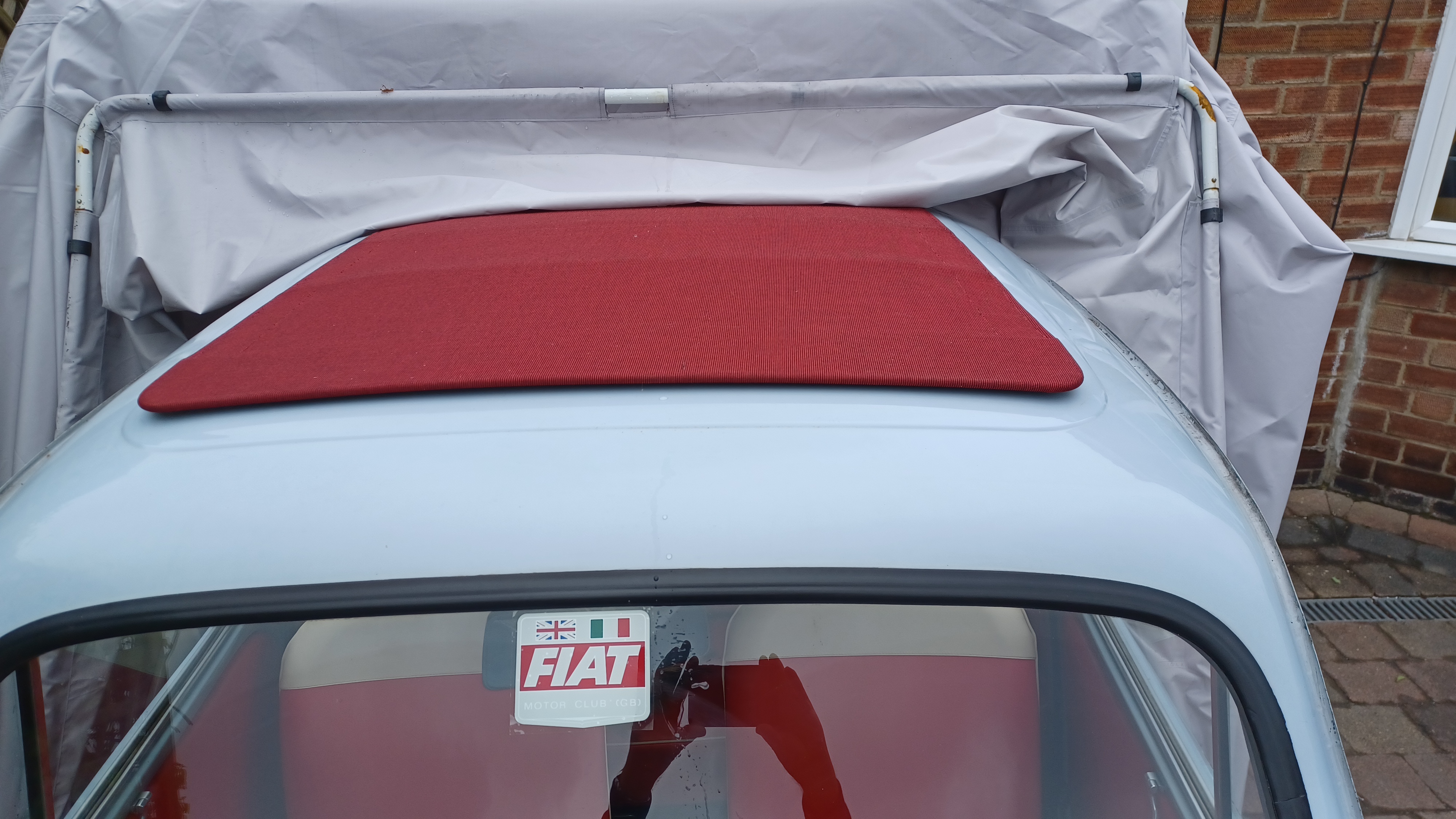

Tim with regard the Legacy top its good quality but don't buy the one they advertise for 600 as its too big. The one I ordered in the end was 32" width and 40" length which fits the indent pretty well.
Only issue is it's not as curved as the roof but near enough with a bit of help. Colour is
SeaMark Dubonnet Tweed Canvas​
which is more a maroon than red but good quality with black lining.
I'm happy to send you any photos or advice you want to help you, good luck.

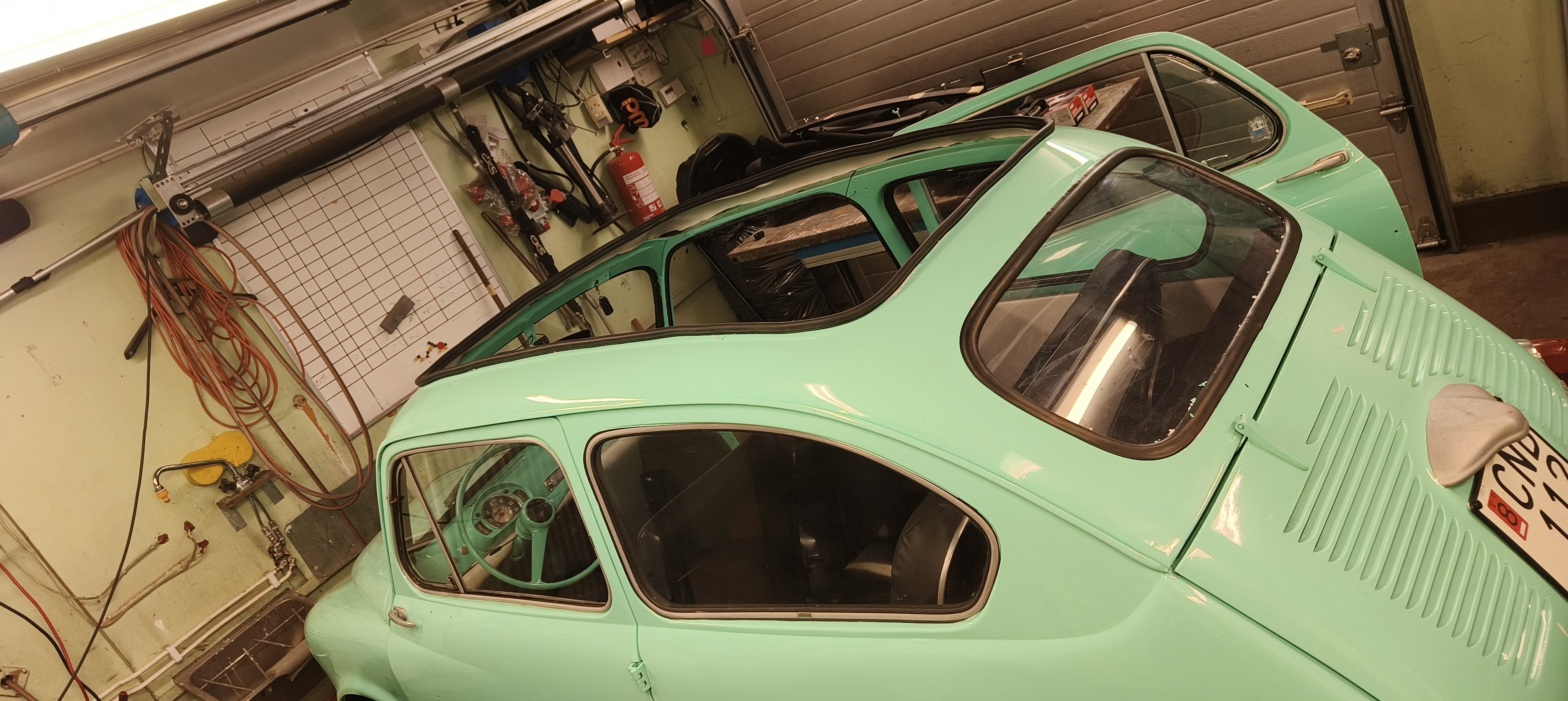

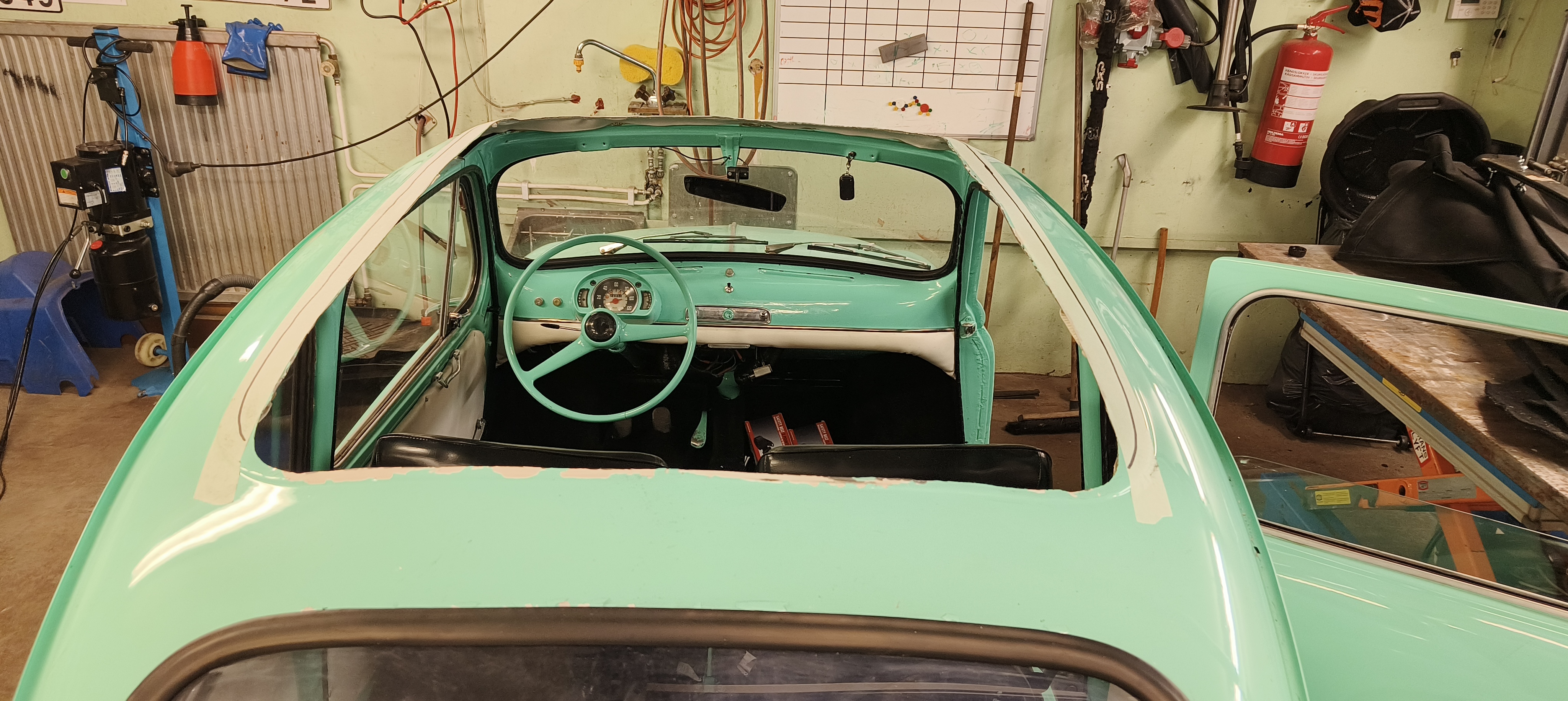

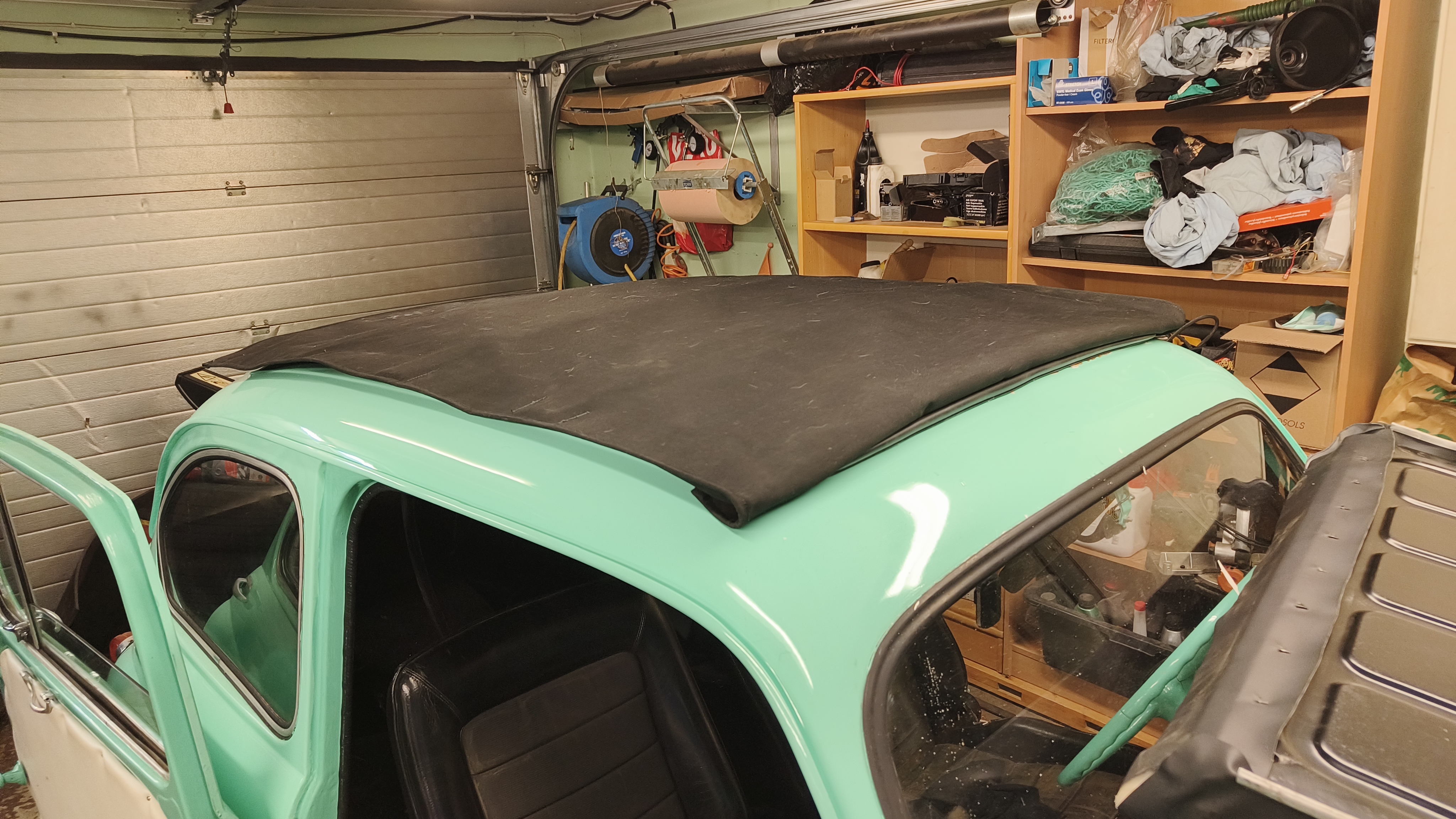

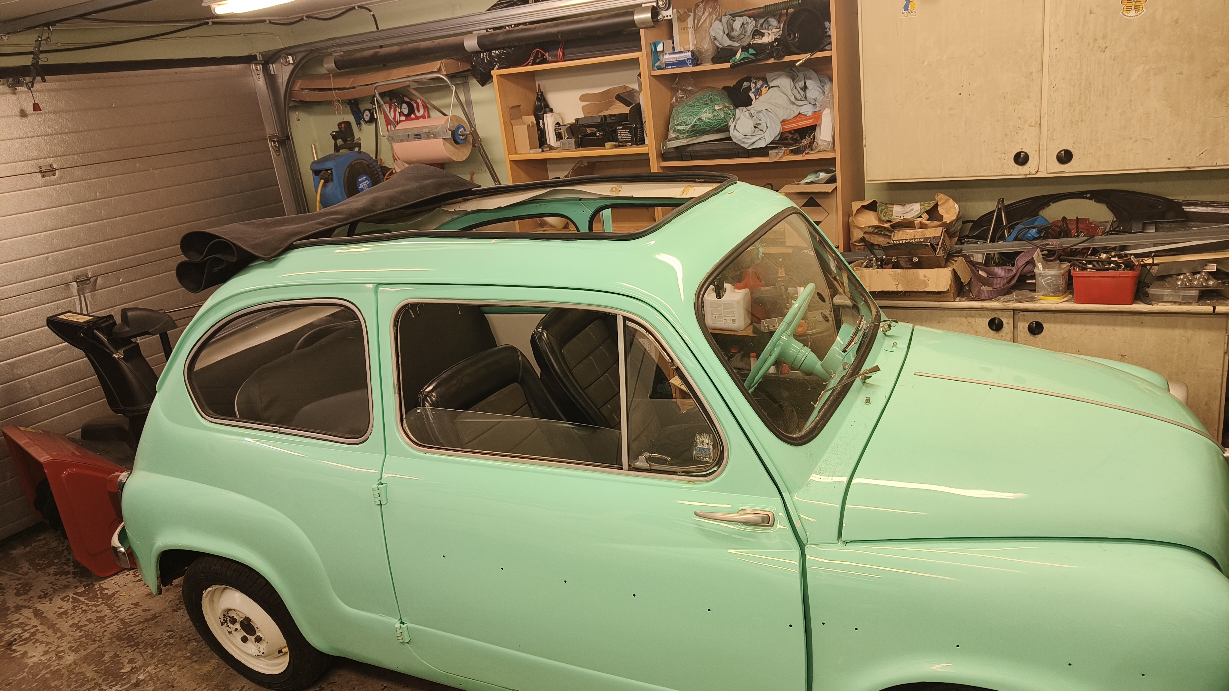

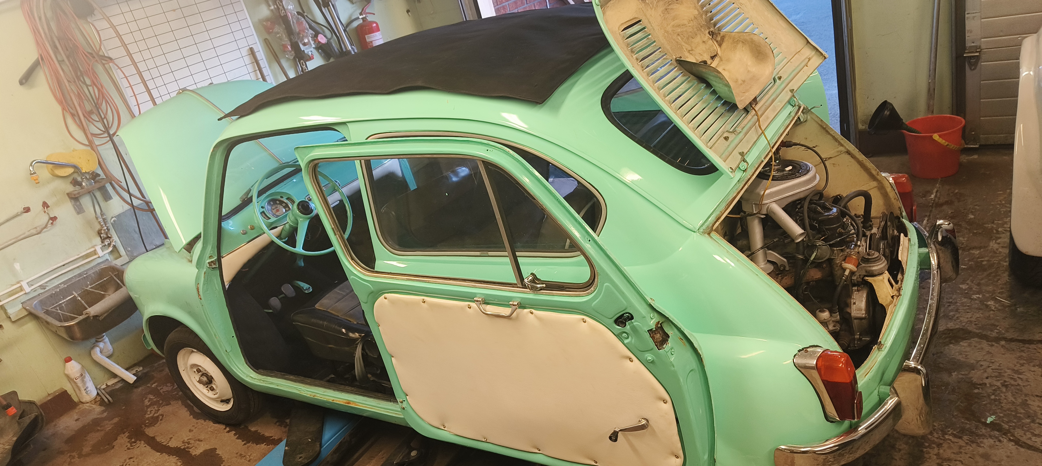

Finally opened up the size I planned to do in the beginning. Mounted front seatbelts and did a motivational start 😄

Just re measured mine its 32" × 41" to outside of cover.
I've attached photos so you can see how it sits relative to roof indent.
Legacy's larger one overhung the indent and with the curve at the back it didn't sit down at corners.
40" would allow it to be located before the curve gets too severe.
Just my thoughts though.
