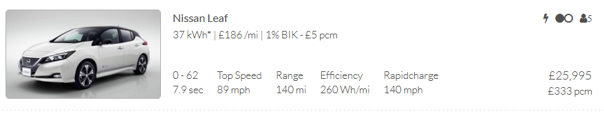

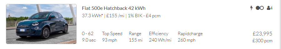

Some interesting basic stats below (taken from ev.database.uk) for the 500e, Leaf and Tesla (click to enlarge).
My guess is that Fiat's claimed 199 mile range is about as achievable in the real world as the claimed mpg figures for the TA. Whatcar's experience of 140 miles from full charge to stopped is probably right on the money; reviewers on test generally return figures at the lower end of the real world results range.

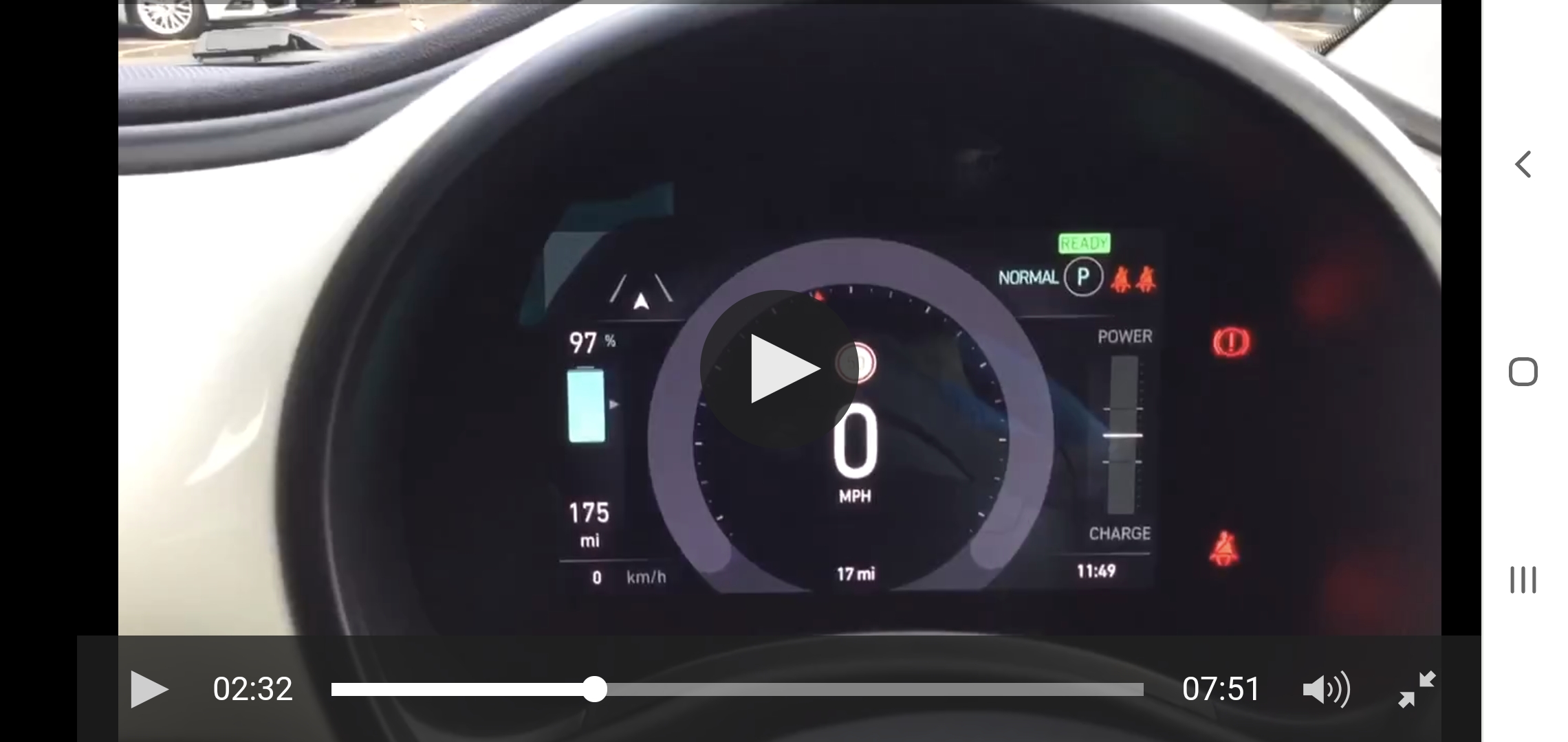

I’m not sure that is enough to explain the difference between Fiat and the European models showing 199 miles and all the UK ones only showing 161. I bought mine in the summer and it always showed 161 at full charge and it has been showing the same this colder week too.
Similarly my Tesla always shows the same range at full charge. Admittedly, the actual range you get is less and varies, but the suggested range at full is pretty consistent.
It seems to be something else and can only assume Fiat has made changes to reduce the range, maybe only in the UK?
It is a massive difference between them claiming over 200 miles and then the car only showing 161 in Sherpa and 143 in normal. When you consider in normal mode you will probably only actually get about 80% of those miles, so a realistic 115 miles is a shocking difference when they claim over 200 is achievable!
