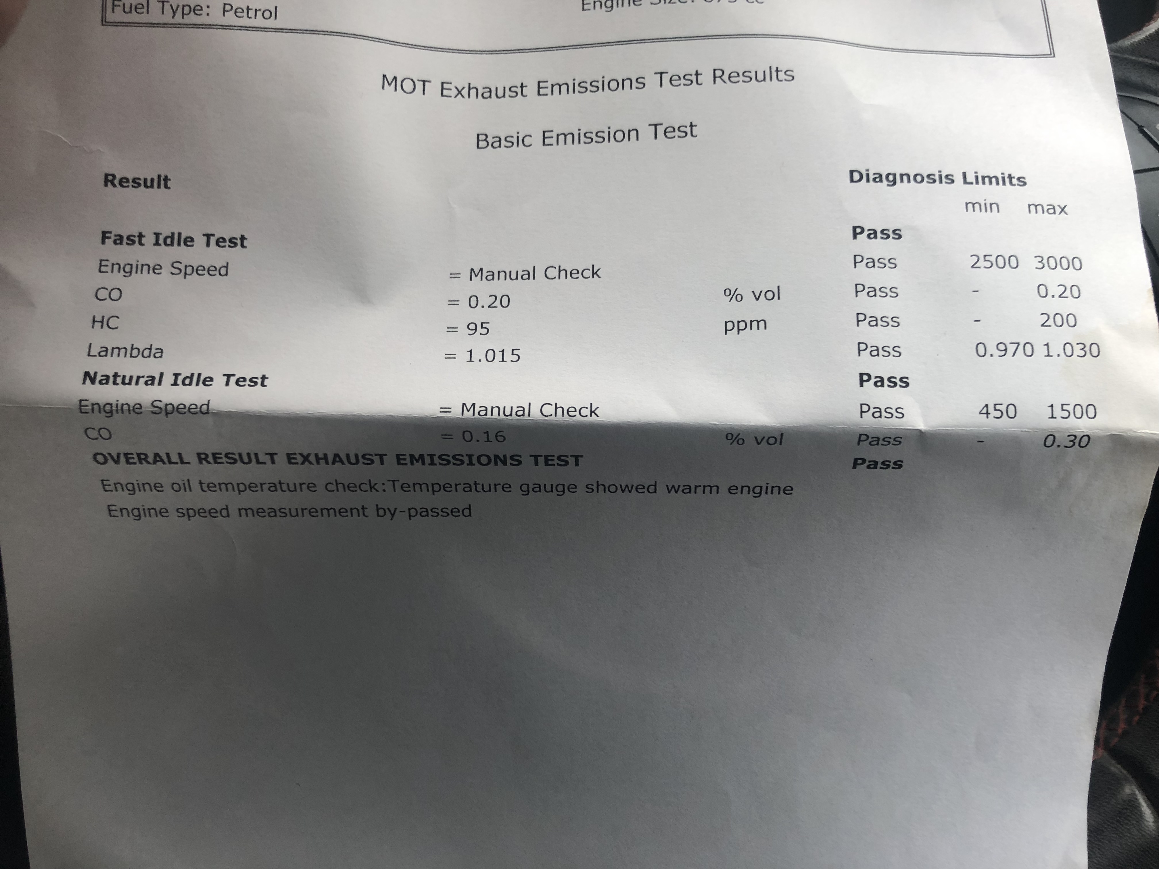

I have a 500 twinaitr - ace car, I love it.. however, after having it 6 months of owning it second hand, 46000 miles it started to develop an issue. when the car is started from cold - it starts everytime, but if I drive anywhere before the engine temperature guage has turned from blue to at least 2 white bars it will struggle when I put the clutch down when approaching a junction or to change down gears, stall and not restart until ive put the car through 6 or seven starting cycles.
I had a mechanic look at it who found no faults on diagnotics. He changed the engine temp sensor but no change to the faulty.
I changed the spark plugs and this fixed the problem for around 3-4 months. I have done this 3 times now, each time its ok for a couple of months then the problem is back.
The plugs come out with a fair amount of carbon on them. more than I would expect for a 2 month old spark plug.
does anyone have any ideas????
