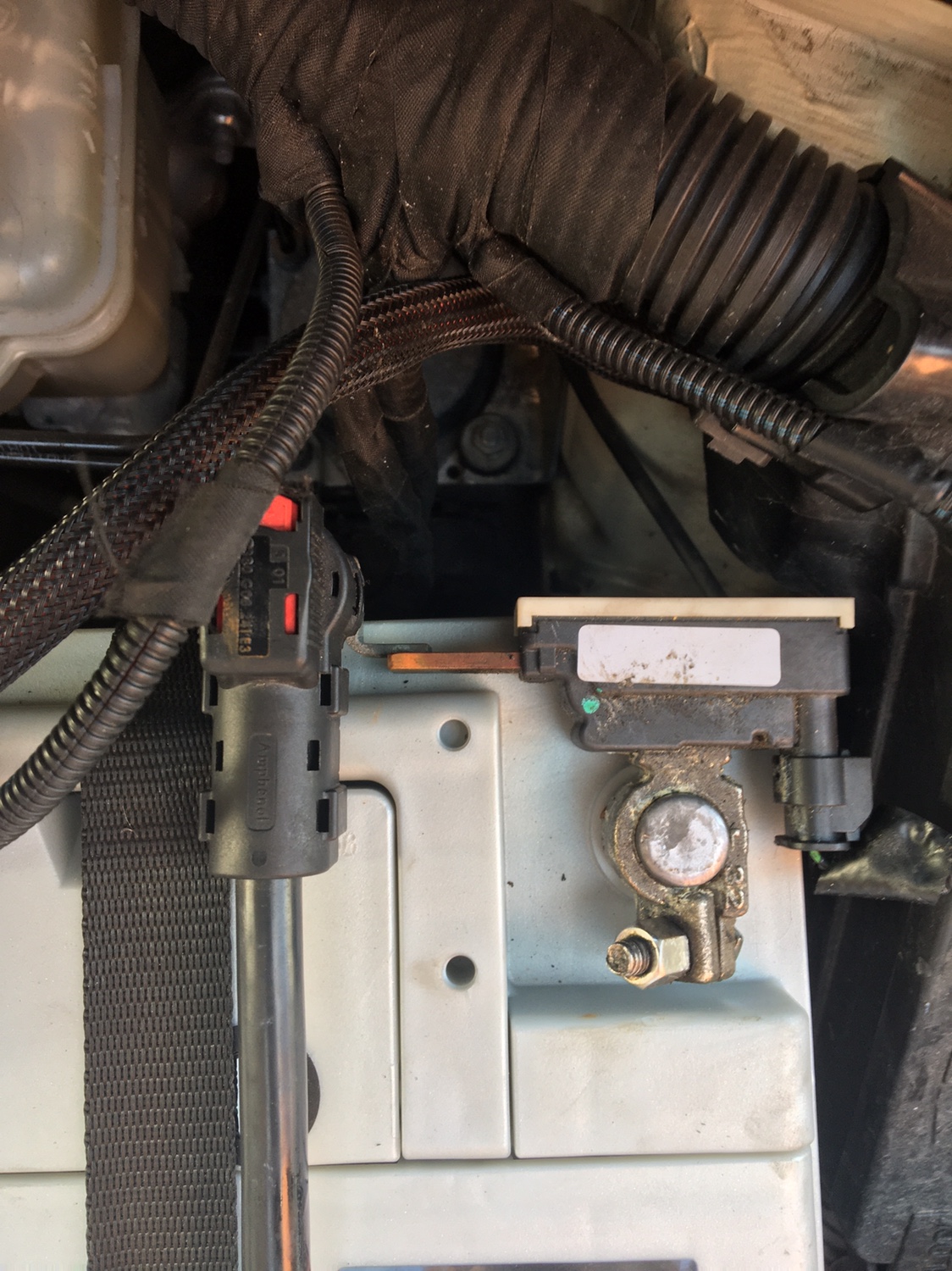

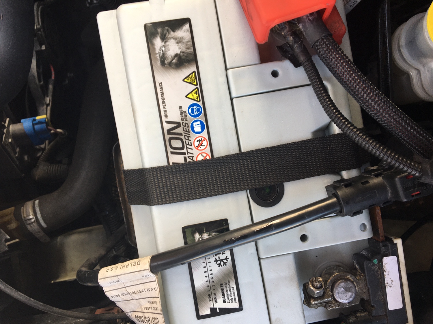

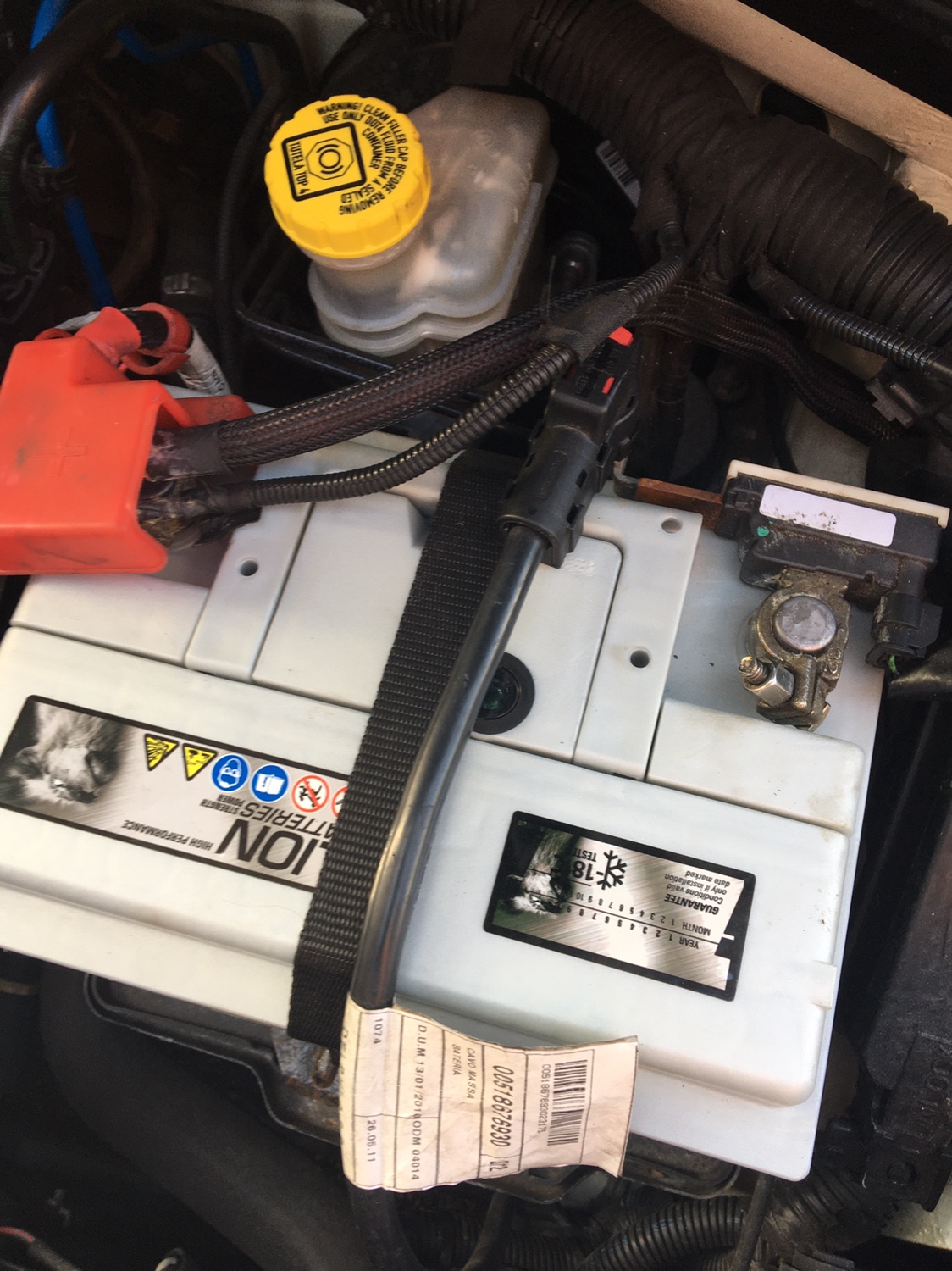

Can’t seem to see a model no ect....?
From a quick survey of UK battery suppliers it appears Lion brand batteries do use grey casings for their EFB range. It'd be useful to to get a look at the front label which should have model, Amp/Hours and Cold Cranking ratings.
For example;
Lion brand batteries are generally regarded in the trade as cheap rubbish ( I think it's an ECP/CP4Less own brand, sourced from the cheapest supplier they can find). There are shedloads of folks on car forums who've returned failed Lion brand batteries after as little as a year's use. So I'm thinking the battery is the most likely reason why your S/S won't work properly.
How old is it?
If it's more than a couple of years old, then replacing it (with a more reputable brand) may restore S/S functionality. S/S on the 500 needs a near-perfect battery to work; a weakening battery will disable S/S a long, long time before the battery shows any other symptoms.
That's the impression I got from my brief search - lots of negative (geddit?) vibes about Lion batteries. It's counter-productive to skimp on battery quality to save a few quid.
