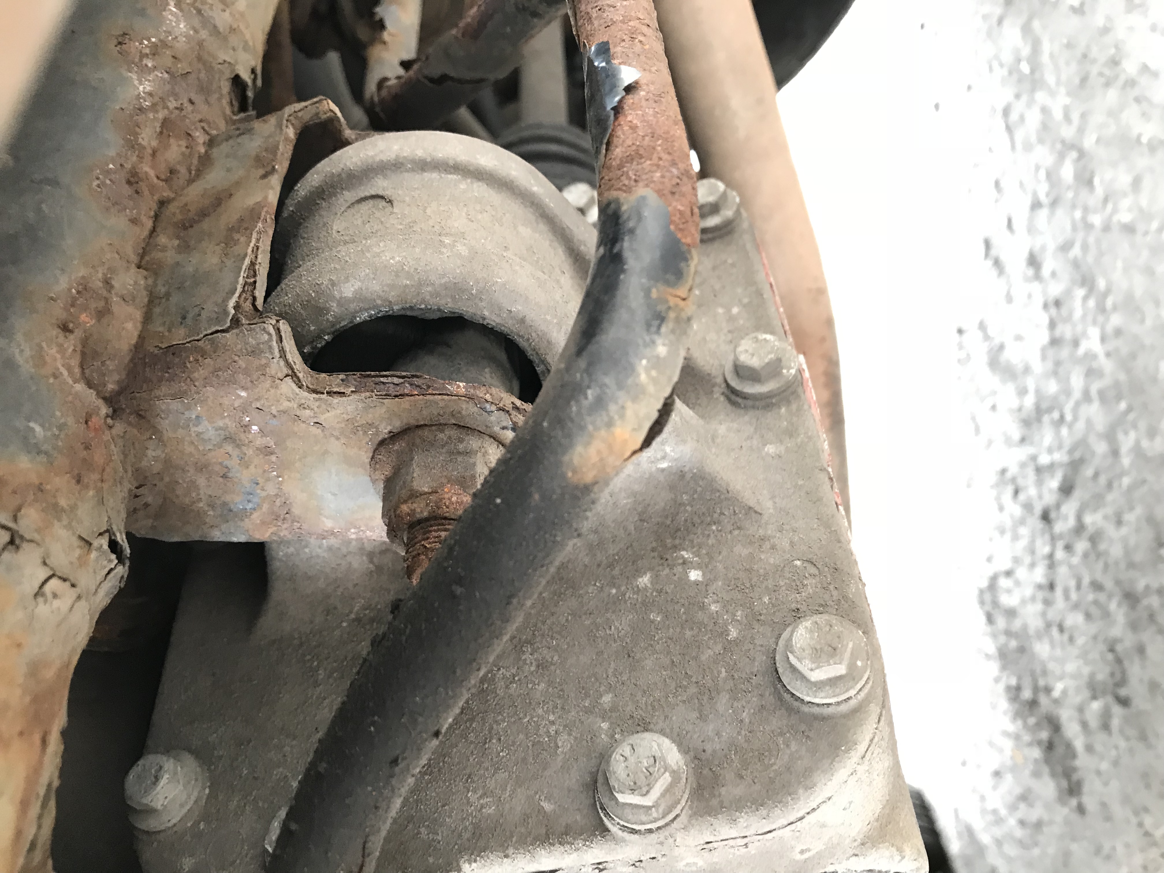

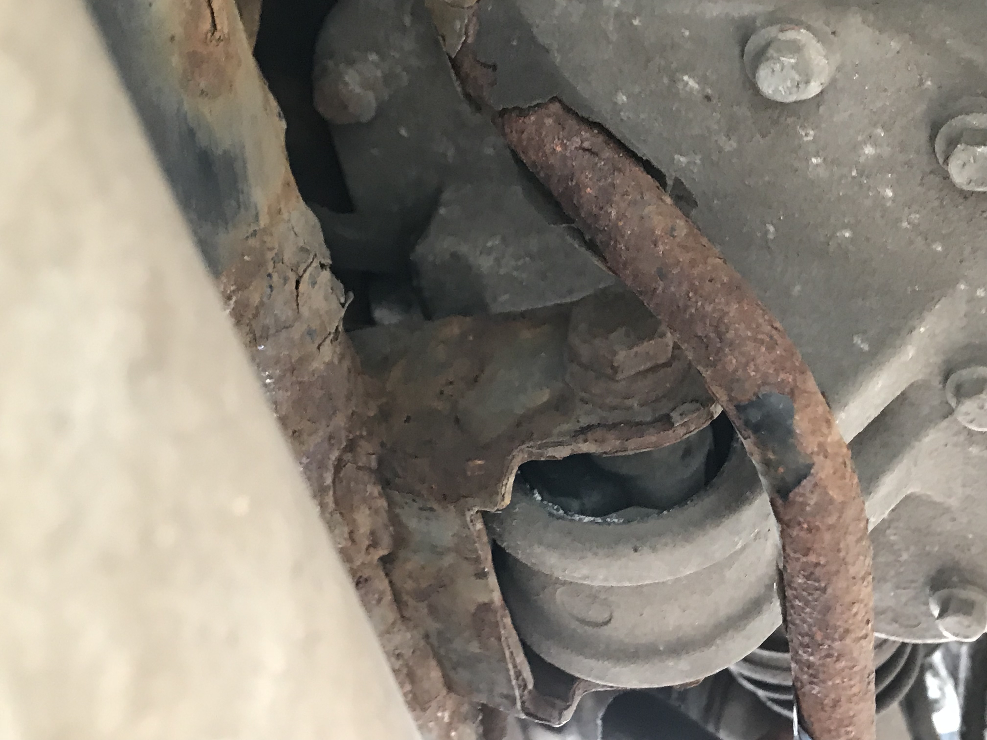

Sorry to resurrect this thread but we had issues with wheel rub and wobbling as we were driving. Some Polish mechanics (we are in Warsaw now) looked at the car and diagnosed a buggered tyre. The mechanic also found the culprit for the banging noise which I’ve added a picture of below. As his English wasn’t great and my Polish was much worse I don’t know what it is called (it’s a rubber seal which connects to the rear axel?? - please correct me if you know). He says it should only make noise and not give too much bother. Let’s hope it holds out through to Mongolia...

The English term is SUSPENSION BUSH.
The issue might be with the anti roll bar bushes. Least cost option is do those first and see if the noise stops. However, worn suspension bushes absolutely WILL NOT make it to Mongolia. If you really want to arrive, you need to solve the problem.
