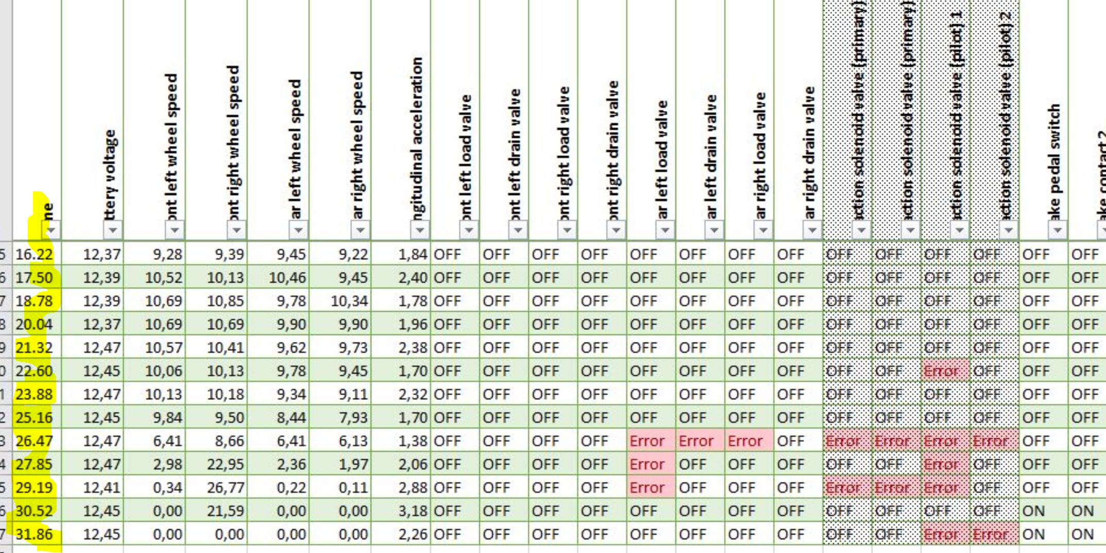

I have a personal interest myself owning a 2013 4x4TA and having experienced similar symptoms to you (4x4 unavailable, warning lights..etc). I am also interested in your MultiECUscan diagnostics equipment and have a couple of questions which might cause you to reflect on the interpretation of the data you are reading with it.
My question centres around what frequency the MultiECUscan system samples at when you are using it "live" (I mean when the vehicle is running and especially when you are driving it)? I have attached a couple of your own images and highlighted the time stamp which I assume is in seconds?
If these are actual data points then I would suggest that the frequency of sampling is way too slow if compared to the frequency at which a typical engine management/body control computer in a modern car runs at (although I am happy to be corrected). If this is the case then there is a real risk that you not not capturing anything like the reality of what is occurring (is this referred to as aliasing?). I make this statement from a reasonably informed position having designed development test data acquisition hardware using programmable software. Again I don't know the capability of the MultiECU scan package but I had always thought of it as a diagnostic system for reading and resetting codes rather than an on-line data acquisition unit? Again happy to be corrected by those better informed. Certainly ECU/BCM hardware must run kHz frequencies I'm sure?
So my point? My point is that you may not be measuring what you think you are or the measurements may not relate the actual situation, witness the crazy abs wheel speed data (unless you were driving on two wheels?) :slayer:

The op has been inducing wheel spin on slippery surface in order to see if the 4x4 system operates. So one wheel near zero and the other spinning on sloppy surface likely to result in the observed wheel speeds.
