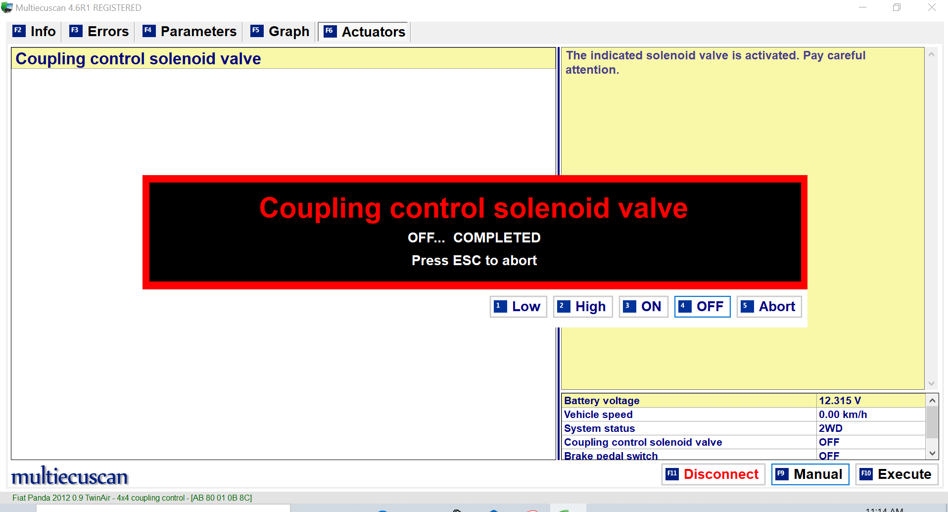

In the Battery Test <BatterieTest.png> the Load was high (starter) and the alternator did deliver. Thus we can suppose that the Ri (inner resistance) of the alternator is to be neglected. Supply side is ok. We can confirm this when I have a look at the Coupling Control Module and the cc solenoid valve. When I manually engage the valve from the Multiecuscan, the voltage as seen from the CCM takes a drop from 12.315V (cf. <off.png>) to 12.189V (cf. <on.png>) while the reading on the battery pole (supply side) stays virtually unchanged (lacking somewhat behind, which physically is impossible, I attribute this to my high-end-measuring-equipment, that gives a somewhat to low reading). Thus there is all the work done on the load side, none on the supply side. That's the way it is supposed to be.
(NOTE: Voltages are low as I am working on a 82% loaded battery. Manual actuation is not available while the enginge is running, so I had to do this test battery backed. Don't let this trouble your sight for the underlying pattern!)
From this test <off.png> to <on.png> we can further deduce that there is a remarkable resistance in row to the payload (consisting of the CCM and the solenoid being in parallel). This is not the way it should be.
Same picture I get when I go through similar test for the ABS Controller and the corresponding 8 plus 4 valves and the pump. Repeatable net voltage drops around 0.15 to 0.25V per device.

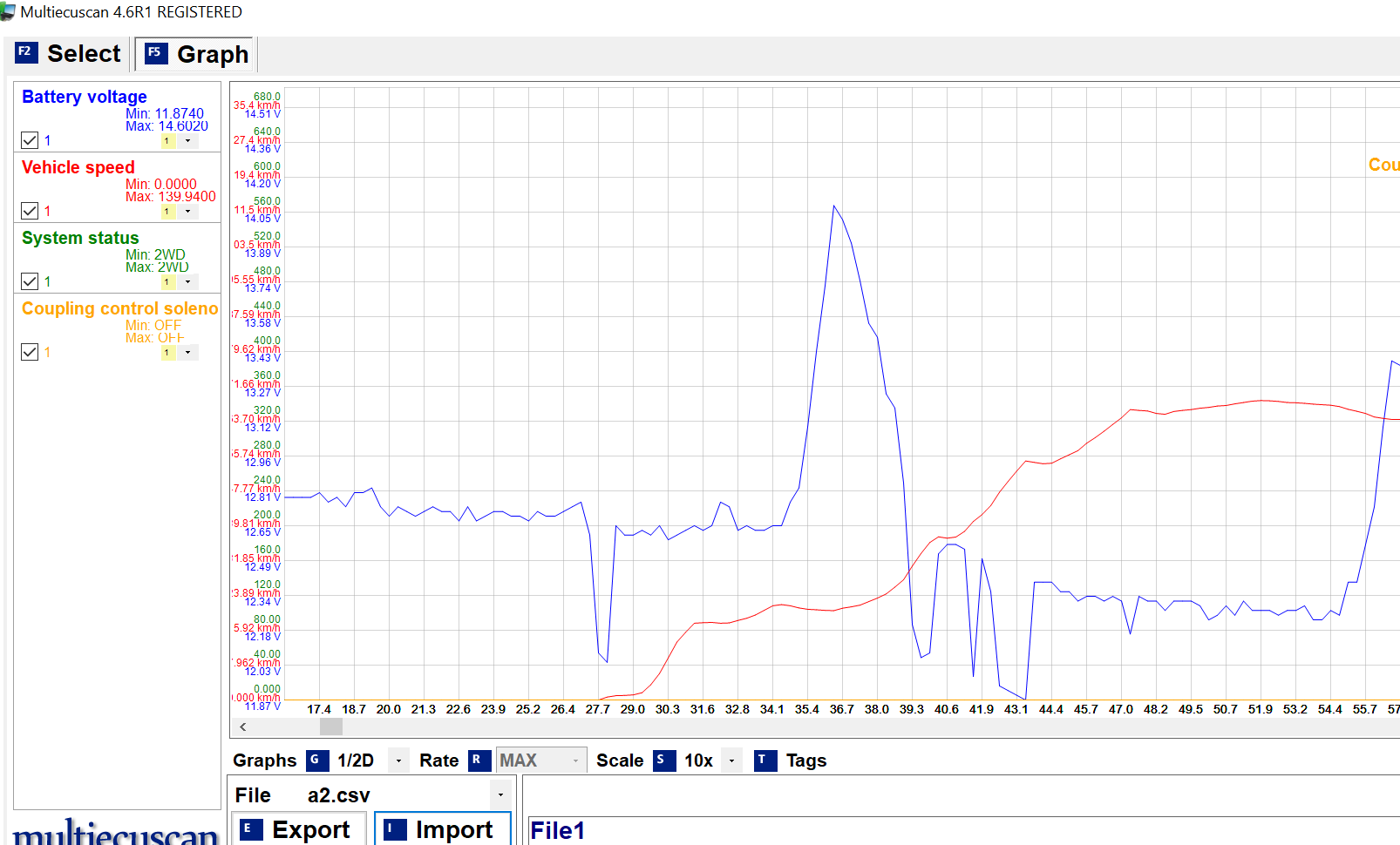

And something measurable which I could not capture is, that when engaging the coupling control solenoid, the voltage reading drops shortly to 11 and somewhat.
I managed to capture this effect only when driving. It is a curve and I really did hit the throttle. Here you see a voltage drop to 11.87V recorded. Given the fact, that it is a digitalized reading, the "real" minimum should even have been somewhat lower. Now imagine the ESC jumping in at that very moment, starting the ABS pump and engaging up to 2 release and 2 load valves simultaneously...
