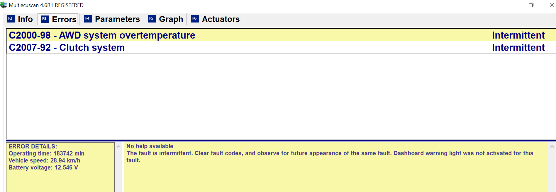

Now I realized that the awd is no longer working. Had in my independent garage the oil checked and filled up 0.6 liters. They did not see any errors with their OBD-System.
Next did research the internet and found one and only one resource where it seems that knowledge is available: This forum. That is why I am kindly asking you for your advice.

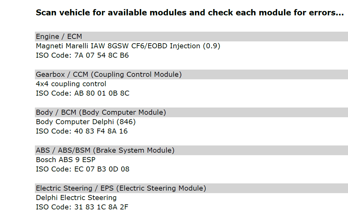

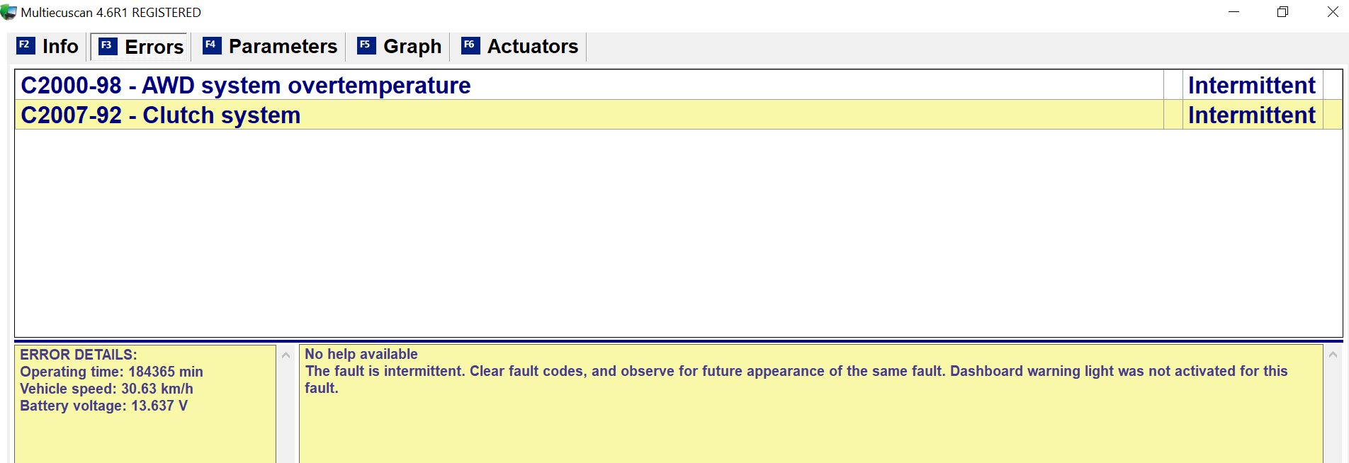

Plugged in my Multiecuscan did a reset of the (indeed existing) errors, did a diagnostics ran (see attached report.png) and reproduced the "AWD not available" error by engaging a steep slope. This gave me the errors as detailed in the attachements.
The actuator test of the solenoid ran without errors. There was also a clicking audible when switching the solenoid on.

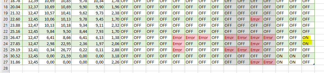

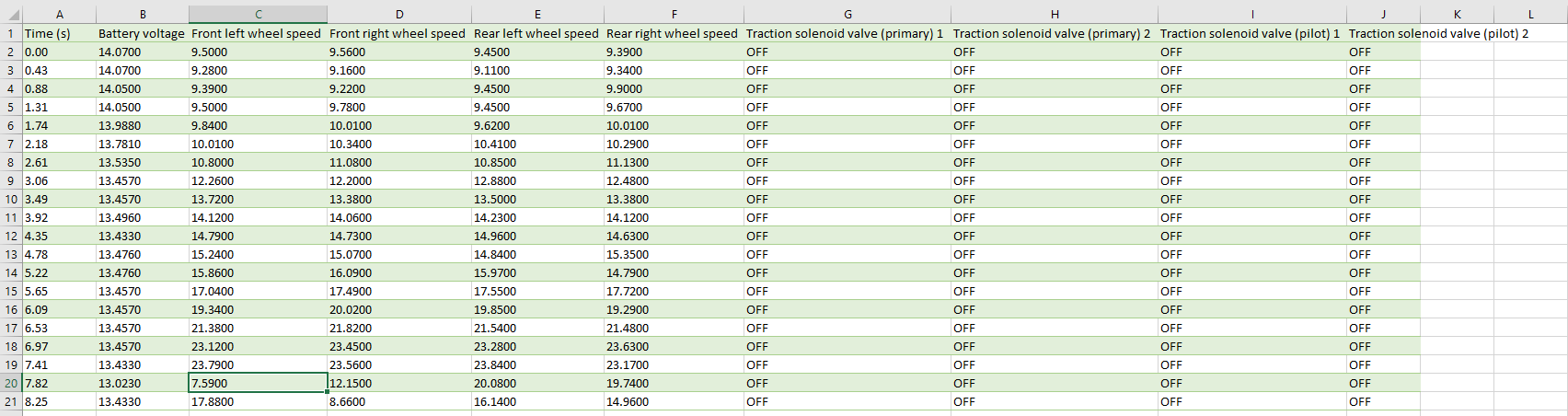

Thx for the input. Did gather some data to see wether this all correlates with the batteries voltage.
Also included the perspective of the ABS Controller, as (IIRC) in another thread Oyumurtaci did mention the voltage and the ABS as one of the possible sources of trouble.

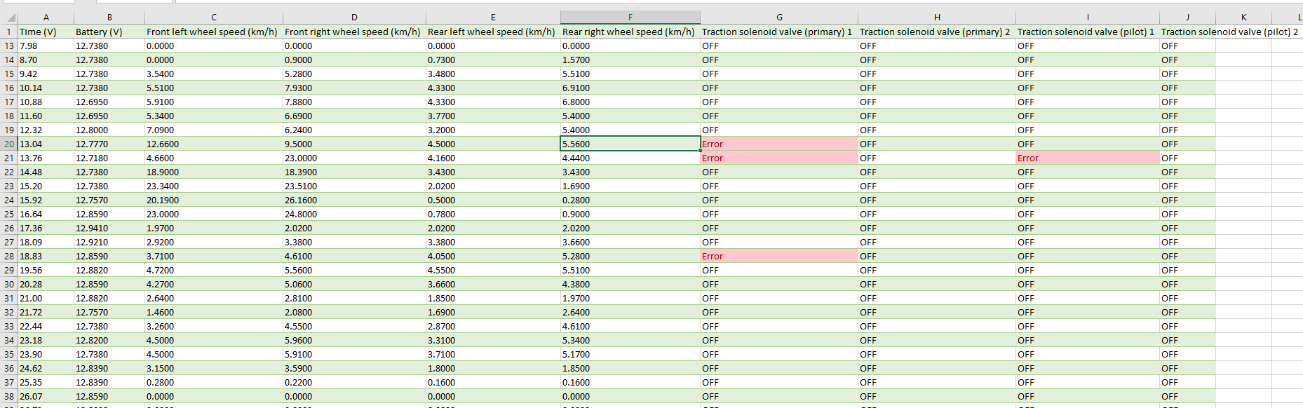

Overview of the ABS is given in abs9resp.png. Did observe the Traction solenoid valves and made the actuator test (hitting F10 Execute, see solenoidErr.png). While testing they went into an error state, also on the picture they are OFF.
The test created the error C1222-29 - Vehicle speed incoherence. Never captured this before or after.

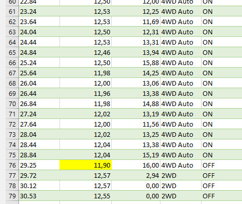

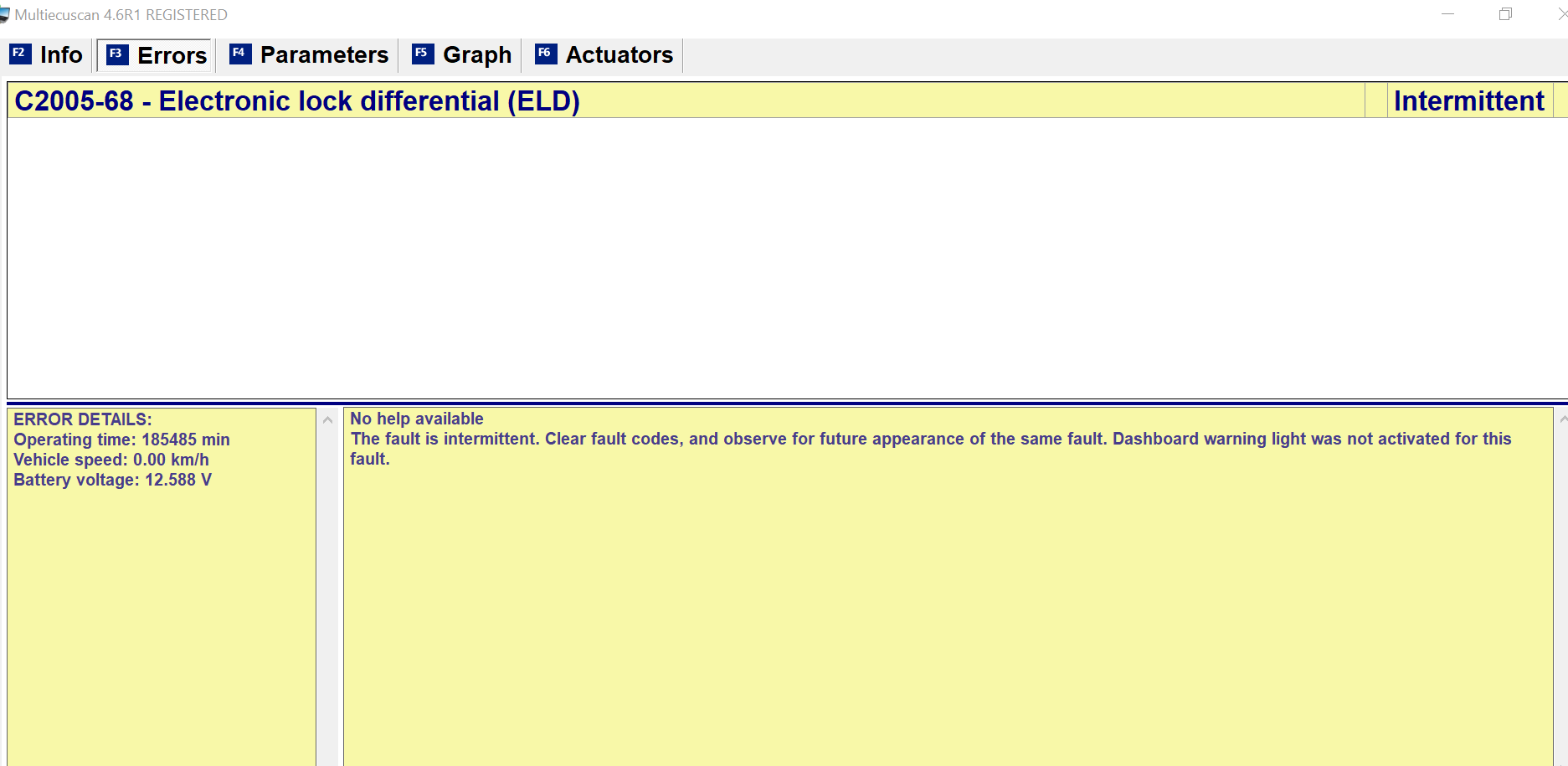

Next I did reproduce the situation of the diff engaging in the slope (ELD enabled). See SlopeErr.png. The red rows show when the front wheel starts spinning and the voltage takes a deep dive - I have the impression that there is a moment of drive from the rear axle, not too sure about that - and finally the 4WD is switched off. BTW, during normal operation on the road, the 4WD is activated every once in a while during acceleration WITHOUT any noise. But after this test the "usual" errors C2007-92 - Clutch system and C2000-98 AWD system overtemperature are captured.
As far as I can see, the statement "AWD system overtemperature" is a guess of the software, as there is no feeler to take the temperature on the rear diff.
To get a feeling, wether the ABS is responsible for the drop in voltage, I did test the ABS.
First same scenario as for the clutch coupling perspective, engaging in a steep slope to get the front wheels spinning. (See SlopeABSErr.png). When the front wheels start spinning at row Second 13.04, the traction solenoid valve reports an error. In contrast, the ABS controller does NOT see the drop in voltage. Strange.
Next I did an plain ABS test by hitting the breaks violently (see ABSError.png). Indeed, when the ABS is engaged (you see the wheel speed getting chaotic) the the voltage drops.

What does this mean? The ECUs (five are detected by the MultiEcuScan) report all a different voltage on there high voltage pin. To my understanding they measure the voltage between this high voltage pin and their respective ground pin. Each and every ECU has its own and very private reference base (I stand to be corrected on this one!). I will take note of all five readings with the engine running hence (hopfully) certeris paribus. This reading is electronics.

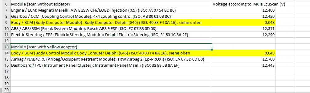

The voltages as seen by the ECUs themselves and reported by MultiEcuScan here attached. As you can see everything is at the low end but still fine. Everythin? No, wait, the Body Control Modul reports nonsense.

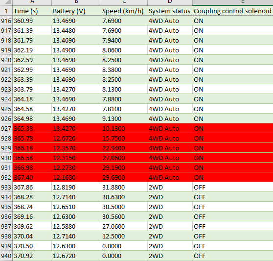

Have a look at the voltage dip the Coupling Control Module reports when it switches off ...
...and...
... at the same time the action the ABS initiates: Nearly All valves (8 ABS, 4 Traction control) plus the pump are spinning off at the same time!
Data is recorded when the ELD is off and hence the ESC jumps in when stability is lost due to front wheels going nuts...
