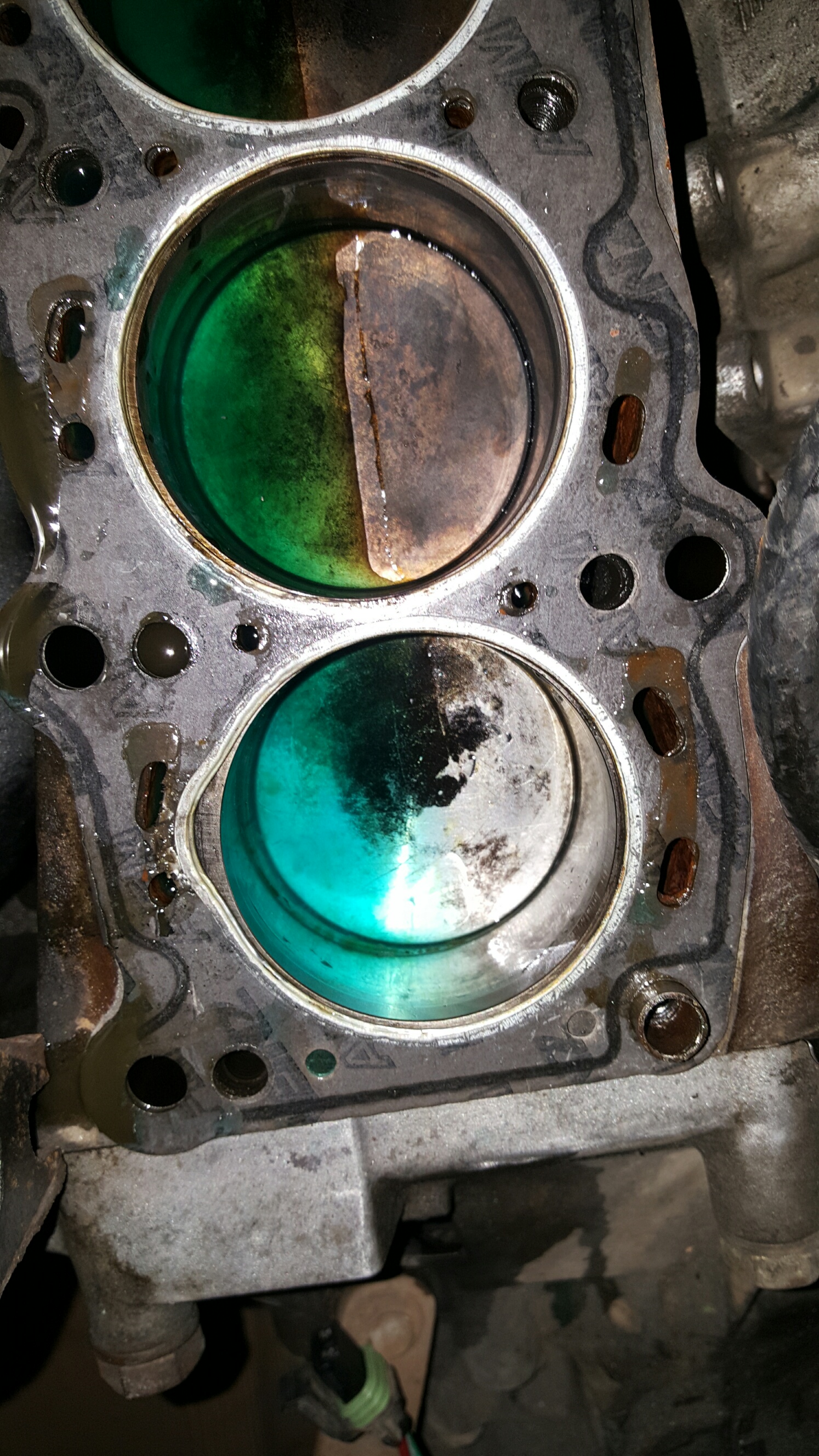

This is what I see after I took off the head again:
attachment.php
attachment.php
What could cause that?
I've closed the head exactly at 20nm, then 30nm, then 2 times 90*.
My friend told me the head may be low height, and that it would happen again if I put a new head gasket.

Looks like you've been a very lucky bunny!
The ringing noise is likely to be detonation, or 'pinking'. This is where the fuel explodes in the cylinder. Normally the fuel burns very rapidly, it does not explode. When the fuel explodes, like any explosion, there is a lot of force. This will usually pop a hole in the top of the piston. It appears from your pictures that it has just pushed the head gasket aside, into the coolant passages. Putting coolant through the combustion chamber will give white smoke.
If the head and block faces are ok, a new gasket should fix it. Make sure you clean out all the coolant from the tops of the pistons. Change the oil, as some coolant will be in there too. Then set the ignition accurately before you put any load on the engine.
A new set of head bolts is probably a good idea too.
Pinking could have been the distributor timing, but could also be a timing belt 1 tooth out (Uno`s do run with 1 or even 2 teeth out).
Did it overheat when you got the smoke coming out?
Are those grooves on the block under the damaged part of the head gasket? Whats the state of the block?
Assuming the block & head are ok (get the head re-checked for flatness & re-skim if necessary), put it back together with NEW head bolts.
