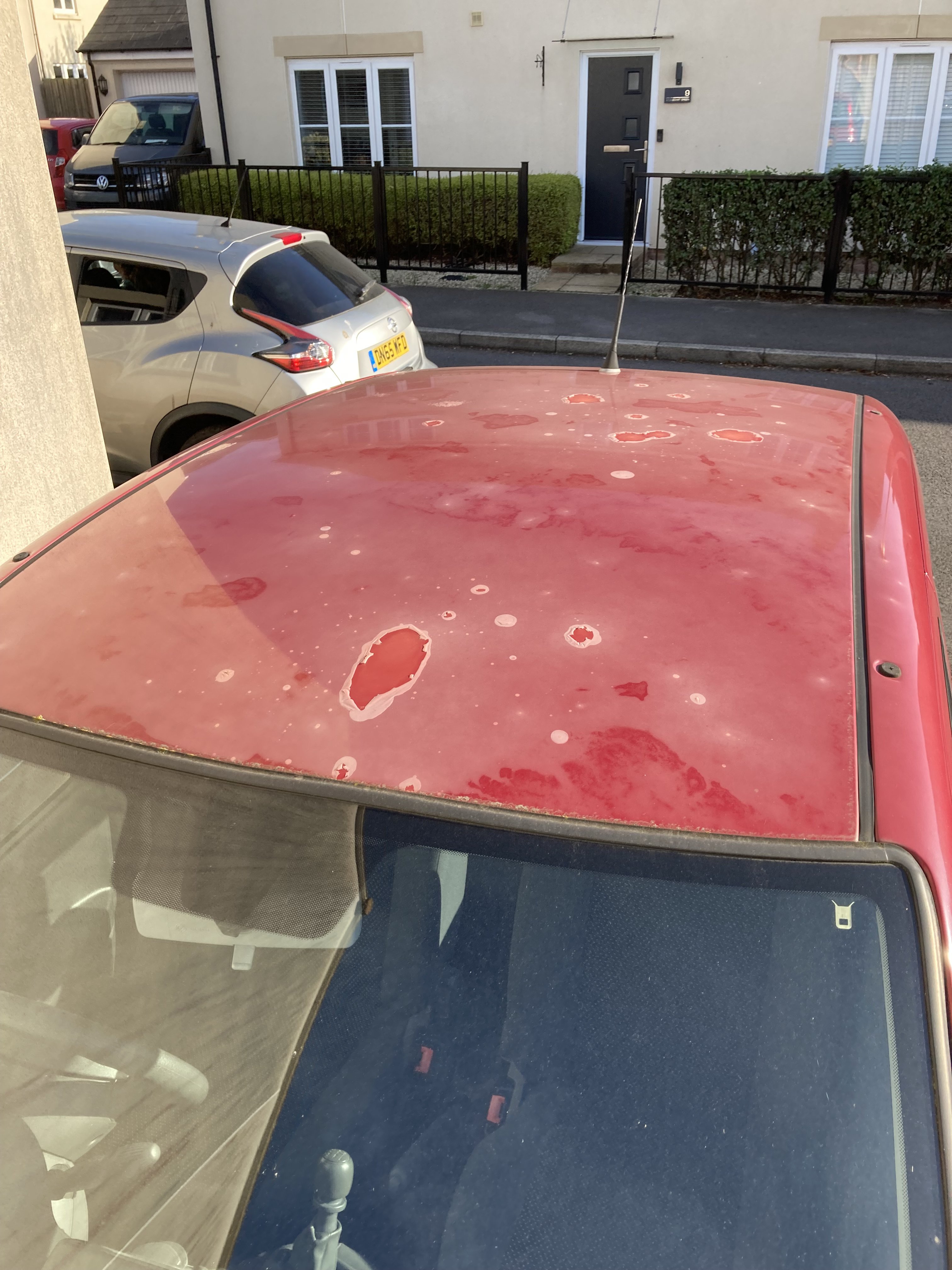

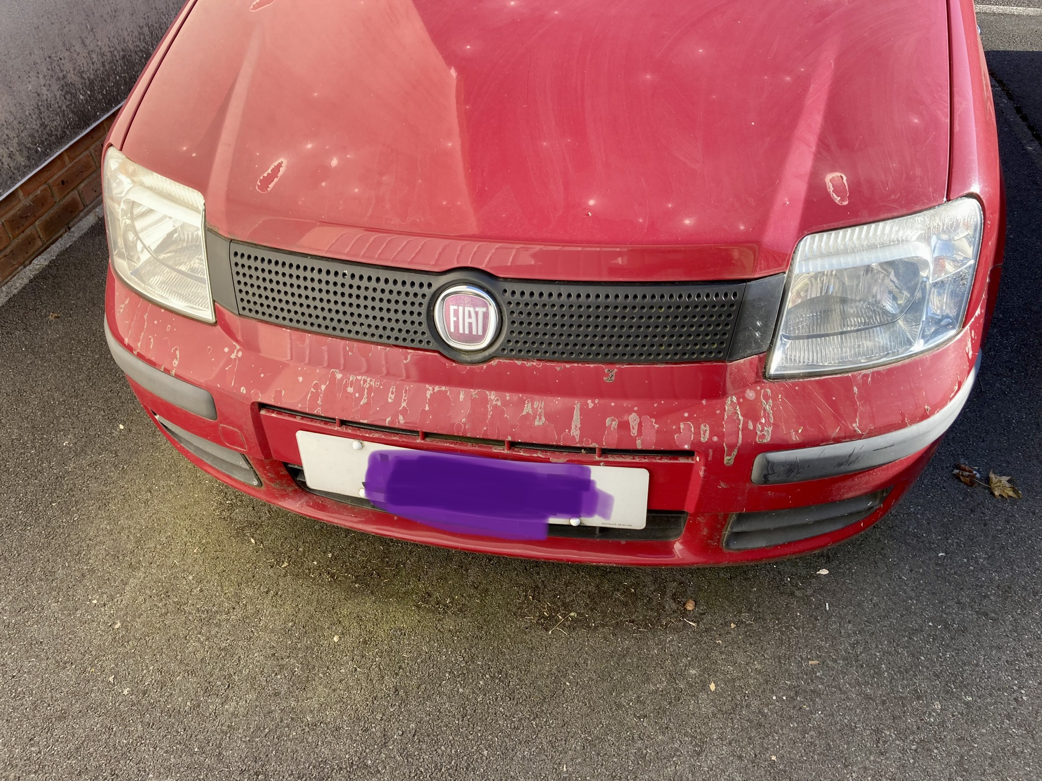

sorry just interested as It would help to decide how far I go with this. What do you think it could be worth if I get it running and MoT’d, obviously the lacquer is a big negative to factor in? A couple of pics attached.
Lacquer/clear coat has peeled/delaminated
There's no easy fix
Each effected panel needs the top taking back to solid paint all over and the clear coat reapplying
Sound simple, but it's not
Yes, it would be nice to thick you could just rub it back and polish it up but I’m under no illusion that that this would likely end up with a re-paint. Of course you’d never match the doors tailgate wings etc. Any kind of professional paint work likely means I’d never see a return. My plan was was to hit it with vicious mode on the jet washer to remove any loose flakes, polish up the exposed paint and sell it on as a nice little runaround with cosmetic issues. Of course this is assuming I can get it started and MoT’d. I could be flogging a dead horse but I can’t bring myself to think that a sub 8k car should be scrapped. Staying positive, for now!

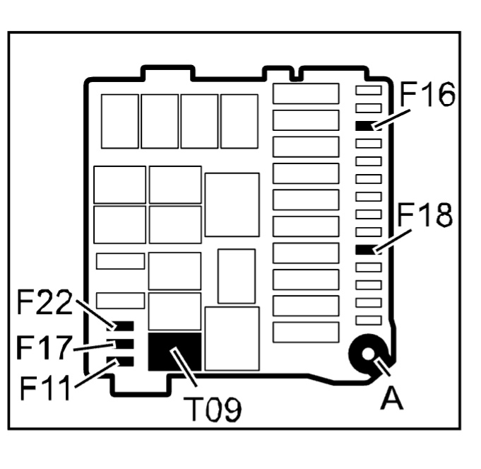

Fuse doesn't sound right it can vary a bit with age and model, info should be right in the owner manual
On my car 1.2 euro 5 it's F21 and T10 under the bonnet.

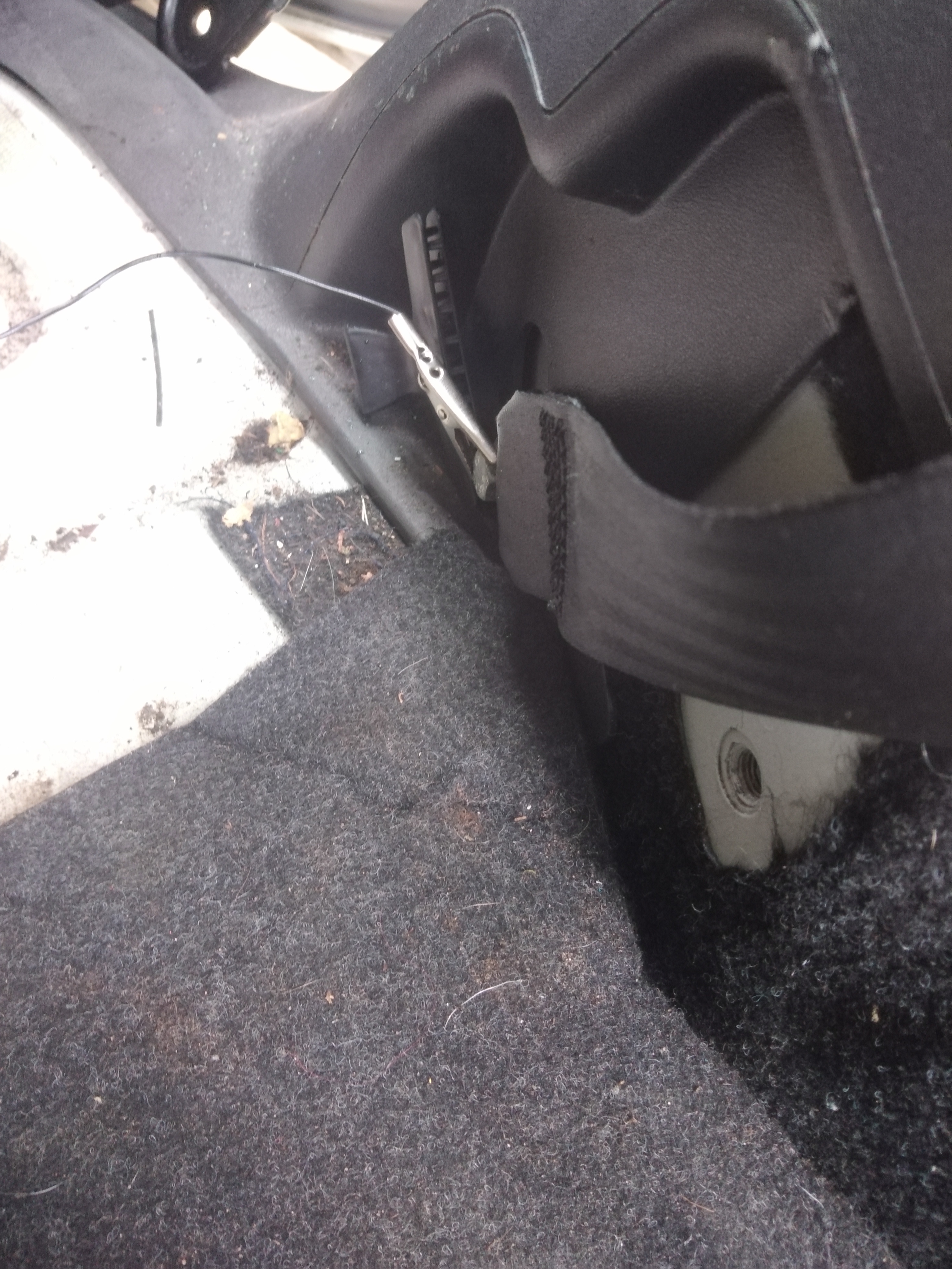

Right turn ignition on there should be a buzzing from the pump
If not back probe the purple and yellow wire, finding a good ground isn't easy
Here's mine T pin into the back of the connector (yellow and purple) and a seat belt bolt as a ground
You can hear the pump and ignition going on and off
Because I am using a seperate ground the Inertia cut off switch is bypased
If there is no voltage here the problem is towards the battery, if there is voltage here it's the Inertia switch, ground or pump
Red and purple to the same ground should measures less than 1 ohm if the Inertia switch is okay

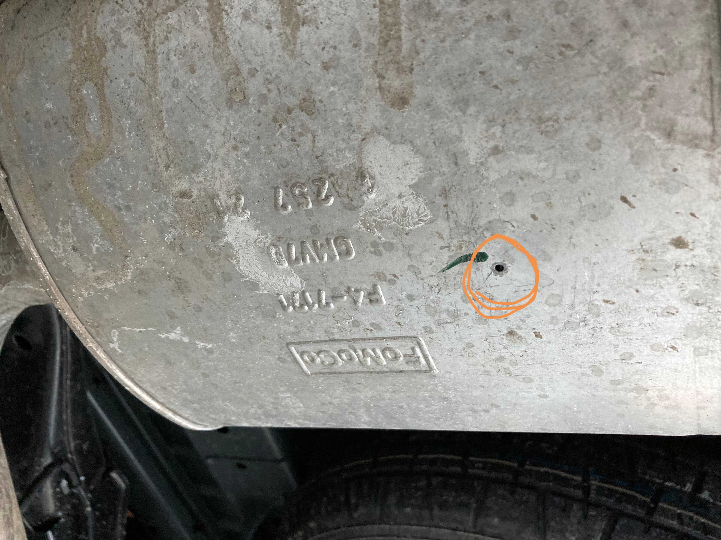

The exhaust box has a small hole at its rear designed to allow water to drain from the box. Some people percieve this as a hole / fault but it is there by design. You replaced the fuel pump in this - ensure that the replacement is sealed otherwise you get a smell of petrol in the cabin plus low pressure in the fuel tank (as it is a pressurised fuel tank).
Thanks. Regarding the fuel pump it was hard to remove and hard to install. The tool I bought was not very good, but worked to a point. I will go back and check for smells and leaks once the car is back on the road and sloshing around.
I have to agree that hole in the silencer definitely does drain water (see video). What worried me a little is that I can feel a small blow of gas through the hole as well. Is this supposed to happen. Just trying to make sure it would get through the MOT.

Looks like corrosion to me
Here's a weep hole on a ford
Never seen one on a panda but it will depend on the supplier
Anyhow it shouldn't sound like that
Are you sure there isn't another hole
If you block the exhaust with your palm can you hear it escaping anywhere else
Sounds a bit blowy for such a small hole so far back? Mybe just the sound on the video
It's just fine - that weep hole is there by design and it'll pass an MOT.
There's a bit of corrosion around the hole, but that hole is there by design in an OEM backbox. This is what it looks like on a new one. The condensed water dripping out on that video illustrates perfectly why it's needed.
Not all replacement backboxes have such a hole. The cheapie one (all I could get at short notice) I just fitted hasn't, which doesn't bode well for its likely lifespan.
