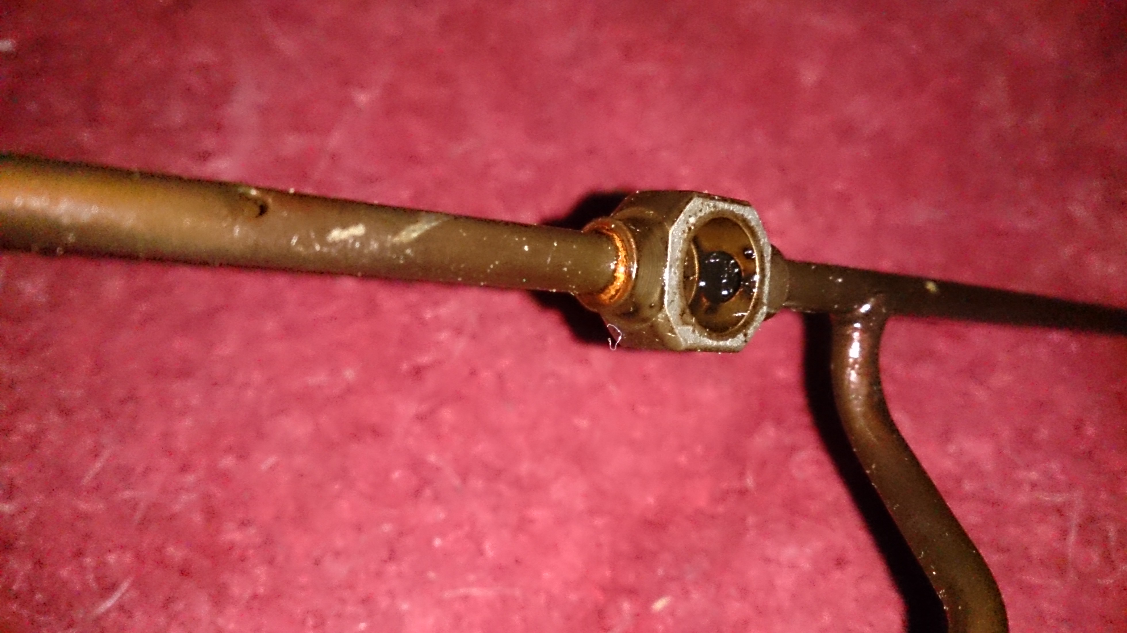

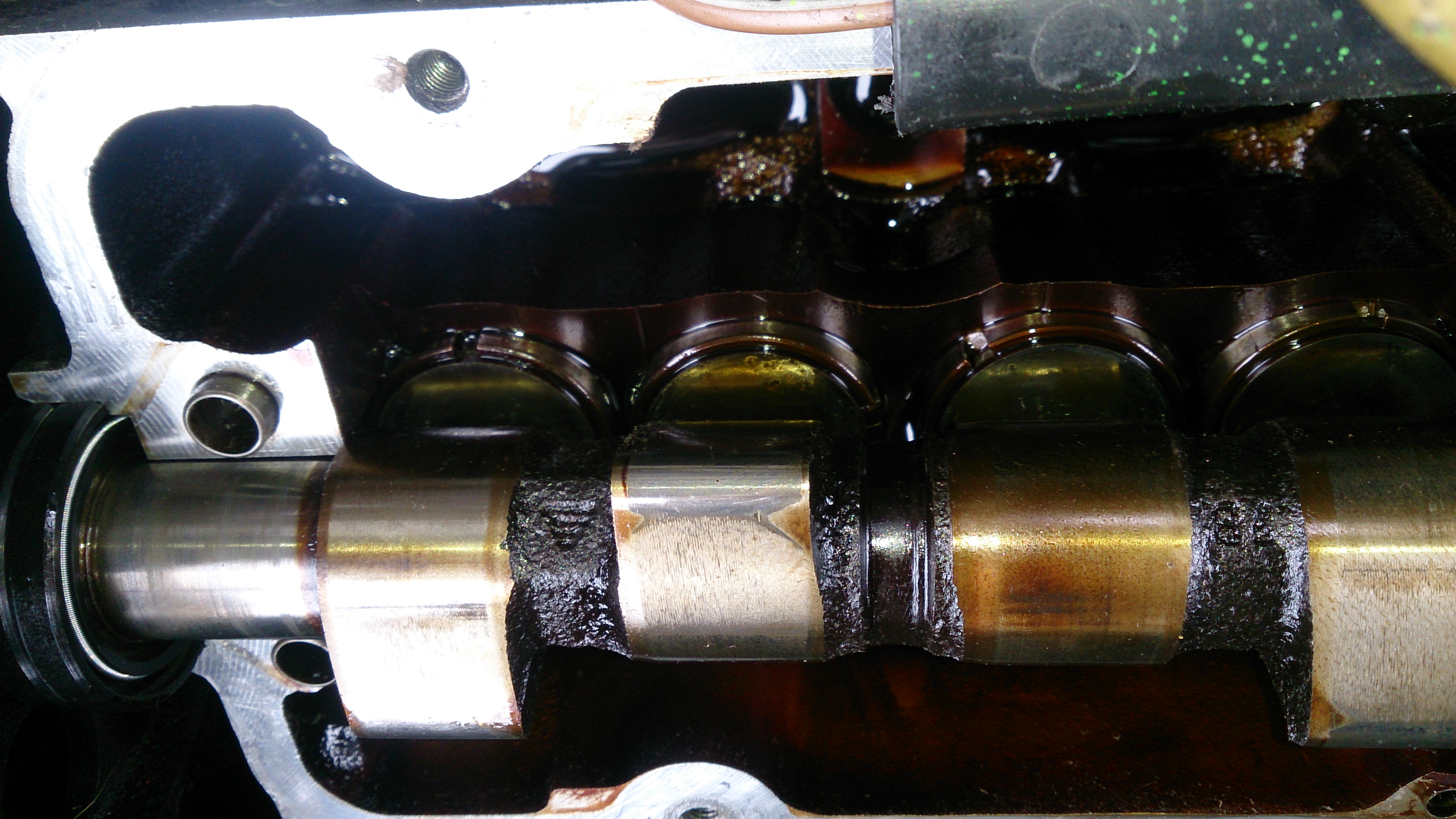

with the replacement engine,
make sure you take the cam cover off and clean the oil spray bar. the one on my replacement engine in Fallout was totally blocked causing one (or more) of the cam lobes to be worn.. its something i have not fixed yet but when cold you do hear the worn lobe ticking.
also while its off, it gives you something to do with the cam cover ;)
