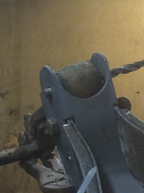

Custom engine mount for 35mm engine drop
Shock- hub carrier adaptor plate, allowing 50mm suspension raise
