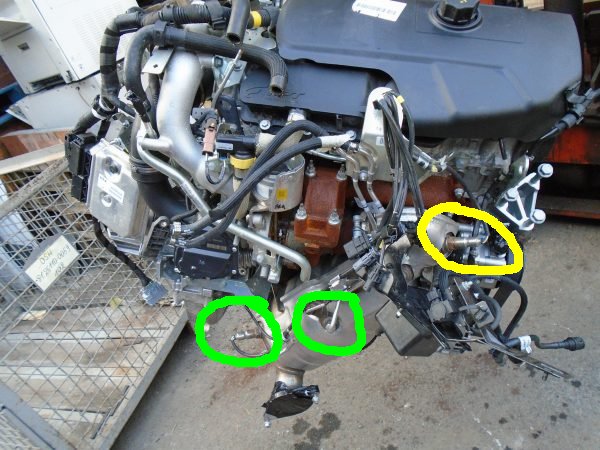

After a recent trip my engine management light had come on but the van drives without fault. Tha OBD2 reader shows the fault is O2 signal sensor circuit shorted to heater circuit bank 1.
Where is the senser please. Is it visible from the top of the engine bay towards the left below the brake child reservoir. Thankyou
The device you can see, i think is the yellow one in the photo. I can see 2 others (green). Now in MES we have 2 oxygen sensors and 3 temperature sensors. Having followed the cable from the yellow sensor to the connector cluster next to Dymax box it is electricaly probe able from the 5 way connector.

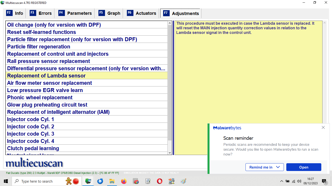

Note Lambda sensors are one of those that need learning to the ecu. photo from Multiecuscan. Multiecuscan refers to the sensors as oxygen sensor (pre) and oxygen sensor after DPF.

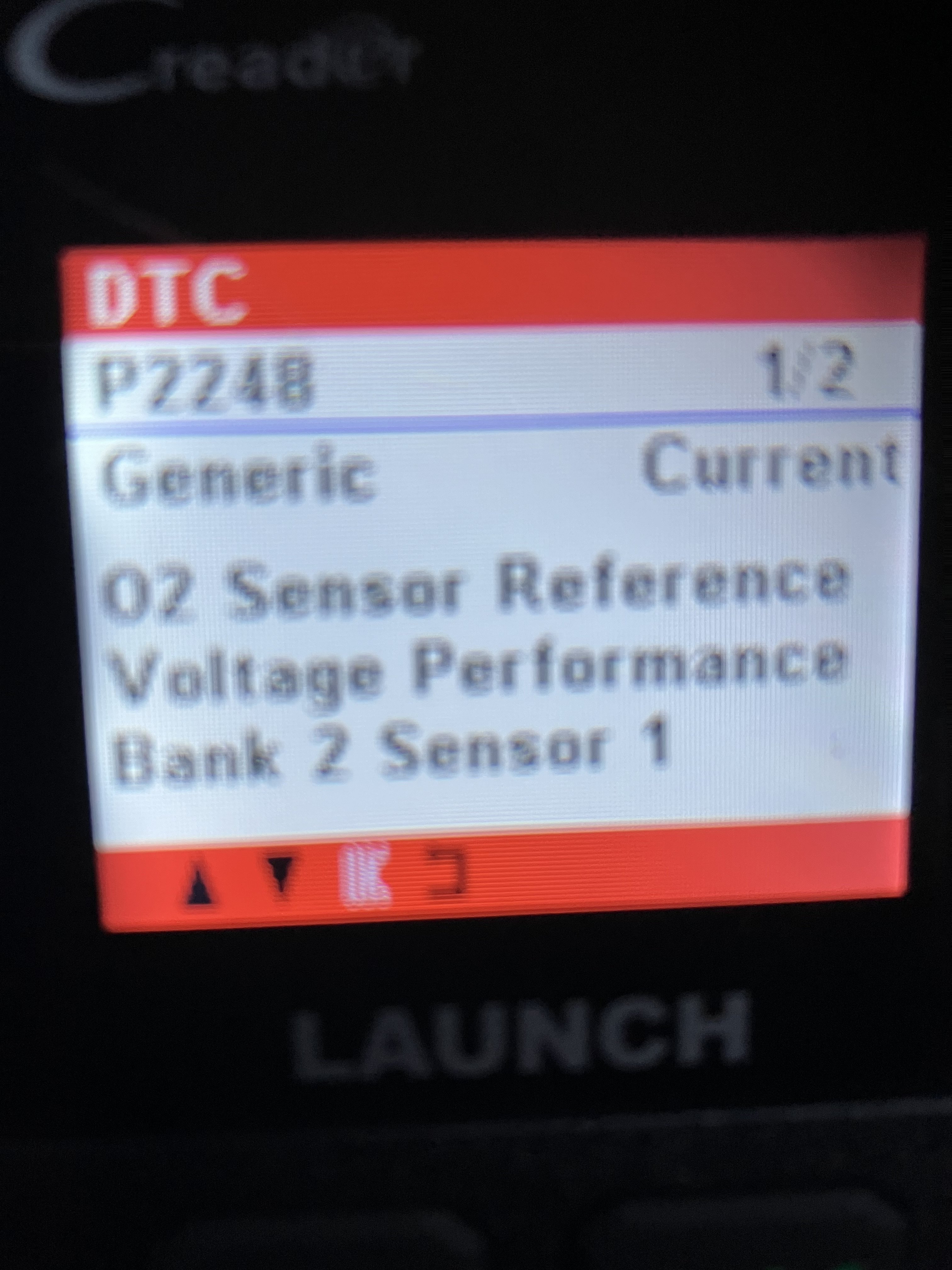

Hi,
Don't rely on that code reader giving a correct description for codes where the first number after the P is not a 0.
For instance p2248 may mean different things for different manufacturers.
You would need the FIAT meaning of p2248
the only codes i have in that region
Fiat 2​
P2231​
Lambda sensor heater coupling detection​
Ducato​
P2231​
Lambda Sensor Resistance​
Ducato​
P2243​
Lambda Sensor Electrical Diagnosis​
Codes are only ever an indication of where to look and not a definitive this will solve your problem. as previously stated codes 2xxx are manufacture controlled and Fords interpretation will be different to FIATs. so cheap generic code readers are unlikely to be as accurate as dealer scan tools or Multiecuscan.

Note Lambda sensors are one of those that need learning to the ecu. photo from Multiecuscan. Multiecuscan refers to the sensors as oxygen sensor (pre) and oxygen sensor after DPF.View attachment 434437
Hello mate. I deal in ex Bt fiat ducatos and my issue is bank1 sensor 2 which i belive its under the vehicle after the cat. When i replace it does it need coding in and will a snap on diagnostic be able to cover it.
@321tom yes it will need coding. This procedure must be executed in case the Lambda sensor is replaced. It will reset the MAIN injection quantity correction values in relation to the Lambda sensor signal in the control unit.
As to if a snap on tool can do it i dont know i use Multiecuscan
