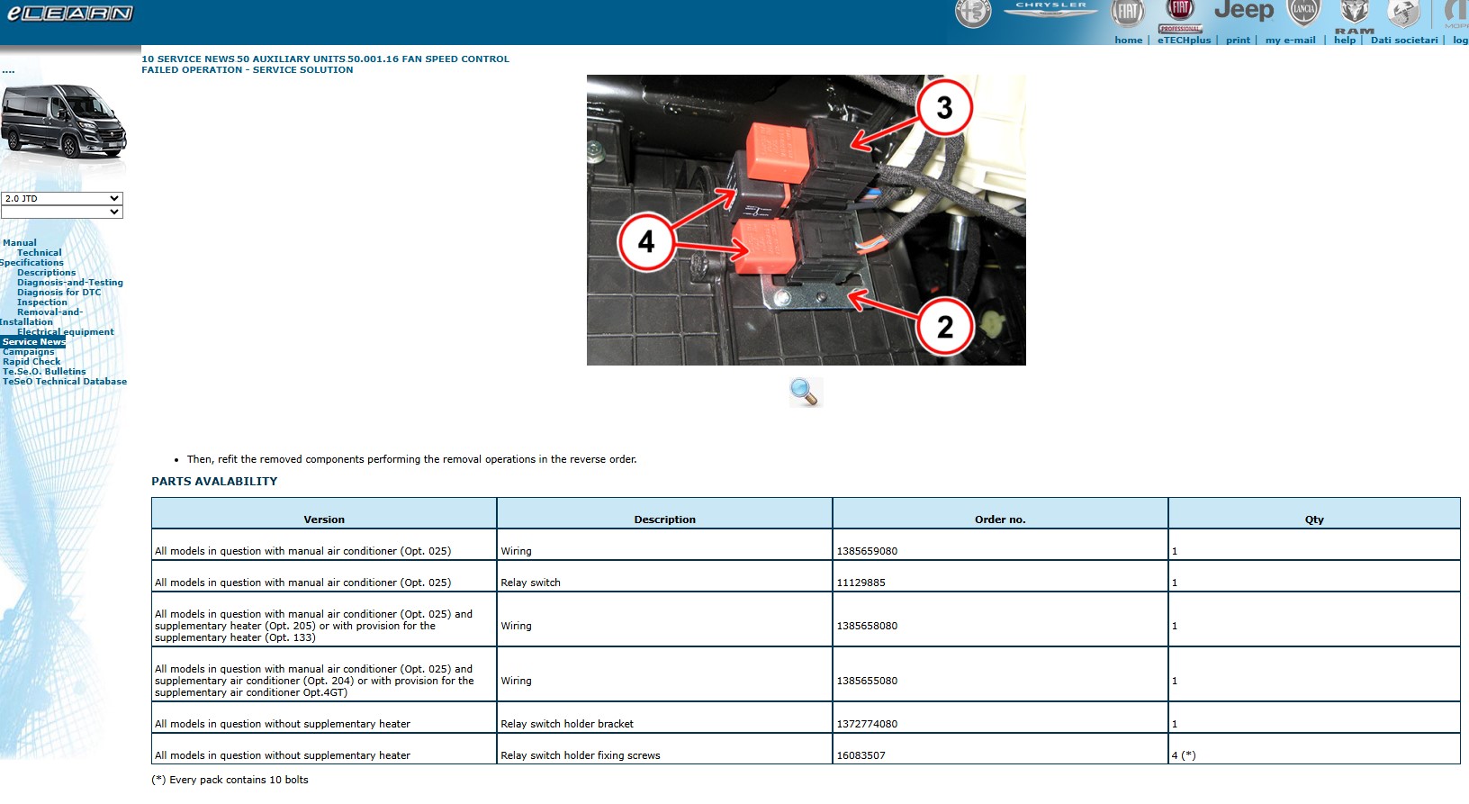

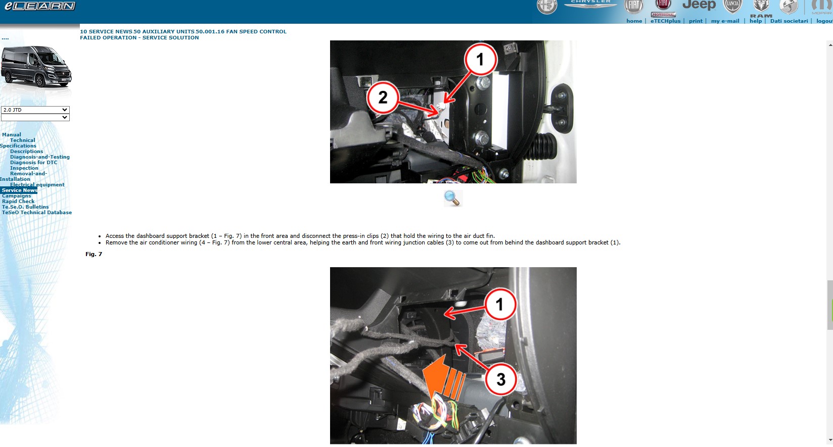

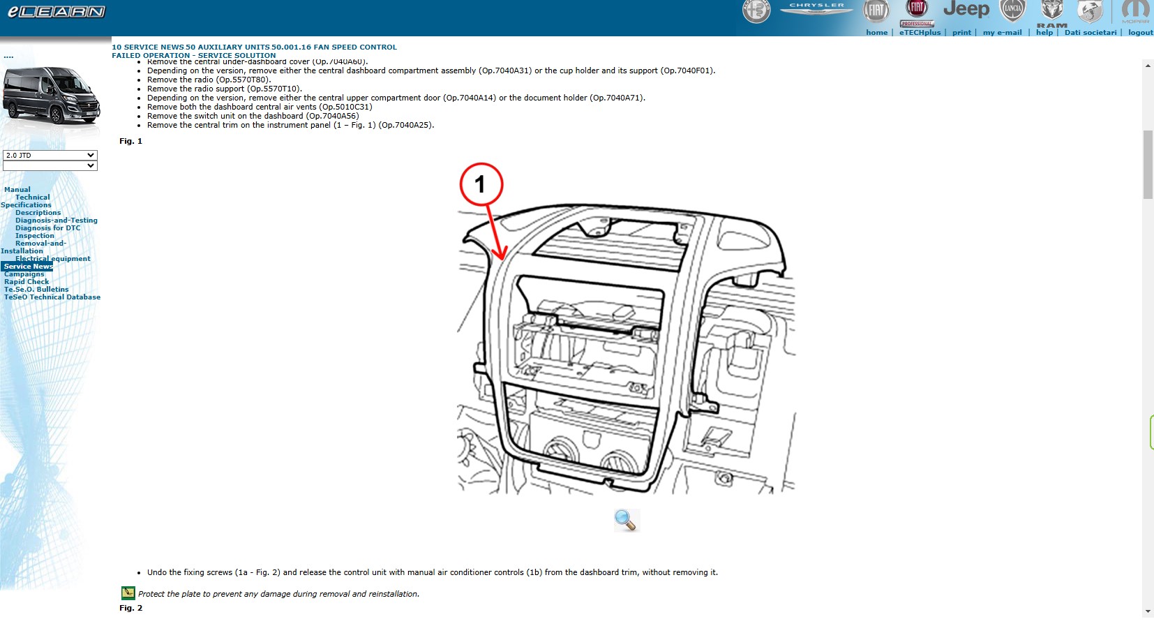

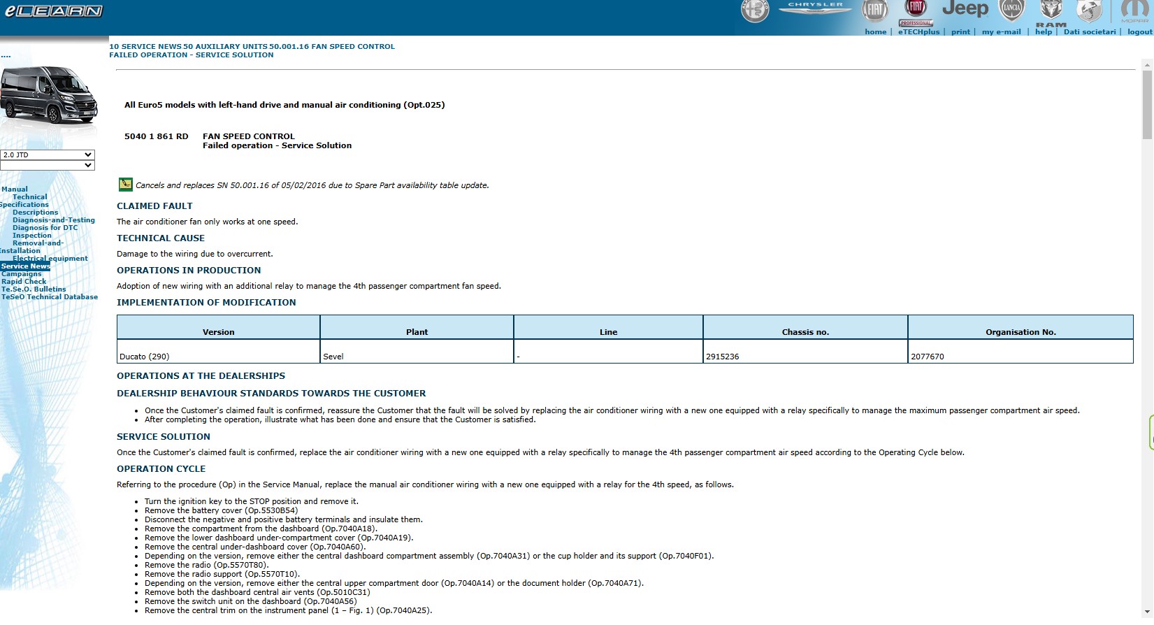

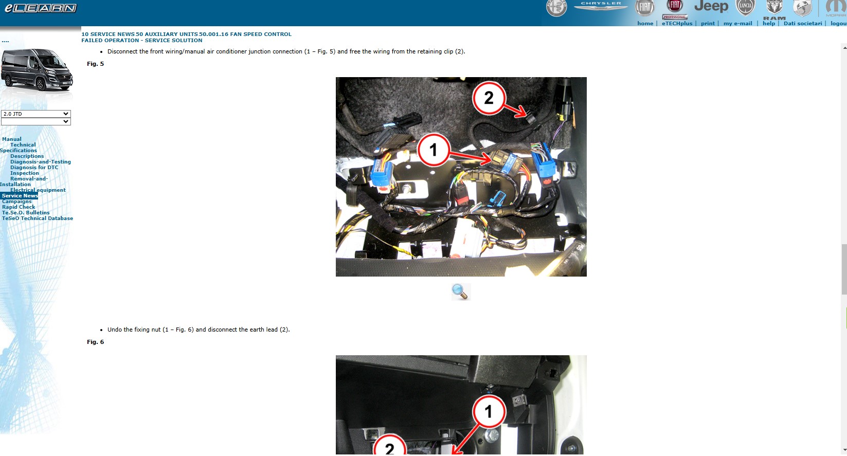

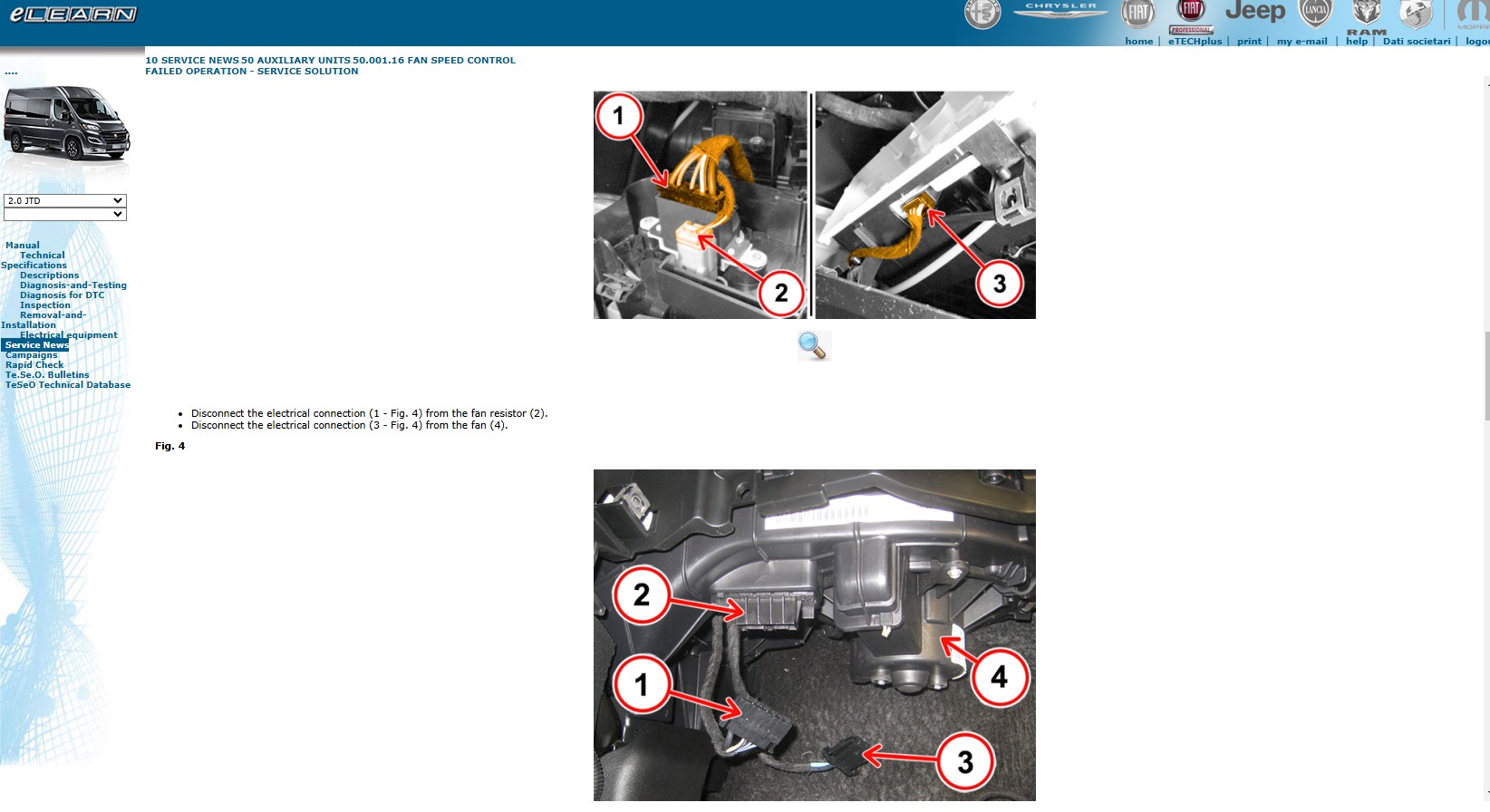

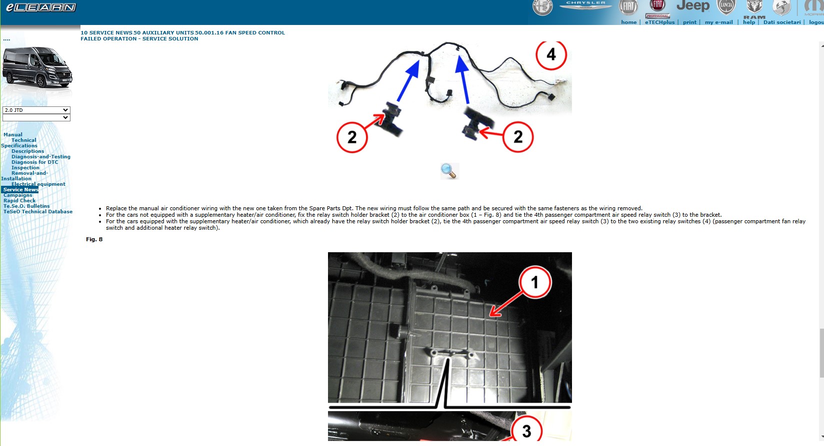

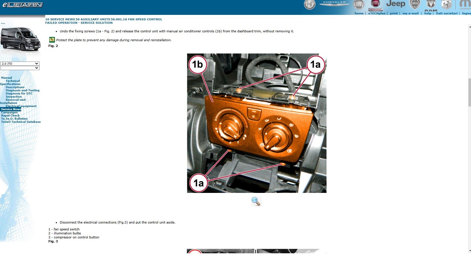

I've previously saved these on a "just in case basis". The first from another forum is pretty self explanatory. The second is unfortunately in several parts as I saved the screen grabs as consecutive images. It's a service bulletin for 2014 onwards vans, relating to a revised wiring loom and relay switch for the fan control.
