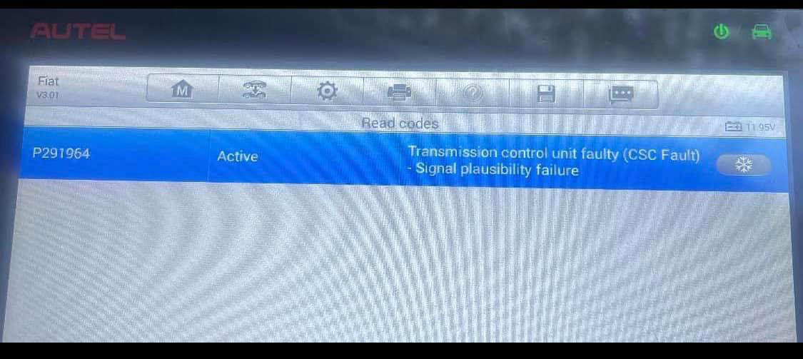

Hello I have a 2016 Ducato maxi l4
2.3 diesel with semi automatic I believe it’s called comfomatic
Has a fault with it , says gear unavailable and is stuck in neutral
When plugged into computer P291964 is coming up
Any recommendations what to look for first or what could the problem be
Any help would be much appreciated Thankyou

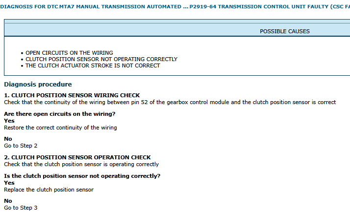

Firstly Welcome,
A couple of questions;
When was the hydraulic fluid for the gear change robot last changed (Tutella CS Speed) ?
Do you have access to Multi ECUscan which gives far more info than the Autel.
Lastly have a look in the guides section under user @Seanwinder22 He has written some excellent guides on what to look at
Firstly Welcome,

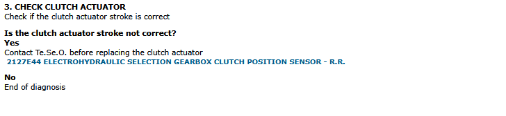

As per an earlier message, I would start with the hyraulic fluid.
My secondhand 2016 ducato campervan never had the fluid changed (as I learnt to my cost) by anyone since it was new! The gearbox handbook clearly states a gearbox service schedule (if only I had read it...) . When mine failed, the robot's hydraulic fluid pot (in the engine bay) contained black sludge as opposed to hydraulic fluid.
In hindsight, I should have got it looked at when I noticed a previously unheard "sighing" sound when it changed gear. A year later (when in Germany of course), I got the "gear unavailable" error message - van had to be repatriated. All fixed now by Adams Morey in Portsmouth. That gearbox hydraulic fluid is going to be changed ever year from now on!
