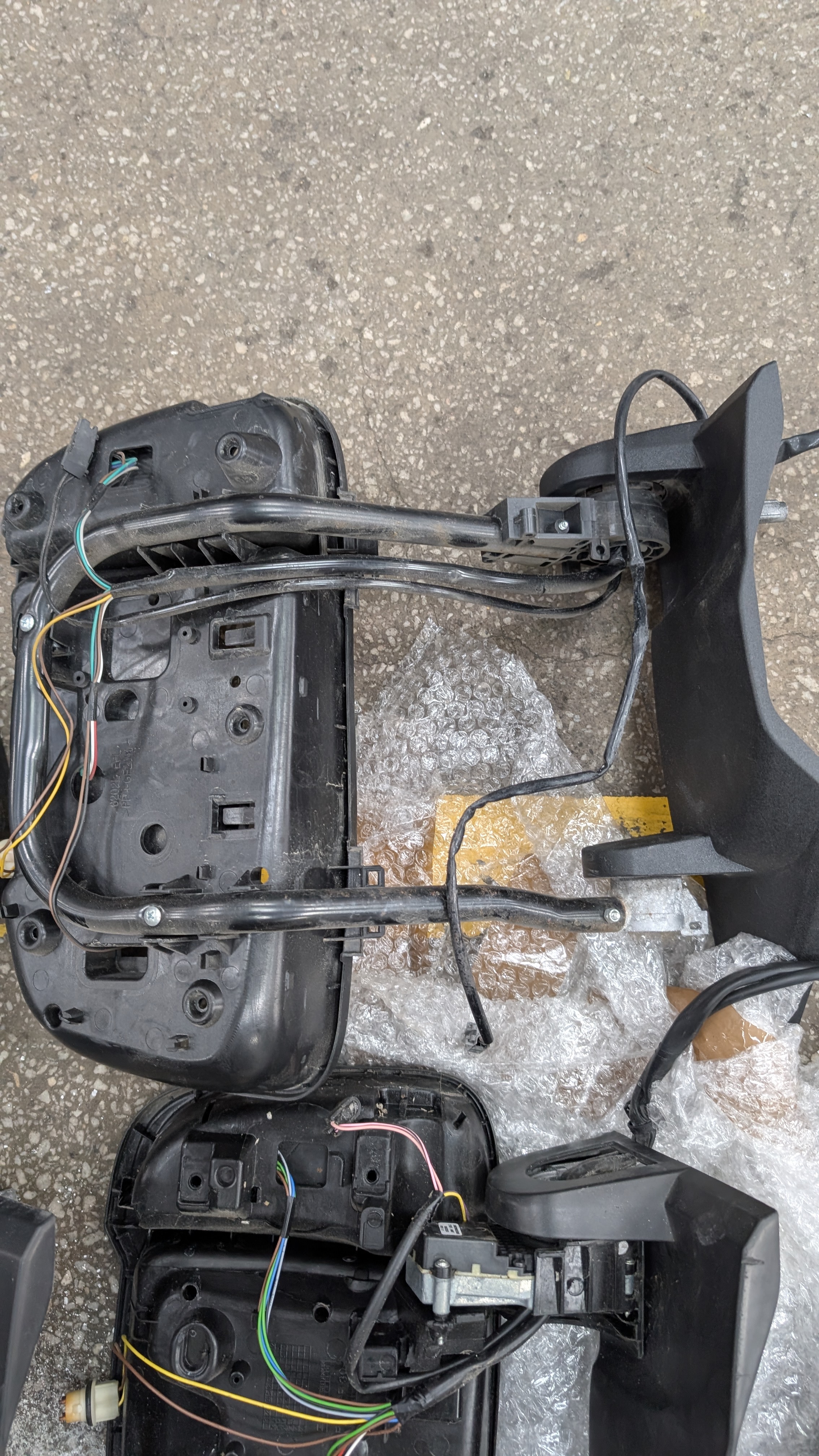

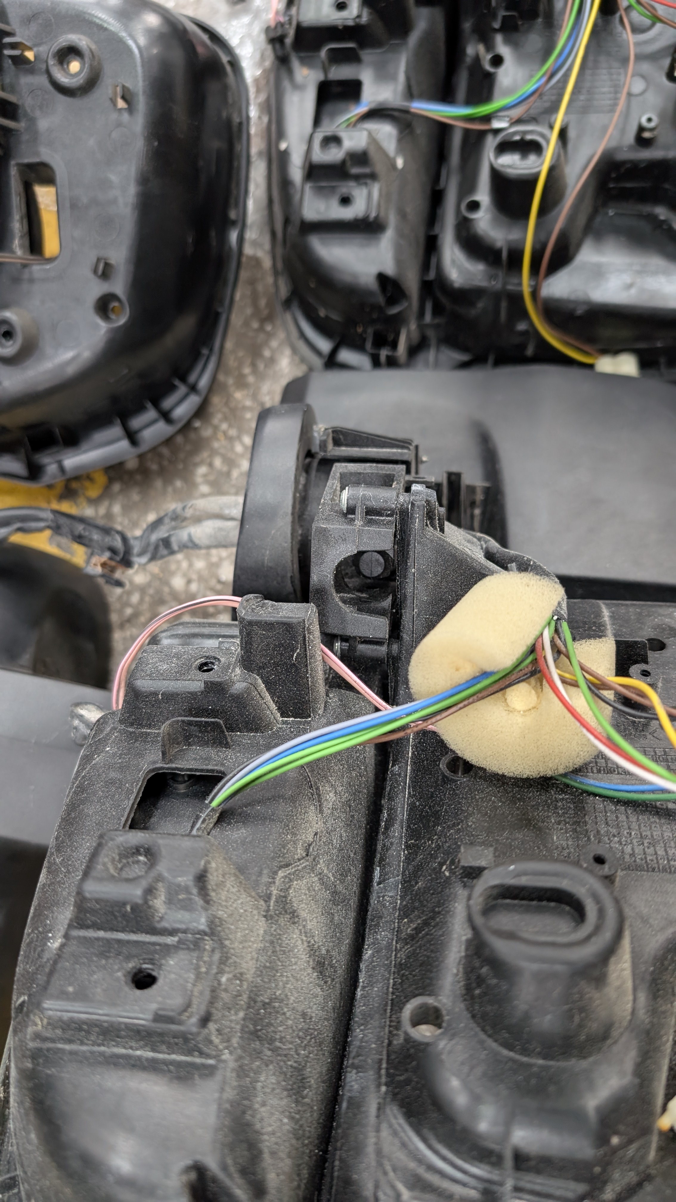

I have 3 driver mirror open. 1 long arm manual, 1 short arm power folding, 1 short arm with blind spot. Look like power folding motor don't support long arm bracket. I'll study more and brb

The upgrade is not impossible. I'll have to weld a bracket to the motor cover. Also very interesting will be to extract the compressed washer. I need to suit a compression tool.
