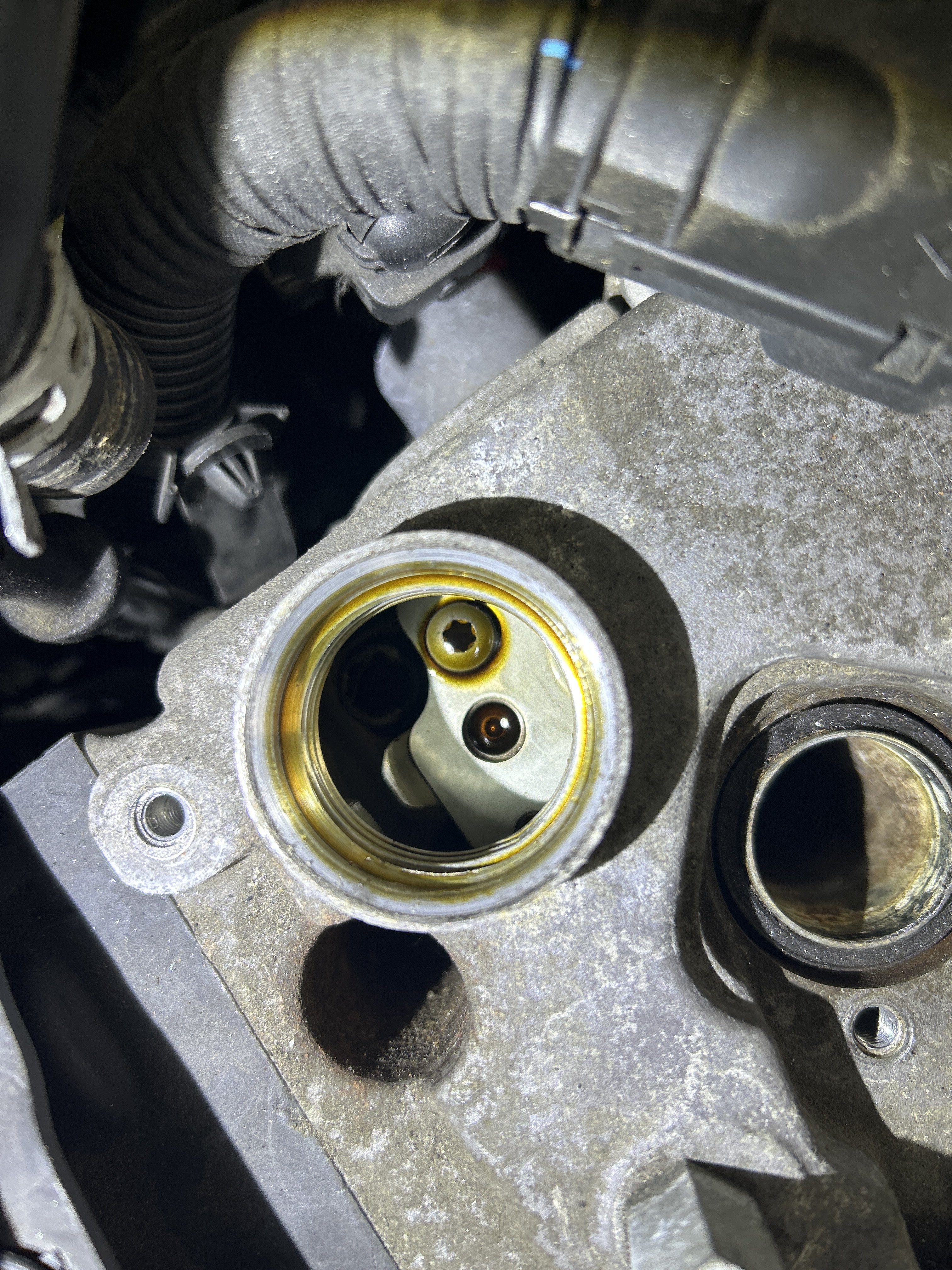

Can you remove oil filler cap and shine a light down the orifice when cranking and say what you see,

Just tested the compression on all four cylinders and it seems you’re correct, ZERO compression on all. So, does that indicate a faulty gasket or is it a timing chain failure like some others believe?
I’ll be doing that when I get home from work
