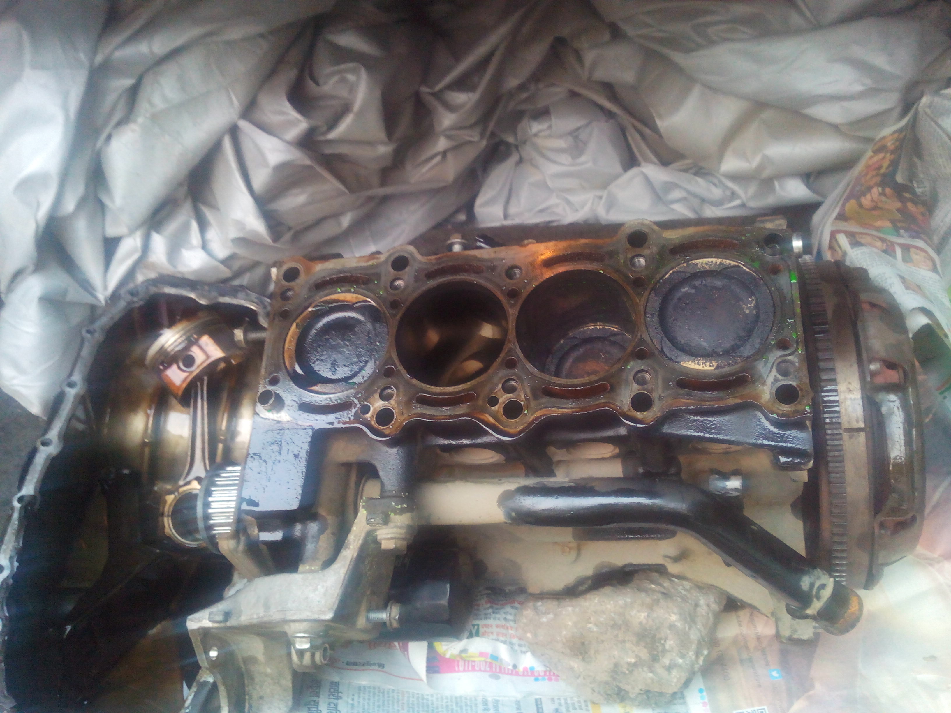

Hi Thanks for reply
At worksop they opened the engine and found as per below picture.lot of carbon is stored on piston,ther are sugessting to replace the pistons.
Regards
