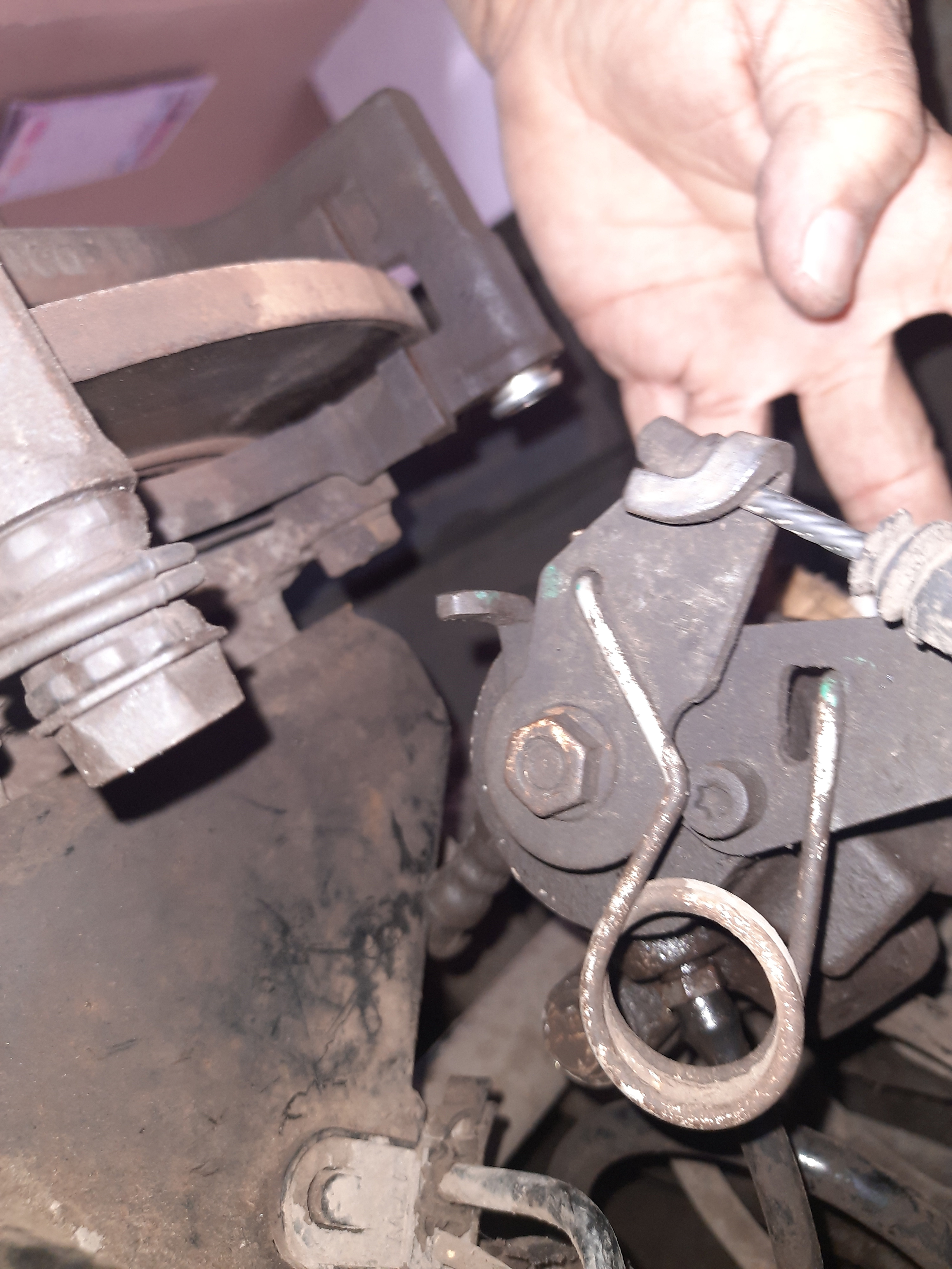

Dear Friends,
My car is Fiat Linea T-Jet 1.4 (petrol), Emotion, 2014 F/L Model India.
It has all the four Disk-brakes. To replace the rear brake pads, I opened the right side (right hand drive) rear wheel brake-caliper. removed the old pads, cleaned all around the caliper and pad-holder. To insert the new pads, more space is required and for the the brake caliper cylinder is to be pushed in.
I tried to wind it clockwise as well as anticlockwise. Also allowed the fluid to bleed from the nipple. Also kept the reservoir (in engine room) open/loosely closed. The had brake was not engaged. With all these variation, Despite efforts of more then an hour or so, I could not be able to push the cylinder in even a little-bit! I am attaching some pics of this.
I think, I am missing something in the process and so I am following some wrong procedure.
Could you please guide me how to push this caliper cylinder IN ?
Does it requires detaching the hand-brake cable?
Should I insert the ignition key in? On which mark should I keep it? (I think, the engine is not required to start).
A prompt and positive response is eagerly awaited. Please help me.

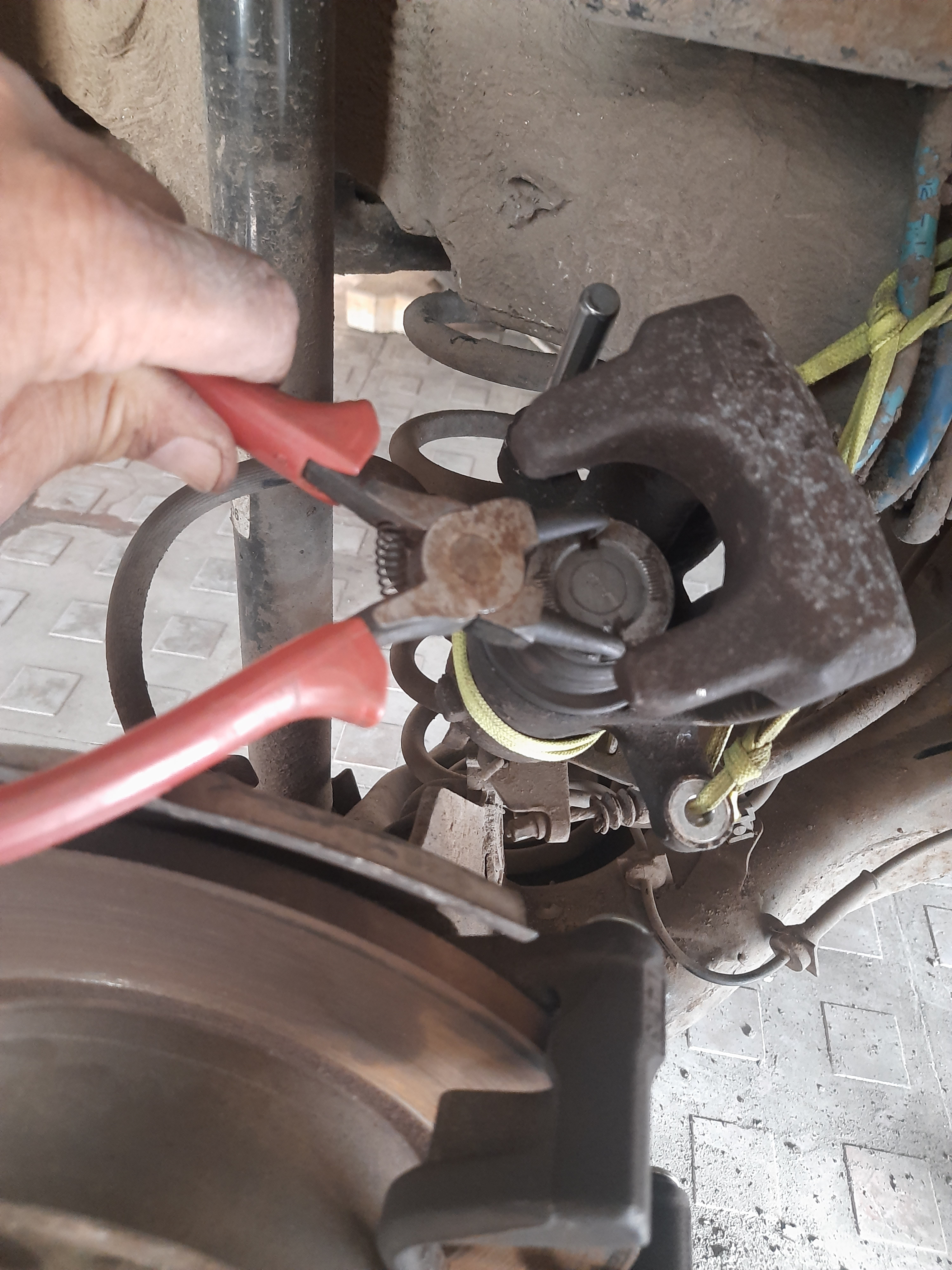

It could just be the fact that you are trying to retract the piston using circlip pliers rather than a proper brake rewind tool, rear calipers can be stubborn to get started even with the correct tool. If it’s starting to seize you’ll be doing well to get it to budge with the current tools you’re using
Sir,
Thanks for the prompt reply.
I tried with other ways also which exerts pushing pressure using nose plyer and other way as shown in the attached pictures.
But even a fraction of mm could not be pushed.
Remove the cover of the handbrake.
Loosen the handbrake lever cable adjustement nut a bit.
Disconnect the handbrake cable from the brake caliper.
It should be sufficient to only remove the brake caliper lower fixing bolt in order to turn and secure the caliper.
I don't think you need to open the brake fluid reservoir for this.
Fiat has a special tool for retracting the rear disk brake caliper cylinders, however if you can put something in the holes and turn it, this should do it.
What for? Keep the ignition key in your pocket, please.
Sir,
Thanks for the reply.
From the video, it seems that the piston should wound up very easily by a nose plier or similar some device. It is not happening in my case. May be the press force by hand insufficient! - I think so . So. I have placed an order for "Universal Brake Caliper Piston Rewind Kit" which is likely to receive on Monday. - Shell try with it and let you know the out come.
I have also observed that pressing and releasing the ratchet brackets, the piston moves outward. But somehow, it is not going back by turning it clockwise by a nose plier as narrated above.
Still I have kept the handbrake cable at its position and not removed from the pulling-back bracket mounted on the caliper.
I am attaching some photos for your ready reference and information.

Iˋm not a mechanic. But at this point, I suggest three approaches:
1. With the handbrake cable still connected, refit the caliber without the brake pads. Have a friend pull the handbrake all the way (without using excessive force) once while you observe if the jack screw mecanism pushes the piston out. This might actually help it break free and will push the piston out one step. However, there is always a risk that using force might break the jack screw mecanism if the piston is seized because it has corroded.
If the procedure is successfull, it might be easier to rotate the piston back in afterwards.
2. Remove the caliber entirely from the car and push the piston out manually like in the video, using the jack screw mecanism. This is a more carefull approach. Maybe it won’t push out, if it has seized. If it does, rotate the piston back in.
3. Wait for your piston rewind tool to arrive.
If nothing works, you likely need to either rebuild the caliper (if aftermarket rebuild parts are still available), or get a fitting new (or used) caliper. Maybe from a junkyard or specialized dealers.
In my opinion the cylinder is seized. Probably was left for too long with the hand brake on, or the mechanism is somehow locked, could also be the handbrake wire that is seized.
Brakes are vital for driving security, if such thing happened on one caliper, it seems all of them need cleaning (also under the rubber protection, but the pistons cannot be fully taken out from the calipers), lubrication (with a lube that does not damage rubber, there are specialized products). The DOT4 fluid used in braking systems is highly higroscopic, requires to be changed on a regular basis (2 to maximum 4 years) to maintain its properties and assure proper braking. The fluid has to be pushed out of all the brake lines until the rear end. In cars equipped with ABS the process is a little bit more complicated.
There are surely some videos on youtube showing the operations. I'd also stick to the workshop manual for the appropriate model to make it the proper way.

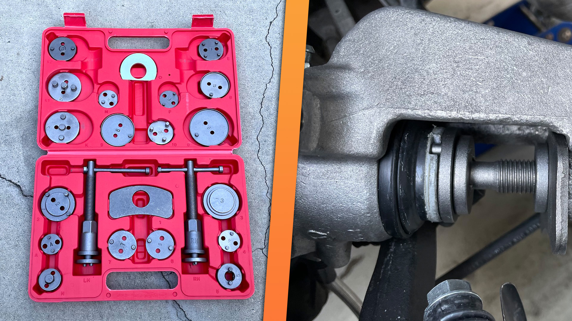

Friends,
Thanks to you all for the prompt and valuable guidance point to point regarding my difficulties in the process of replacing rear brake pads on DIY basis. I would have not been able to succeed the captioned job. I am updating the matter as under:
1. I could procure the "Universal Brake Caliper Piston Rewind Kit" as mentioned in #5. It is a right side screw (i.e. it pushes the piston upon clockwise turning).
2. I could be able to push the piston with the help of this tool easily and replaced the brake pads on the rear right side wheel. The fluid nipple was used to bleed the brake oil while pressing. Again the air was also removed by pumping through brake pedal pressing-releasing repeatedly. Did proper lubrication also. Checked hand brake and pedal brake effect on wheel in stationary condition and then took a little round in the car. As of now it seems ok.

Looks like it is only one type of screw with only one plate.
It's not the same tool as for my car (which comes with two plates and two screws) so what I said above does not apply to you!
I guess your tool will actually work on both sides on the Idea (clockwise turn).
You will need two tools a left and a rihght hand thread. One isde will windin antic lockwise You can use pliers but it will be very difficult as back pressure is also requjired and without a tool you will likely hurnt yourself. Suitable tools are cheap and freely available on eBay. Universal tools like the one you (and I have will only do one side. These are also a poor fit on the Fiat calipers. I bought a full kit a few years back for about 20 euro. Worth every penny. If thenpiston reaches the end of its ravel due to worn disc and pads it can require a bit of a shock to start it off backwards. Do not over wind it out wards or you will have trouble if it pops over the end of the thread internally its hard to get these to go back. Go slow and watch that the piston is going in and not out when you wind the tool. If its going out STOP and get a lefthand thread tool!!!
I'm afraid that driving with a good brake on one side and a poor one on the other side can very easily lead to a spin on a slippery road.
