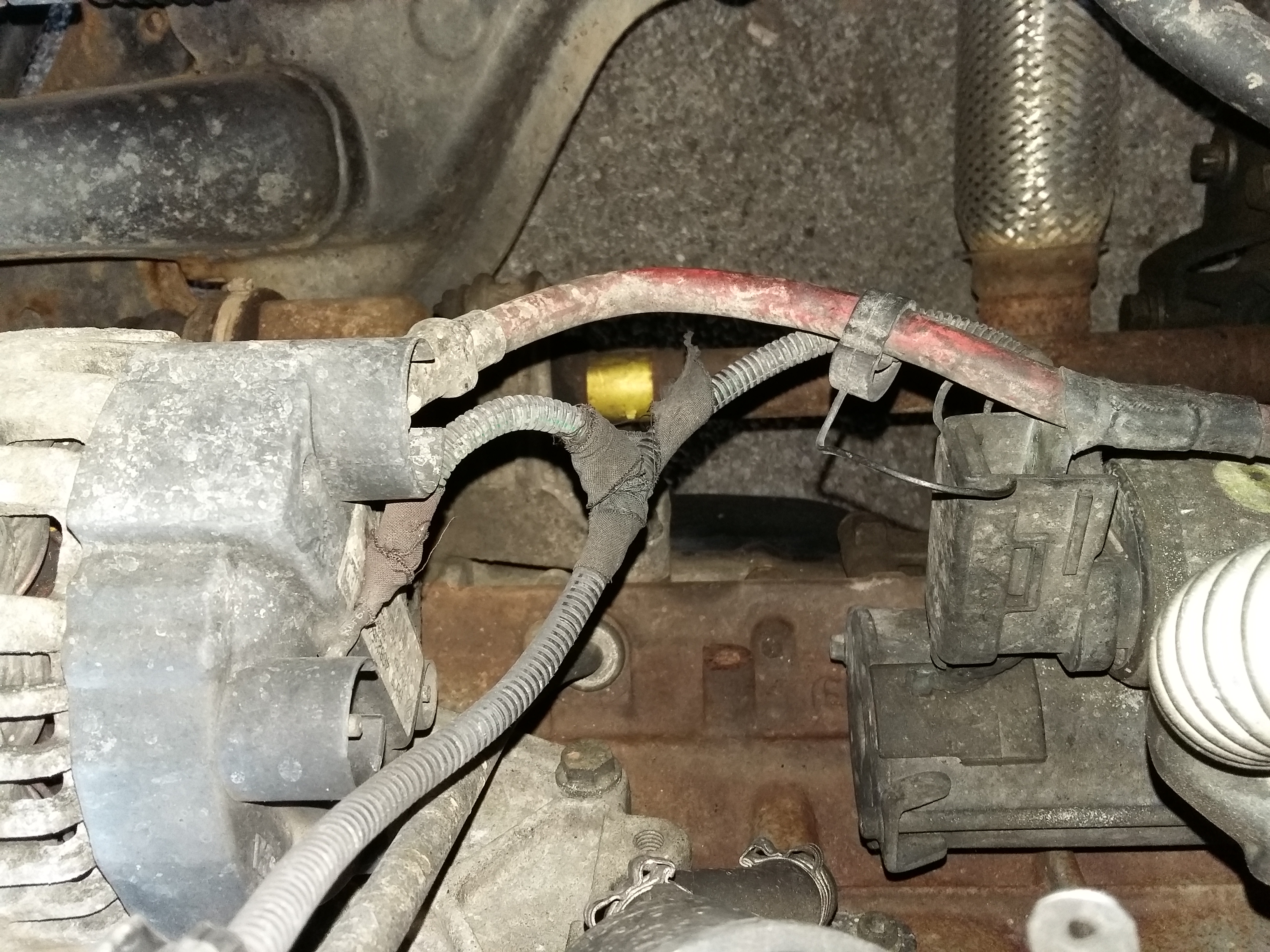

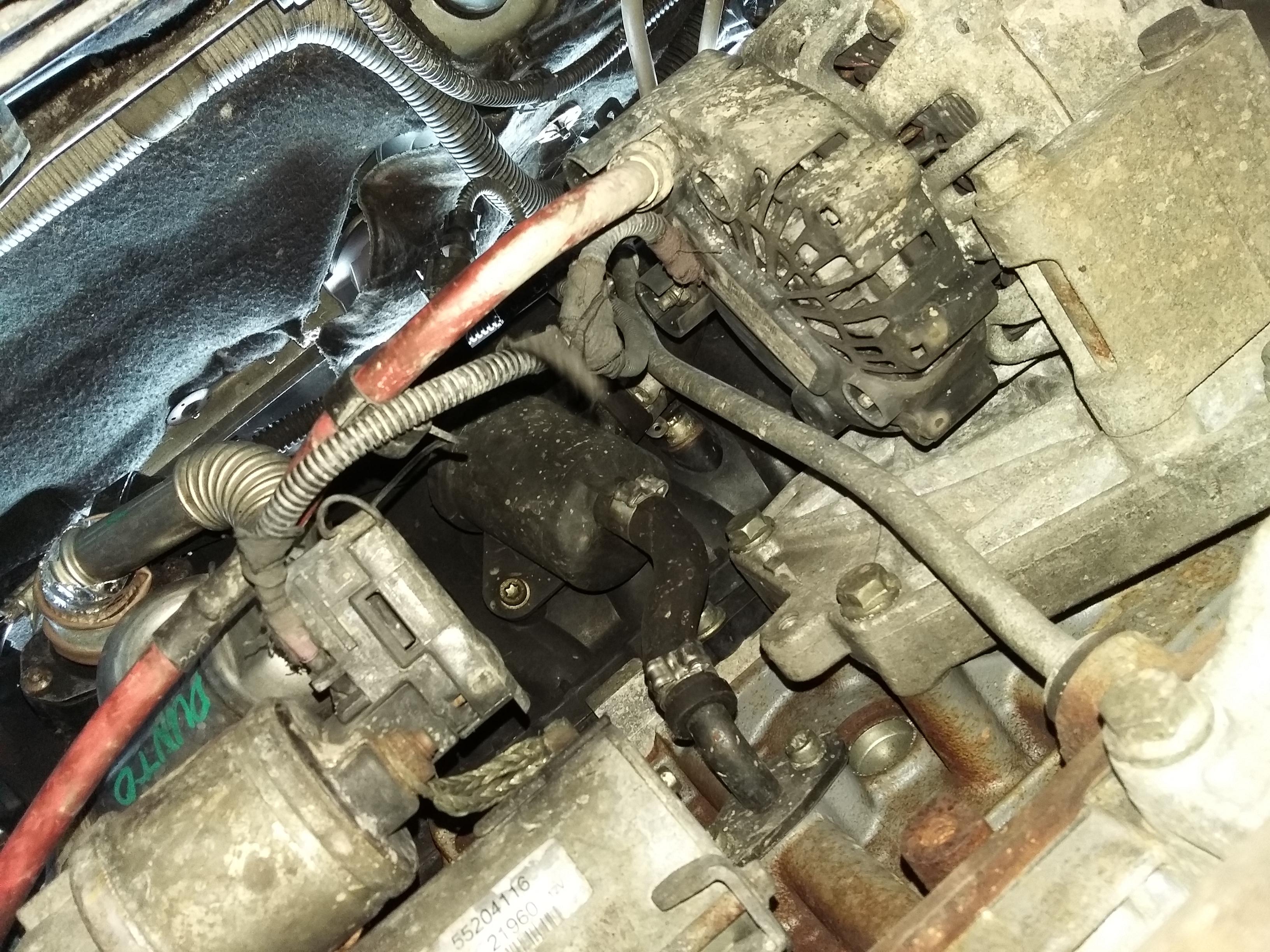

Hi :)
My 1248 multijet did similar
Perfect Cold.. once warm it either clicked..or crawled over
In time (months..) it didnt crawl over at all.. it just clicked :eek:
Thinking it was the Classic.. the Ground Cable corroding internally..
I tried a booster cable from battery negative to chassis and engine.. ZERO improvement
So ..while the car was in the air..
I looked at the starter... the nut on the Solenoid was really 'crusty' with corrosion
So I disconnected the battery power.. and
Using a 13mm spanner I undid the nut 1 turn.. wriggled the 'braided' copper cable
(Solenoid to Starter body)
And retightened the nut
100% success ...!!
Starts immediately at every attempt
Top pic shows braided cable and the Crusty nut :)
