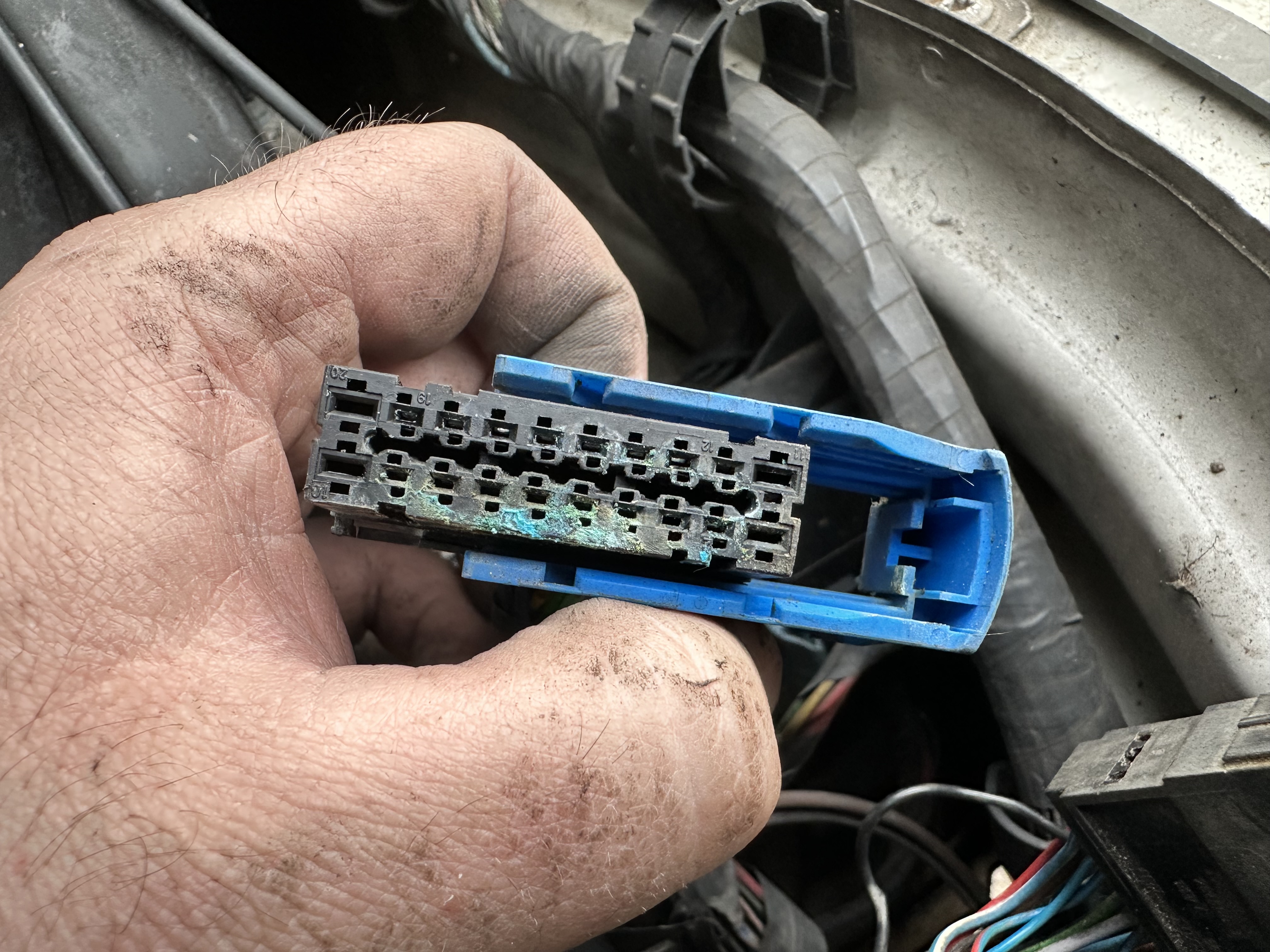

The symptoms you’ve mentioned sound very similar to the issues I was having with my van.
There is a small hole on the passenger side on the tray at the bottom of the windscreen allowing water to drip onto the wires below. Wires that I traced to the throttle body and the EGR solenoid.
F11 fuse had blown which controls “secondary systems” which I’m sure you’re aware, includes the throttle and so on…
Under the fuse box was a black and blue plug socket and when I opened it up it was literally green inside with corrosion. The drip was landing on the wires and dribbling into the connection. I cleaned it up and the engine revved up to 4k rpm no issues.
Put it back together and touch wood, it hasn’t returned.

Ok thanks. I will check this tomorrow if i get time. Where you getting fault codes? I am showing no fault codes so making this a pain to diagnose.
